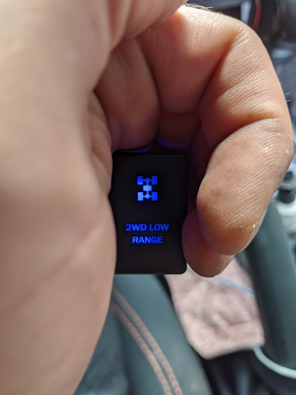

    Received mine a few days ago - thanks for being so damn quick!
    I got it installed with minimal effort, really - removing the glove box kinda sucked lol i hate those interior trim clips in all shapes and sizes!
    Here's the switch i got.... It looks to me like half of the LED's are burned out - anyone disagree?
    Qp-KfAaHIkw9xCfBICi_fPcBM6gY4KBRW3ost5vj_4d4cb5dc9daf052c02b576468271e8c6d59ba7e0.jpg
    I might try and send it back and swap it for the proper ISO symbol too lol
    I also want to throw this scenario out and make sure it fits the use case. I have a MT and sometimes i need to do some wiggling around at camp to get in the right spot, but i end up all over the clutch and getting things hot. Using this, i can get into 2lo and retain my steering for the most part while getting that low gearing quick engagement from the clutch?
    Karminski and CygnusX191 like this.
  12. Aug 18, 2020 at 5:39 AM
    #1132
    doublethebass
    doublethebass aspiring well-known member
    Jan 1, 2017
    #206252
    3,445
    Antoin
    Minneapolis MN
    ’17 6MT Pro
    Yep, that’s exactly what it’s for
  13. Aug 18, 2020 at 5:39 AM
    #1133
    tonered
    tonered bartheloni
    Sep 25, 2017
    #231055
    31,231
    tony
    Lynnwood, WA
    That switch lighting looks typical for a/m switches.
    Yes. That is the entire point of the 2LM. 1mph creeping at full lock if needed.
  14. Aug 18, 2020 at 5:40 AM
    #1134
    b3itz
    b3itz Camp Life
    Mar 6, 2019
    #285589
    932
    Northern KY
    2016 MT OR DCSB
    Tuned, geared, armored, BP51s...
    Thanks dude
    a/m? :)
    Boo - i think it looks broken! hahaha. That's kind of a bummer. I also don't like the blue at all. I'm so hard to please :annoyed:
    CygnusX191 likes this.
  15. Aug 18, 2020 at 6:11 AM
    #1135
    SearArtist
    SearArtist GX poor
    Jan 5, 2016
    #174151
    18,973
    NC
    GX470 & GX460
    Things
    send it back and get a properly colored switch...
    looks like they are sold out at the moment, but keep an eye out here:
    https://www.aironboard.com/online/products/switches/toyota-push-switches.html?color=288&limit=80&p=1
    they restock about every 2-3 weeks.
    CygnusX191 and b3itz[QUOTED] like this.

  17. Aug 18, 2020 at 7:11 AM
    #1137
    tonered
    tonered bartheloni
    Sep 25, 2017
    #231055
    31,231
    tony
    Lynnwood, WA
    You're welcome!
    Aftermarket.
    I have the AoB matching blue and it doesn't have perfect OE lighting. :notsure:
    Given the location in the LSP, it is hardly noticeable.
  18. Aug 18, 2020 at 7:32 AM
    #1138
    Pablo8
    Pablo8 Here!
    Aug 7, 2019
    #301483
    9,840
    Paul
    Everson WA
    2019 Cement Sport 4X4 MT AC
    OVT, 4.88, ADM, F&R ARB lock, KO2's, RWD L MOD
    I just went RED because I figure contrast rather than a cheesy attempt to match.
    BS I didn't even think about color, and red doesn't bug me at all. :D
    CygnusX191, b3itz and tonered like this.
