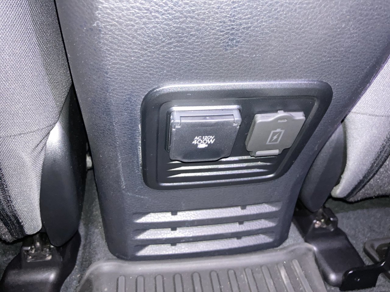

    2. In progress on 400w anytime mod. Taking my sweet time with the center console cutting. I made a template, stuck it on the back of the console piece with blue tape, and I'm water for a moment of clarity to start the cut.
    3. Ordered a literal s-ton of parts for switchpros setup in the engine bay as I await the arrival of MESO driver's cubby. Don't even own the 9100 yet. But I've got parts from powertrays, and ordered stuff from sdhq and also Pelfreybilt. I for sure have no idea at all what I'm doing with this but it's fun to buy stuff and if I burn a few $$'s unnecessarily, so be it. Pretty sure I could give it away to someone I like on this forum if I hate it.

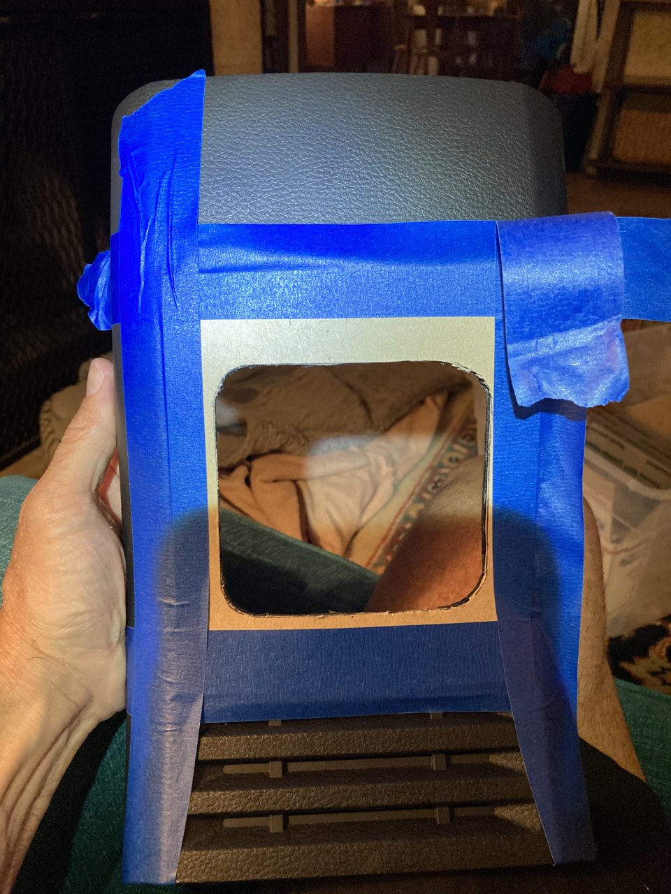

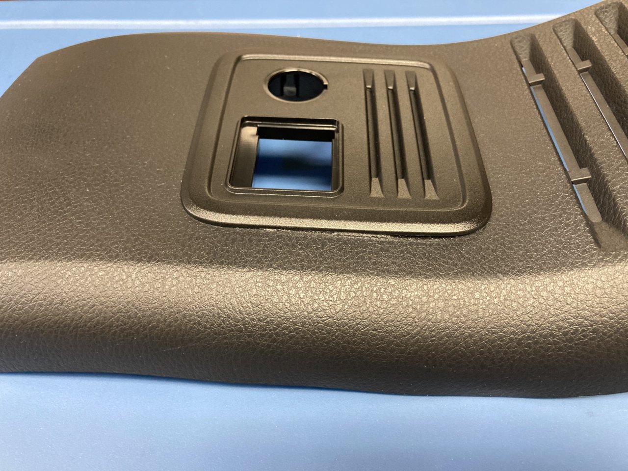

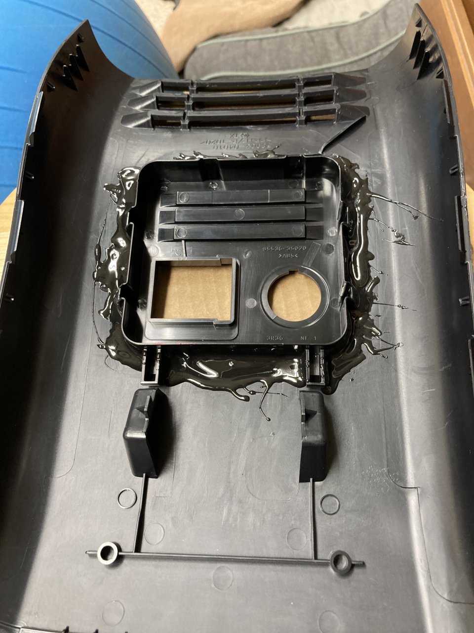

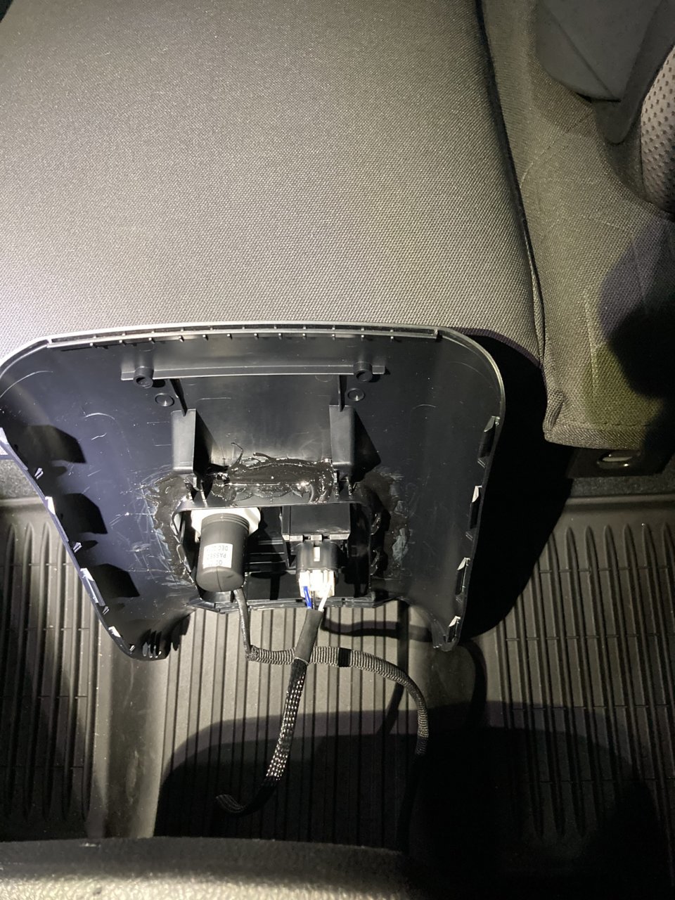

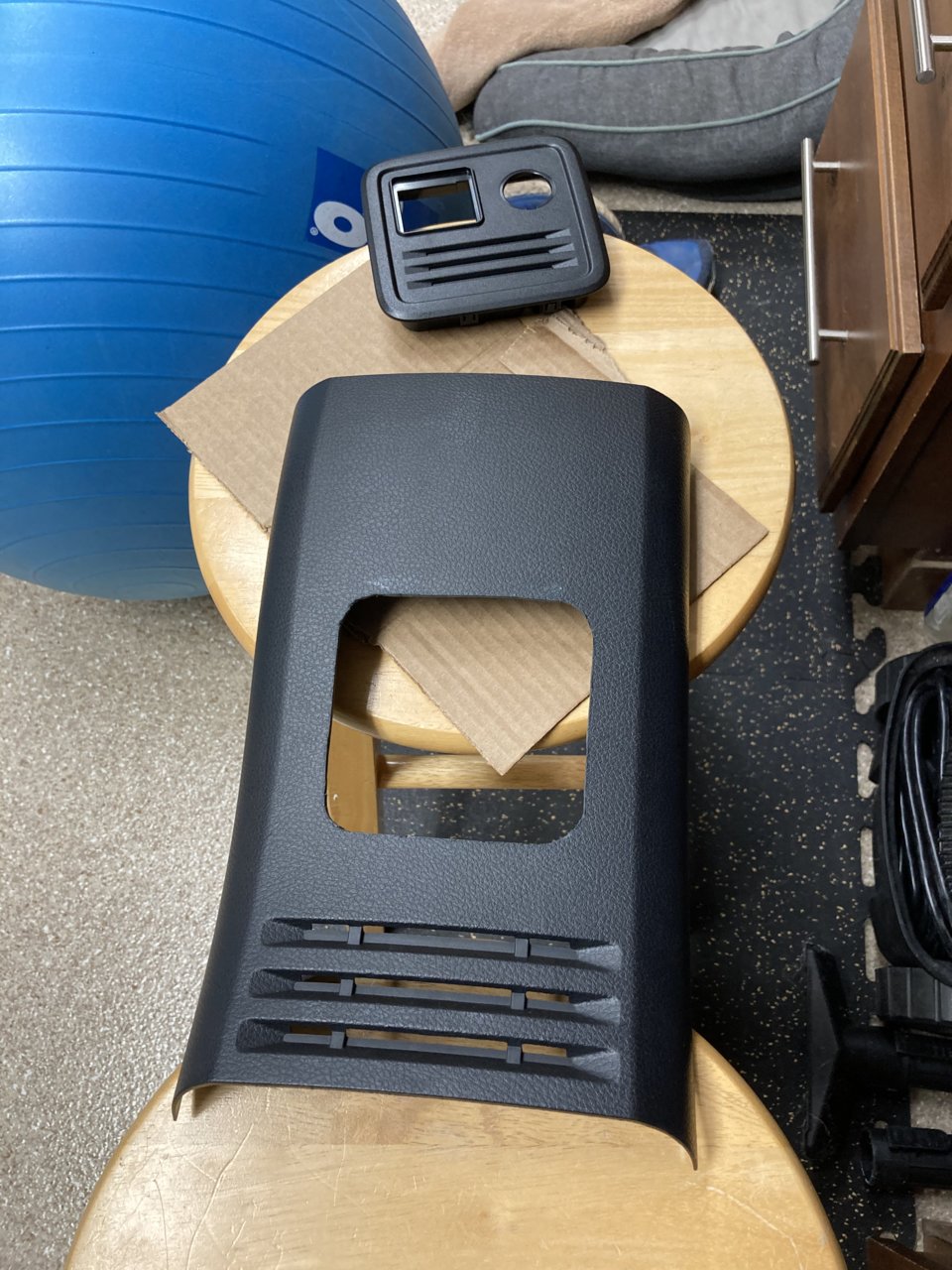

    Progressed further with the center console last night during some indoor mod time. Waiting for the JB to fully cure and arrival of the USB plug before I re-assemble everything. I may run an extra power lead under the center console for future seat heaters while I've got things open, but I also want to rattle-can my cupholder trim ring before I re-install the cupholder trim piece so I'm taking my sweet time on closing it all back up.
    EDIT: It was my first time using JB on plastic and my first cut in the truck. And I don't have the best fine motor skills. There's a bit of a gap on left and right sides where the trim panel curves. I also had seepage of JB on one side and didn't hop on cleaning it up fast enough, seen in the last photo. And I think I'm a mm or two lower than I needed to be to clear the plastic bits which connect to the console cupholders so that was another imperfection. So, quite a bit of room for improvement on this, but I didn't see a better alternative than the brute force mod and I guess I need to get my skills up on this stuff if I'm going to attempt lower or overhead switch panels.

    Nice, how about a rear view of the bezel on the console panel?

    I snapped the back of the console back on tonight. Apparently I do not have any small blade crimp on connectors. So I cut a spade lug and shoved it into the OEM 12v connector for power for now. At least the 120v stuff is all clean and tidy.

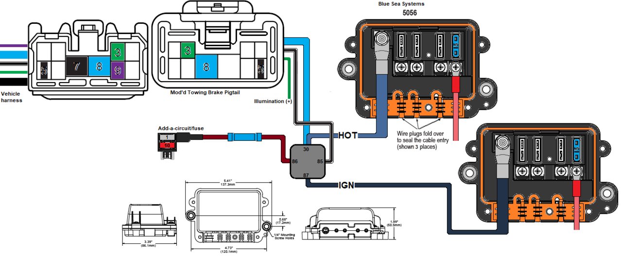

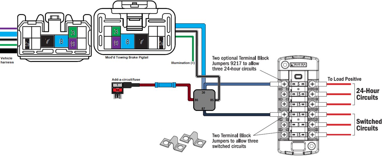

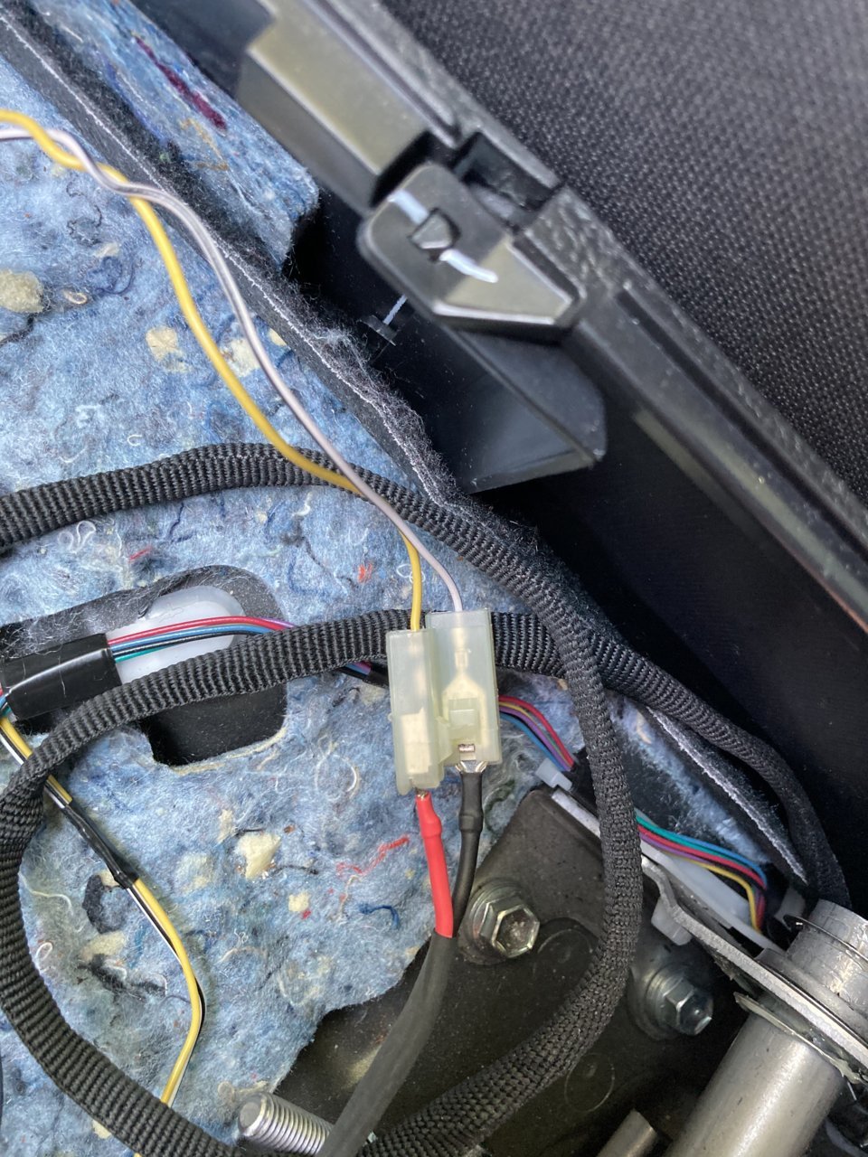

    @caribe makaira might you know of a campanion male plug for 10760? I’m guessing no since it’s meant to snap onto the socket directly but maybe you have some smart ideas?
    Looking for a secure way to attach to the USB plug which won’t jiggle loose and can quickly revert back to the socket. I’m guessing I’ll just use harness tape or maybe it’ll fit well if I have two of these connected assuming I can shove the male spades in back to back. It's a bit loose right now, slight tug and the spade lugs slip out.

    No I do not...Maybe remove them from the connector and use heat shrink. No harm to terminals for a return to OEM later.

    I played around with them last night. Your suggestion is the best option as expected. I’m also considering a new wire from the fuse box. Is the best option to do an add a fuse? Or is that guy removable and is it possible to access the pins? Looks like I have one empty fuse.

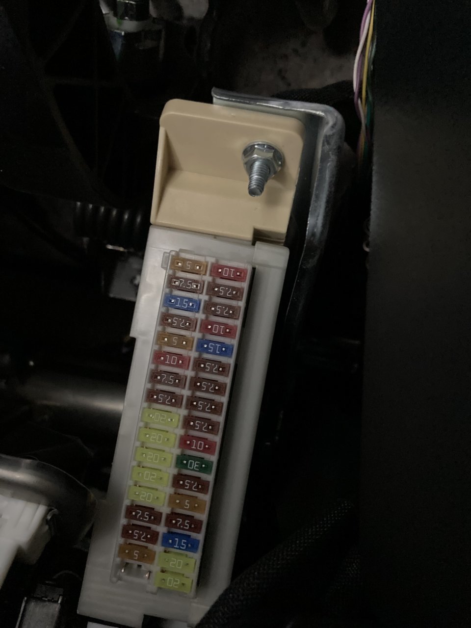

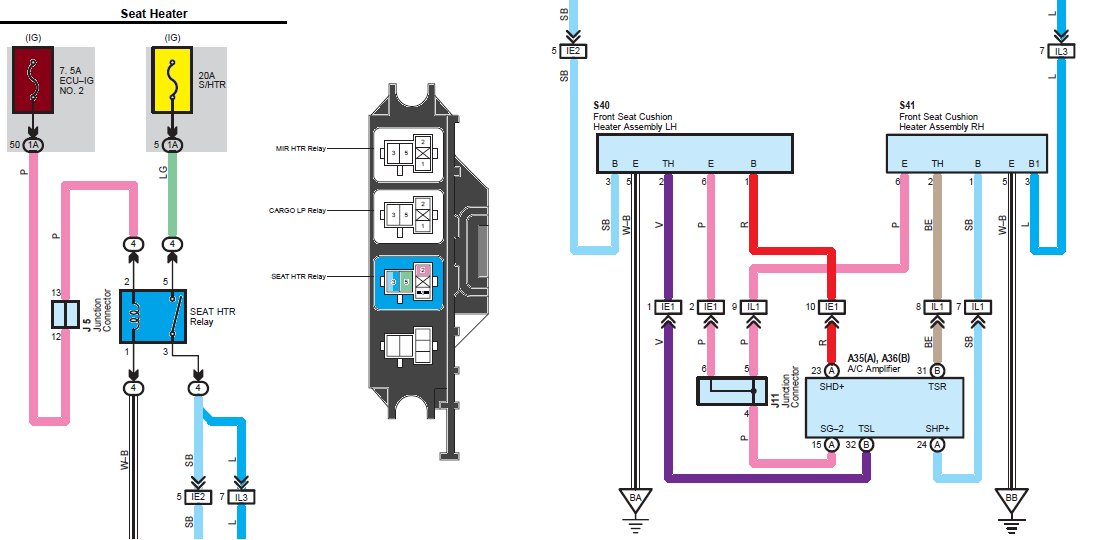

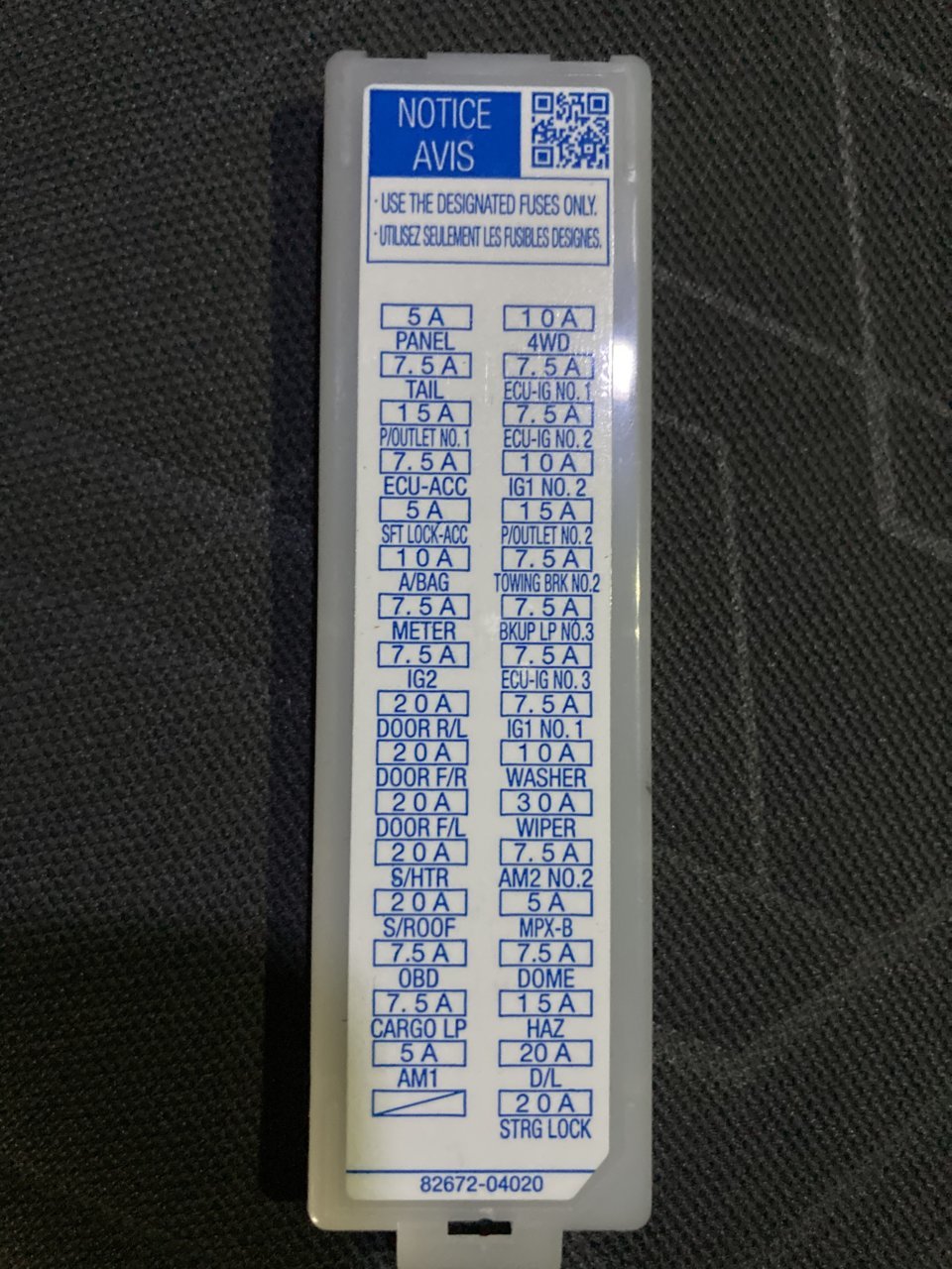

    I’m also curious if the seat heater circuit is accessible somewhere? I don’t have OEM heaters but I did want to add some down the road.

    Verify that you have the pins in the relay position. You do have the fuse for the seat heater, but it might not be wired entirely.
    As for a adding a cab circuit, how about you repurpose the towing brake circuit? Unless you do use it. It's an always hot fuse (40A) and the harness to attach to it is like $15.00. You snip the connector that goes to the towing brake module and add a relay. Then branch out to a multi-fuse holder. The fuse holder can be divided with hot and switched circuits.

    Thanks for all this. I am thinking of using the brake harness for seat heaters if I can’t track down the factory seat heater relays when I get to that project. I greatly appreciate your guidance on that.
    For 12v power I’m still leaning towards add a fuse so that everything is compact. I’ll remove the Oem 7.5 amp fuse and leave the factory 12v plug disconnected then run 16 gauge from the add a fuse to my USB sockets and add a quick disconnect to the socket end. Revert would be quick, unplug the add a fuse, replace the Oem socket and connect it, replace the Oem fuse.
    If anything I think increasing wire gauge and decreasing max current draw should be safer than before. Only concern I have is if picking a new grounding point changes anything as I haven’t yet located where the ground is for the driver side fuse box.

    Sunday night I got the DRL grille light harness installed. I needed 2 conductor waterproof plugs which I used heat shrink solderless no crump dealios on. Then I taped up the T harness and the LED side inside loom and zip tied to the grille and tried to obscure behind the letters. Overall it seems nicer than add a fuse to INJ but functionally the only difference is that they can be turned off if desired and aren’t on when parking brake is engaged.

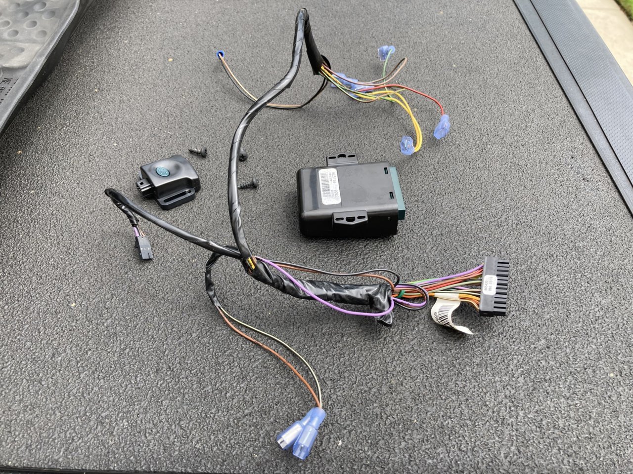

    Today I ripped out what I assume was a dealer installed alarm. I left the T taps. I didn’t see a starter kill relay nor any cut wires, just the taps. I will try my best to pretend to un-see that. It was falsing at night, perhaps due to heating / cooling cycles, not really sure.
    Next up are 3x usb power harnesses off the in cab fuse block using add-a-fuse for now. And finish the pioneer wiring harness. Cup holder surround has just a tiny fleck of chrome left, so it’s still in the bleach bath.
    While I was typing this up, look what arrived.

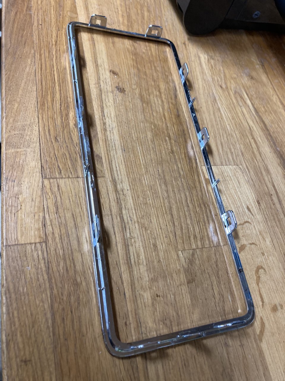

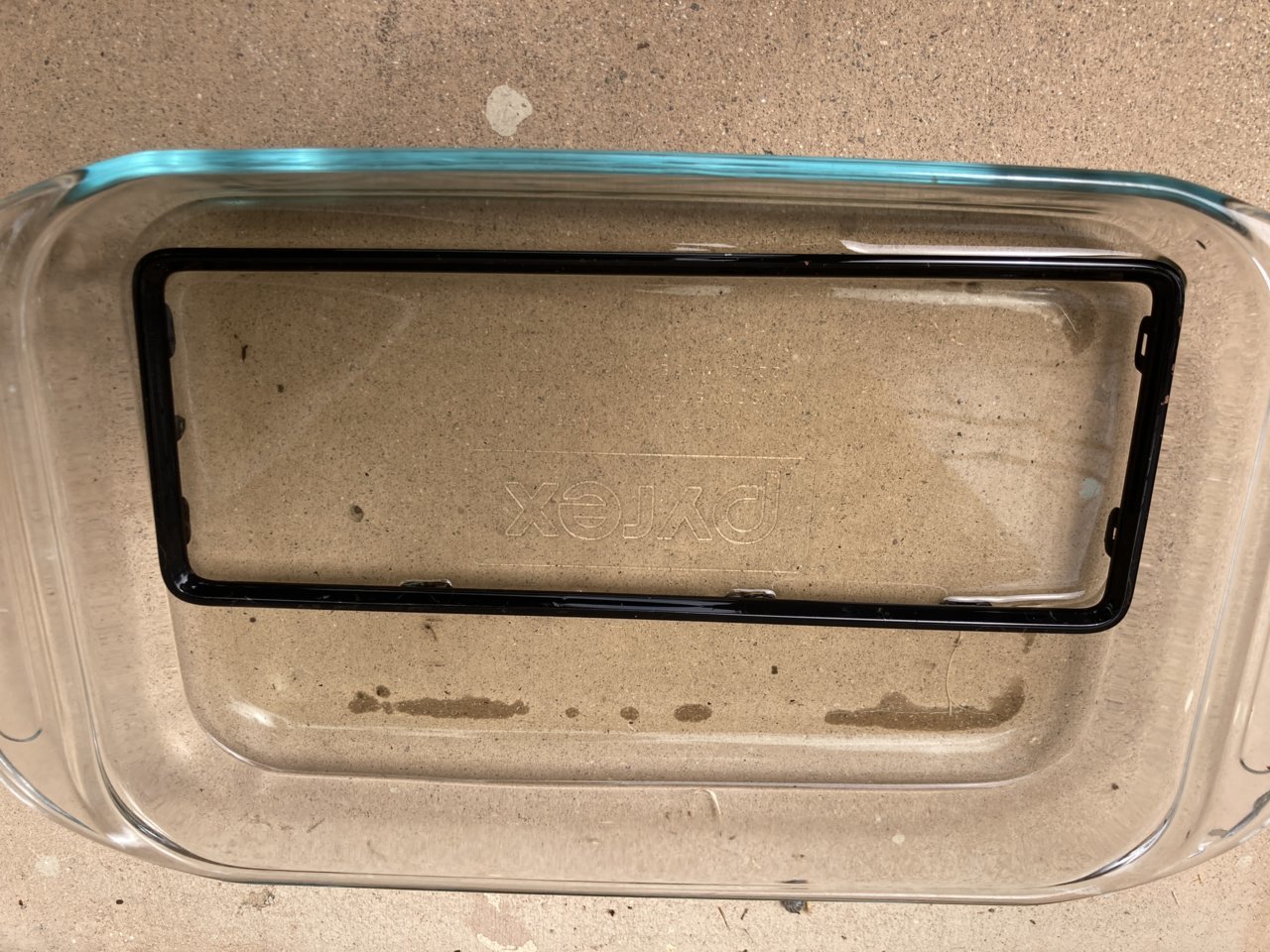

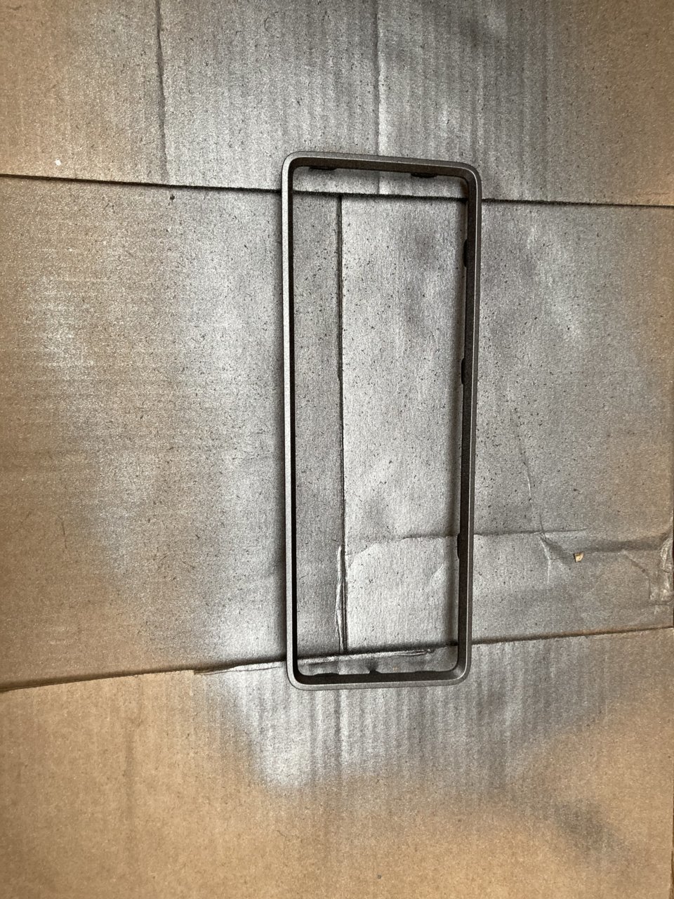

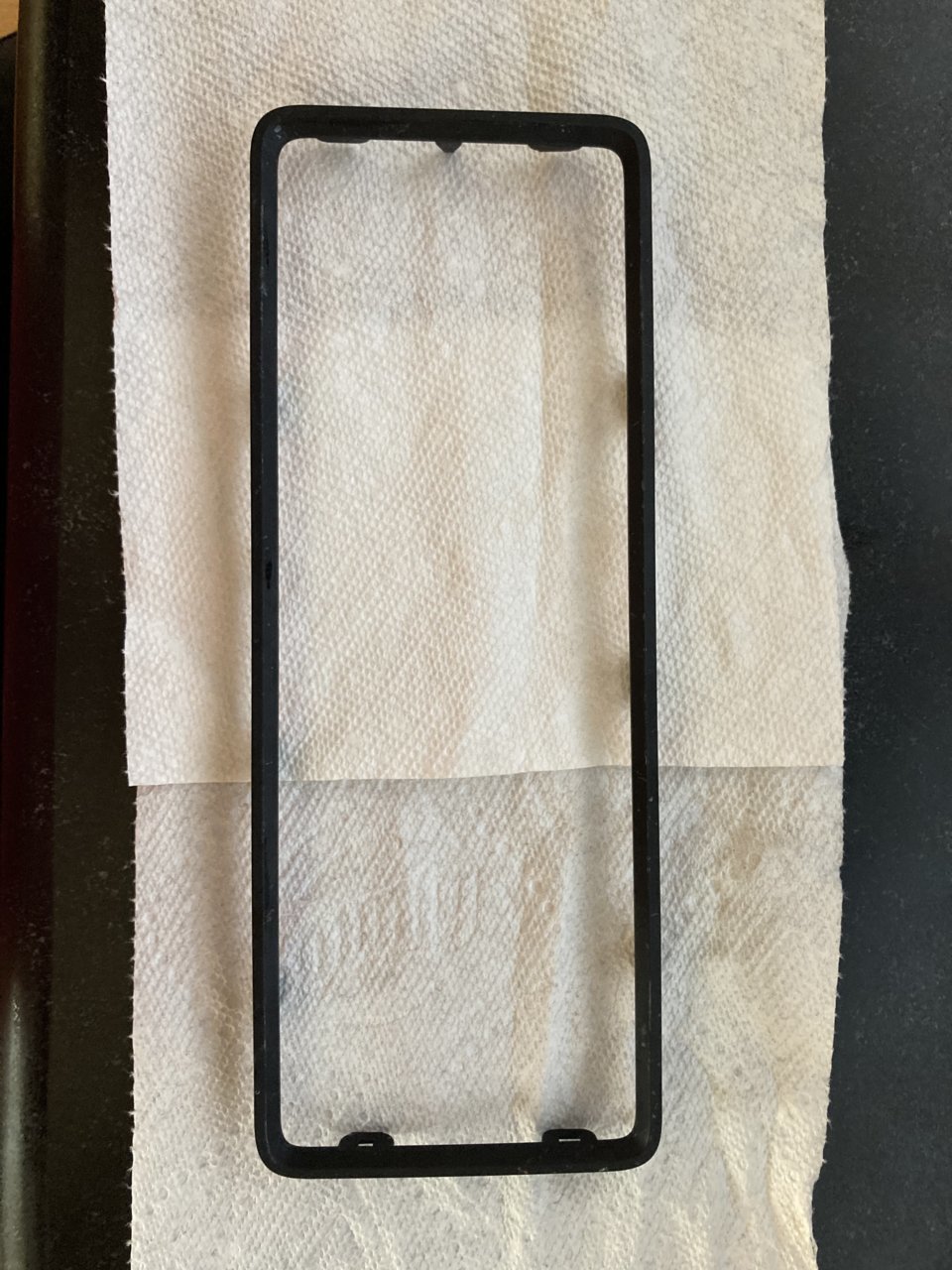

    Today wound up being cupholder trim day. I'm letting the topcoat cure and then I'll get one more final photo tomorrow of it installed. I think it came out great, though it was a long wait. I didn't really think the dechromed post-bleach-bath look was good enough so I wound up painting it after all. There were splotches of bronze/copper streaks and a few chrome bits went deeper than others so I scratched it up a little trying to scrub it clean while it was busy bleaching. Hopefully the bleach bath ensures the paint sticks really well, otherwise it was a giant waste of time and chemicals. I used an adhesive promoter, mgm duplicolor, and duplicolor topcoat.
    Here are the specific products I used for painting:

    Tested out the add a fuse plan tonight. The spare fuse slot is +12v rather than switched. The two poutlets are on opposite sides so they interfere with each other and that requires mounting one backwards to use both. I could just run all three USB’s off a single 15 amp 16 gauge tap. But I think I’m going to go the route of the trailer harness. I can use one add a fuse on poutlet for the relay input since I’m not using either (seriously no switched power in the trailer harness?) It’s a lot of extra parts though and I don’t know where I’m going to stash everything. Thinking maybe just all under the cup holders but the fuses won’t be terribly accessible there.
    I can’t think of anything I want constant hot for so I figure make the entire fuse block switched and it can serve usb and seat heaters when the time comes.

    Brakes gotta work "always"...
