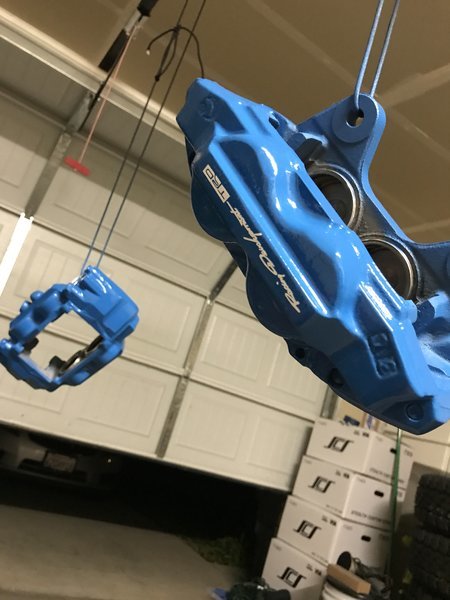

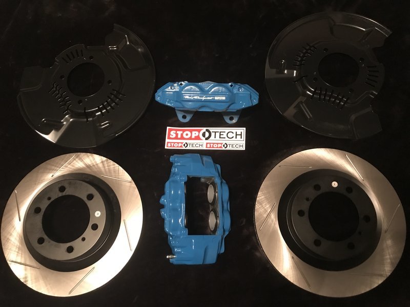

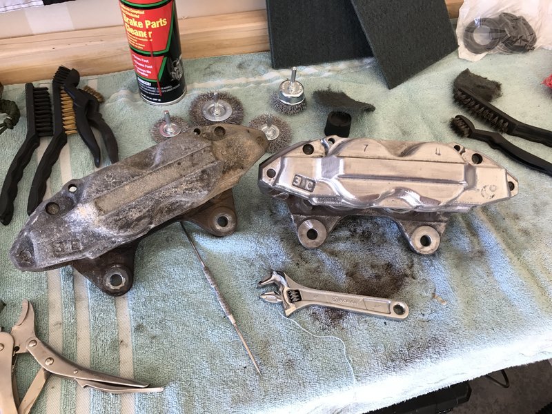

    Along with lots of elbow grease, brake cleaner, dremel sanding discs, sand paper, primer, color paint, clear coat and some small decals I cut out at work
    -Stop Tech Slotted rotors
    #126.44174SR
    #126.44174SL
    eBay for $98 each shipped
    RockAuto has these for a little cheaper shipped (I found out after the fact)
    -EBC Green stuff pads
    #DP61657
    eBay for $68.56 (AnythingAuto)
    -2014 4Runner Calipers
    #14WA
    eBay used for $100 (pretty lucky)
    -2014 4Runner Dust Shields
    #47781-60140
    #47782-60140
    @gunny1005 (Camelback Toyota) $89.93 shipped
    -Carlson Caliper Rebuild kit (2x)
    #15392
    eBay $19.92
    -Carlson Disc Brake Hardware kit
    #13600
    RockAuto $4.15
    -Carlson Bleeder (they were bent when I got them from eBay)
    #H9411
    RockAuto $0.59 (they only sell 5 at a time, so about $2.95)
