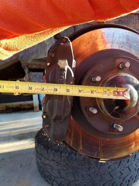

    Actually, can Someone that has these brakes do us a favor and take a measurement from the center of the wheel hub to the farthest spot on the calipers? And can people with the TRD Sport, SEMA, and Trail teams wheels take a measurement from the center of the backside of the wheel to the shortest point on the inside? That will tell us for sure if things will clear

    From @Bsheriff11 build thread.

    @Gaunt596
    Make sure to keep in mind, the furthest points from the hub are the corners of the caliper. Not to where it is being measured in the picture. It looks like 7.5in instead of just under 7

    Yeah. Looks like it's 7.5 or a smidge over. So, now for wheel measurements. You need to rotate those tires people!
