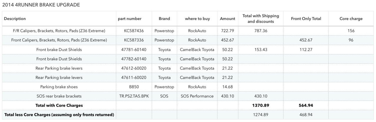

    So, I did a price analysis (5/30, technically 5/31 at 2am) with PowerStop Caliper/Rotor/Pad kits from Rock Auto. The Calipers and Brackets that come with the kit are supposedly powder coated red. This encompasses both front and rear upgrades to the 2014 4Runner brakes with the SOS Performance rear disc bracket kit (made for 2010+ 4Runner rear brake setup). I "THINK" this is everything needed to do front and rear. This was purely what i thought was needed for the upgrade. I would still do your own research before purchasing parts.
    The SOS price uses the 15% off coupon (taco-15) with the StopTech SS brake line option. RockAuto reflects the 5% coupon. Camelback Toyota reflects the 3% coupon (TWPartz). All shipping is to me at 89011.
    Another thing to note, the core charges on the Powerstop brake kits. Since we don't have the proper cores, I assume no one will be trying to pass their stock taco front calipers in as a suitable core (i mathed it for giggles).
    I'll be doing just the Front upgrade in the next month or so. Cant swing both at the moment, but at least this gives you an idea of what you could expect to pay; and a proper list of what you would need.

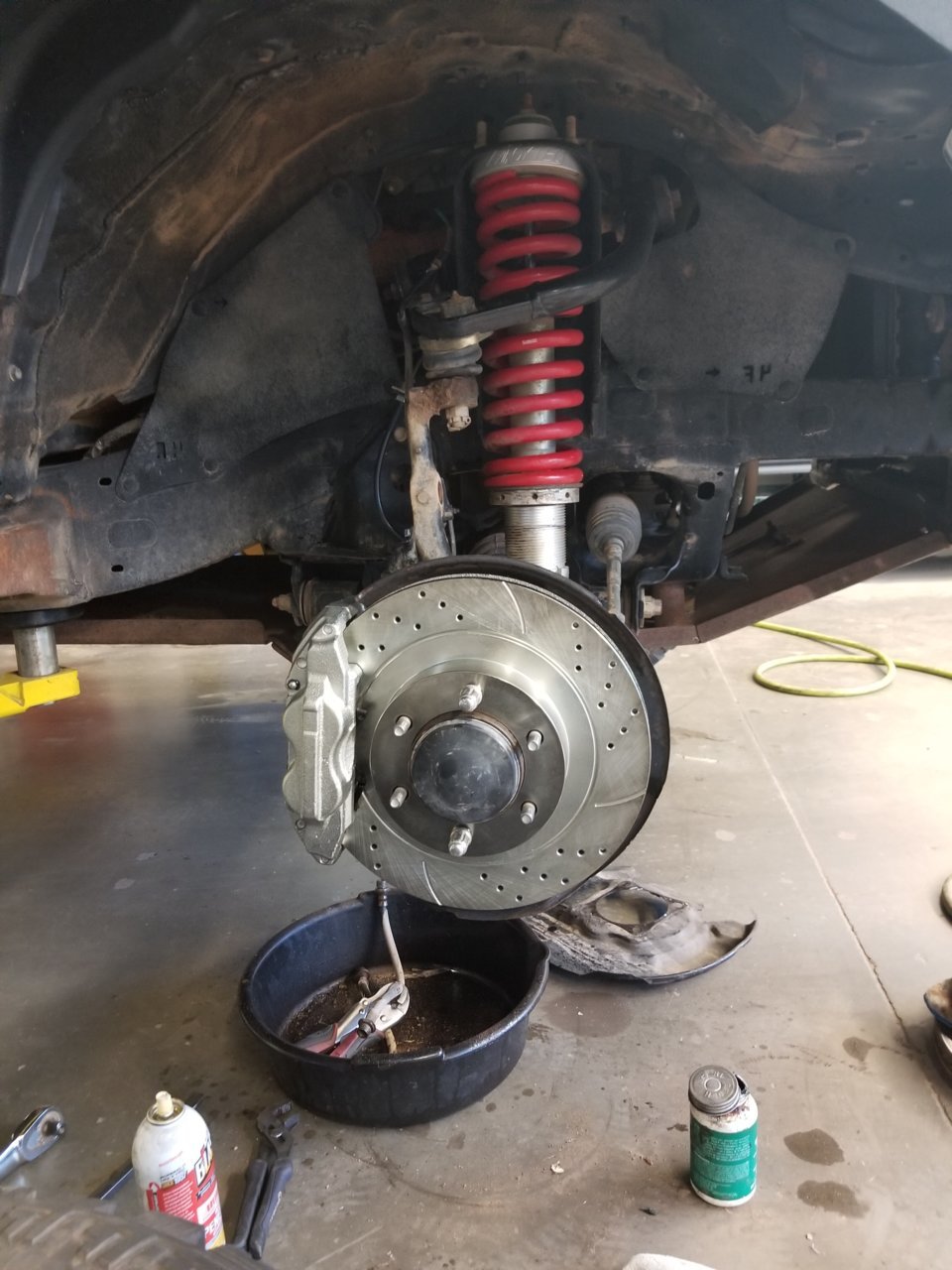

    Here's what this write up doesn't tell you.
    You're going to need an impact and a case of liquid wrench.
    Somewhere for your kid to go for the day so he doesn't repeat all the new words you're going to make up to describe what you're doing.
    If you do braided lines, you need to plan on new hard lines between the braided line and the caliper.
    Past that, this is awesome and I appreciate the OPs time and work to figure this out for us all.

    Throw a big screwdriver in the disc slots and butt it up against the caliper bracket, then get busy with a breaker bar and jack handle for an extension. Throw a towel on the breaker and socket to catch anything if your breaker decides to explode. Step on the jack handle and give a little jump.
    Dont forget to anti-seize the axle splines and nut when you put it back together.

    You pics appear to be for a 2WD Tacoma. How does this work on a 4WD?
  15. Jun 25, 2018 at 4:08 AM
    #175
    Darkgoatracer
    Darkgoatracer Well-Known Member
    Feb 18, 2017
    #210945
    5,610
    Nick
    Northern VA
    2012 trd sport tacoma
    Stock
    The exact same except you pull the dust cap off and remove the axle nut from the hub

    Do you happen to know the socket size for the axle nut?
  17. Jun 25, 2018 at 4:16 AM
    #177
    TacoFMS
    TacoFMS Bubble bubble bubble pop
    Jan 24, 2010
    #29938
    8,004
    Justin
    Louisa County, VA
    Just a vehicle to take trash to the dump
    One or two things modded... Check out the build thread
    35mm
