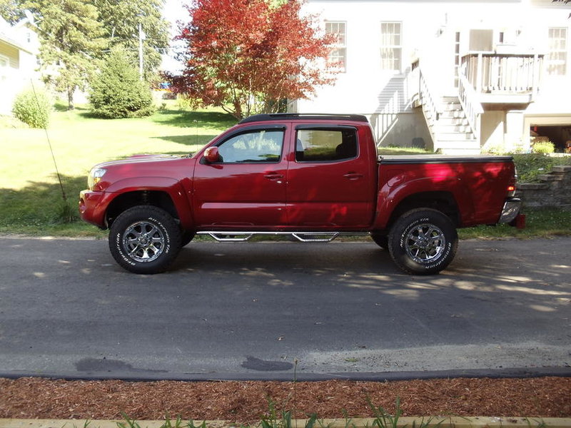

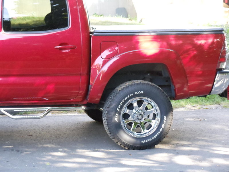

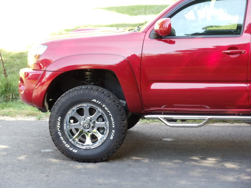

    Bilstein/5100 combo from Toytec. LR UCA's.1.5 AAL's Full audio upgrade.Pioneer 8400, JL Audio subs. All Boston Acoustic pro speakers, and a Kenwood XRS 5 amp. Grillcraft, Smittybuilt stainless steps. Debadged. Soon 17x8 ATX Ledge wheels w/285/70/17 BF Goodrich
    Here is mine with the Toytec assembled Bistein/Eibach combo at 3 full inches with Light Racing UCA's with TSB in rear and 1.5 AAL

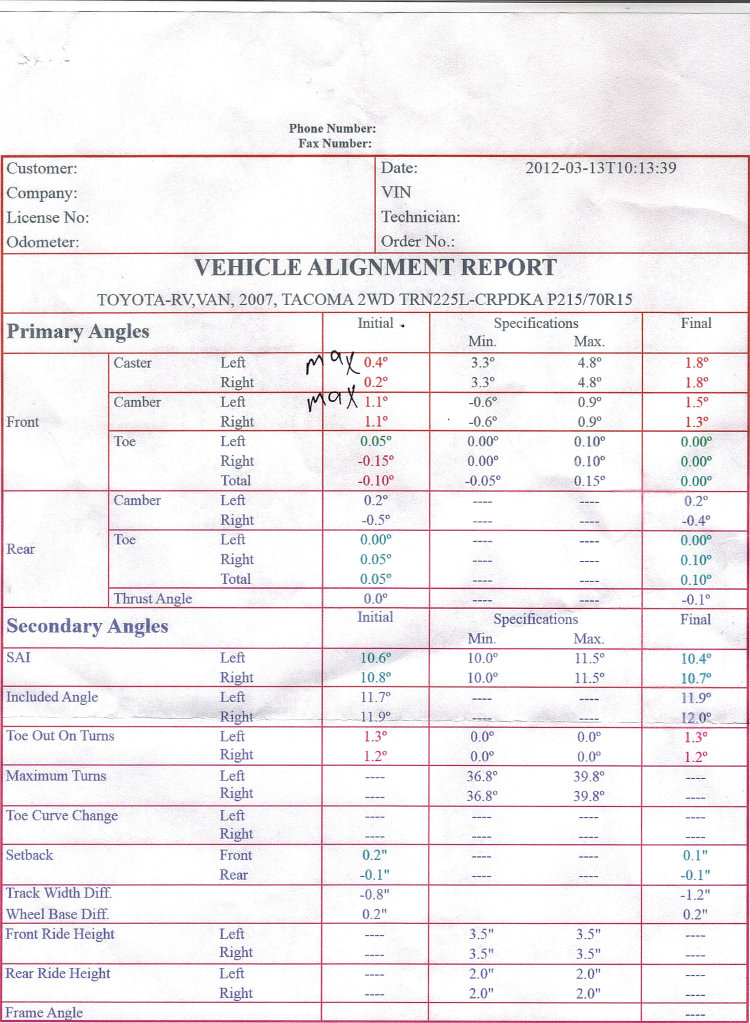

    Bilsten 5100s, Eibach Coils, 2" toytec AAL, LR UCAs, SC5 Matt Bronze

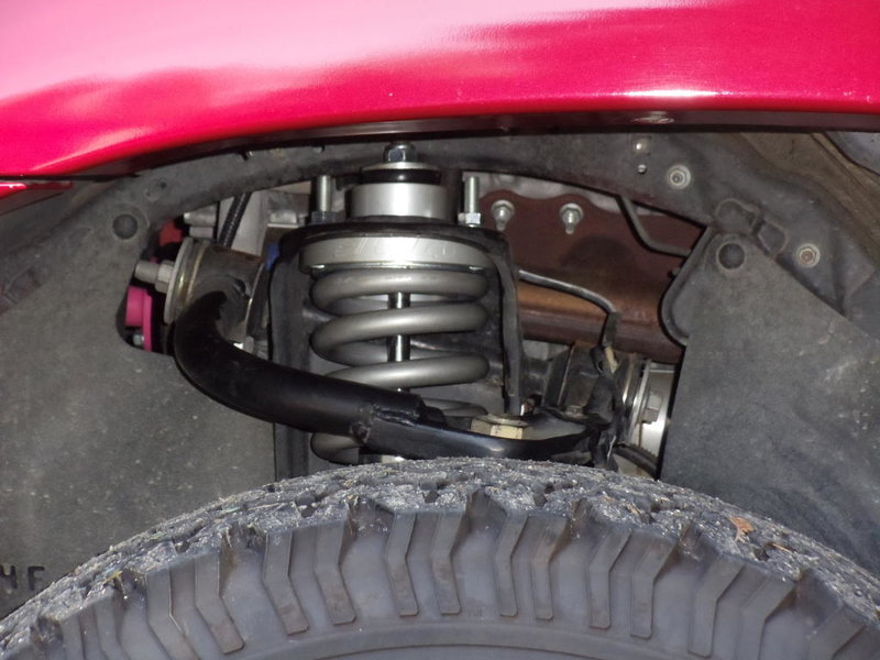

    I could not get my alignment perfect, so I got the LR UCA's in the mail.
    Here is my alignment w/o it.
    I got 5100s all the way around, front set at .85, rear toytec 2" AAL, Eibachs, and yota lean spacer
    Before
