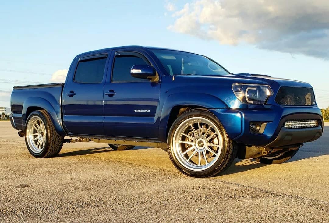

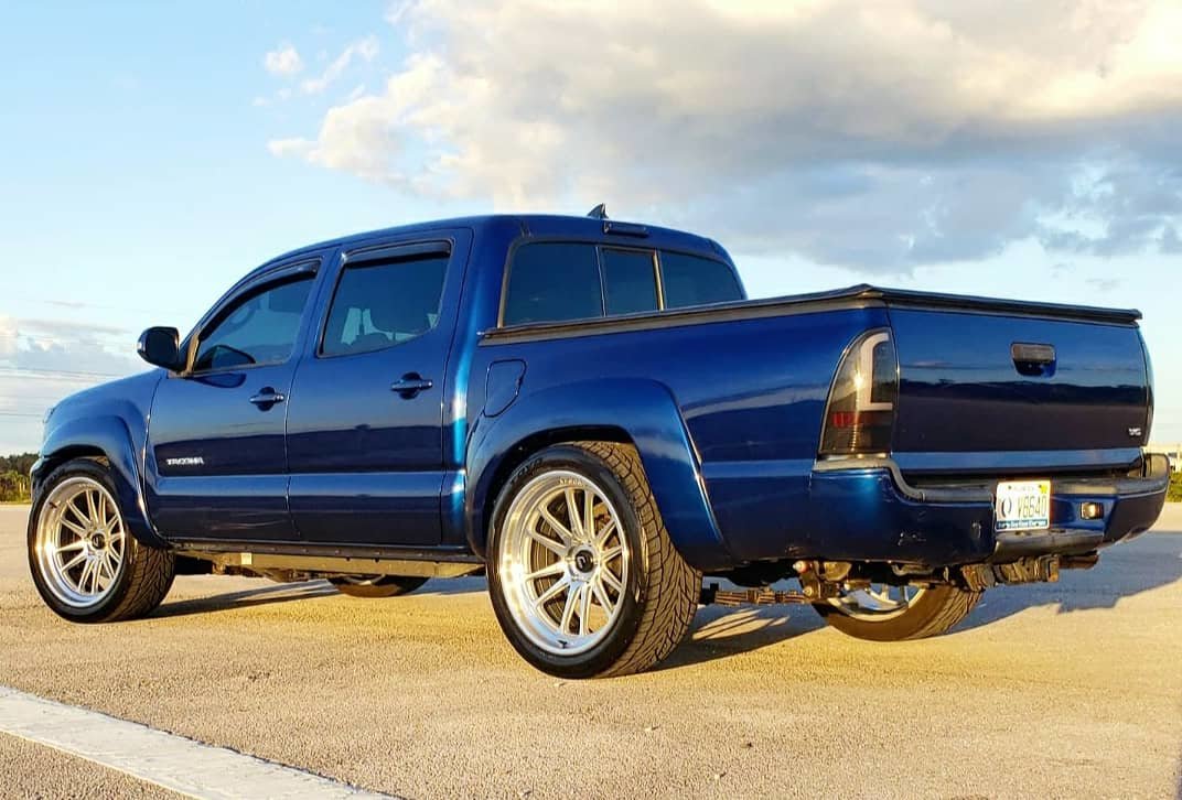

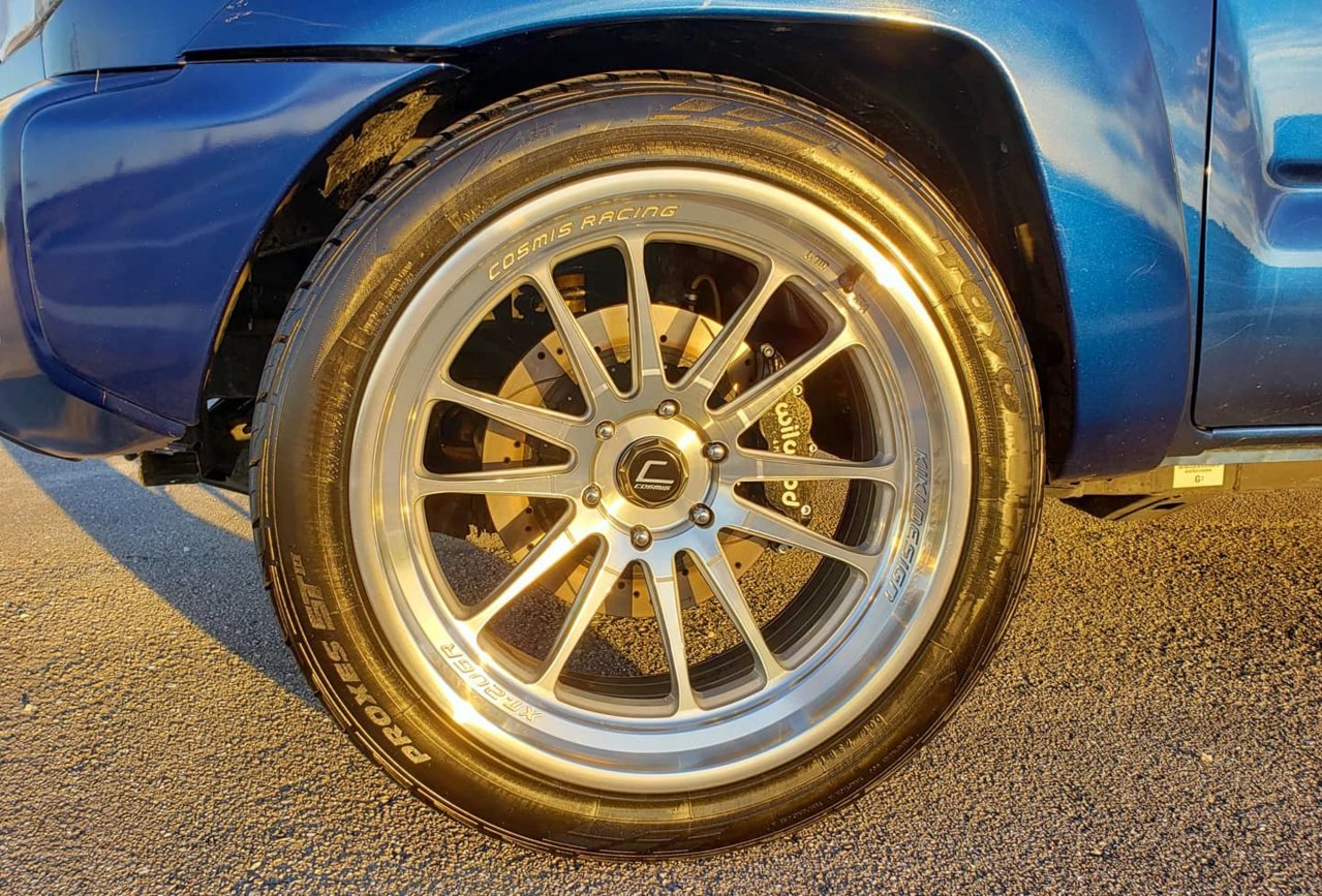

    And here is some pics of the money pit:
