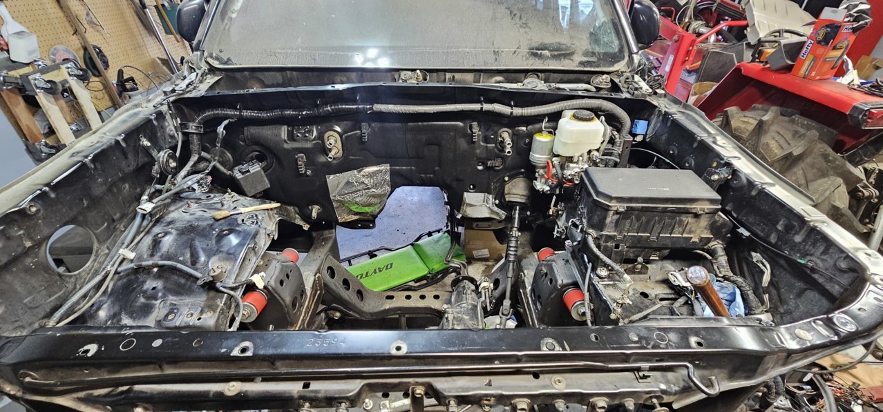

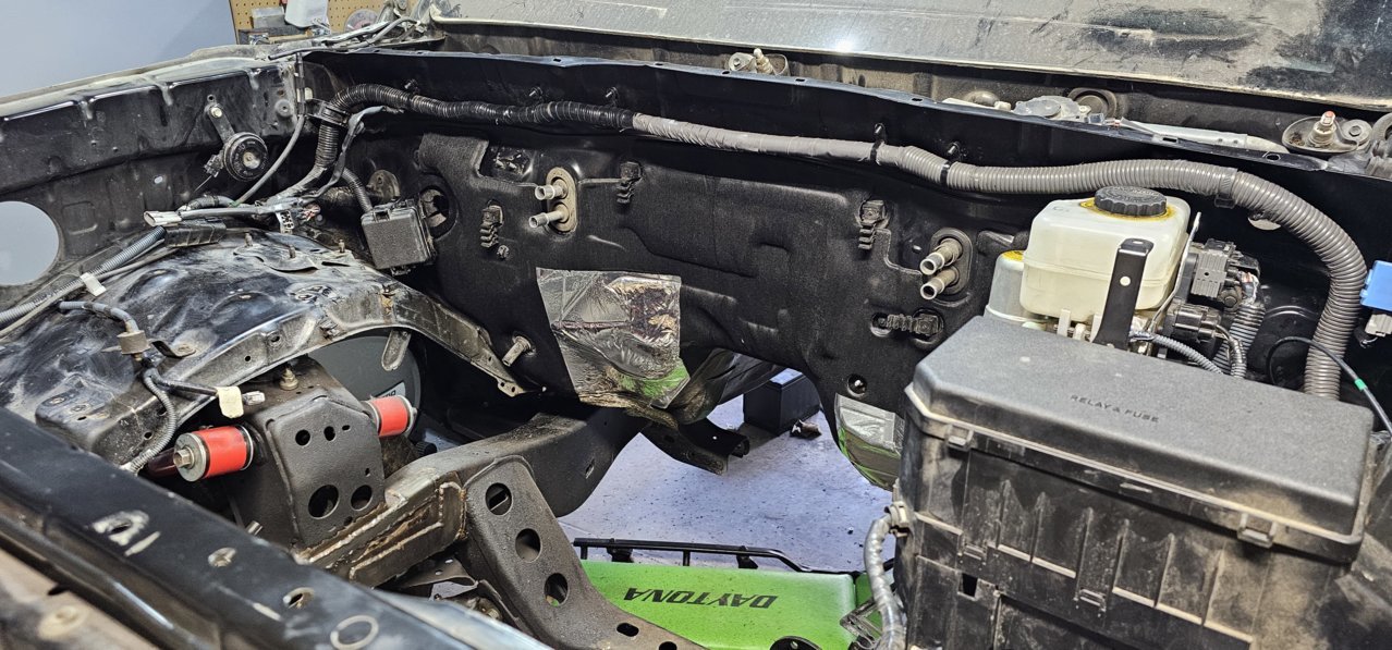

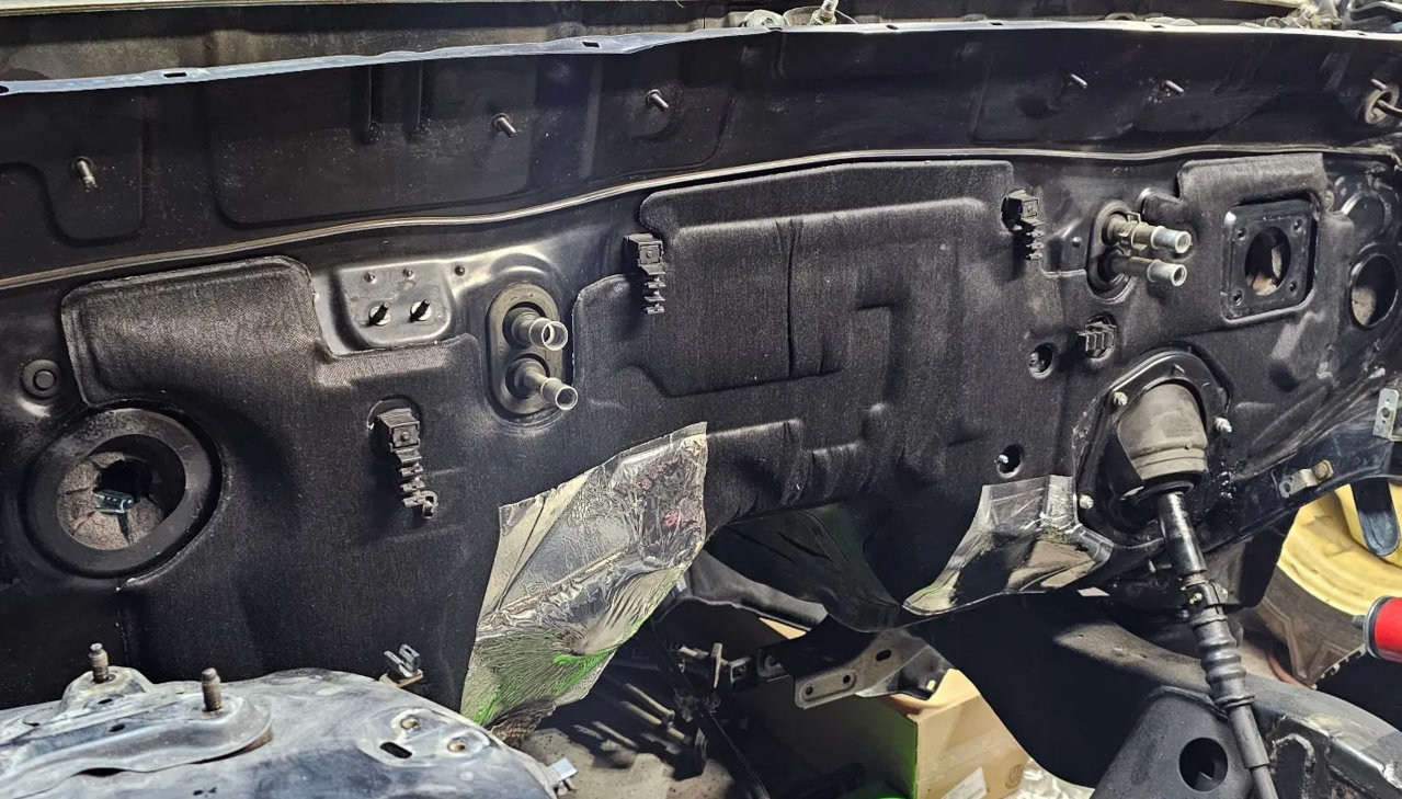

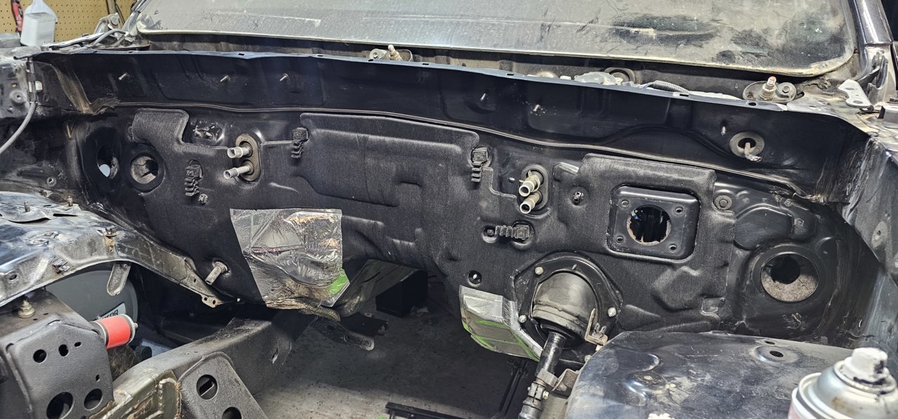

    Engine bay insulator installed! Tomorrow I am going to throw in the engine bay wires along with the fuse box!

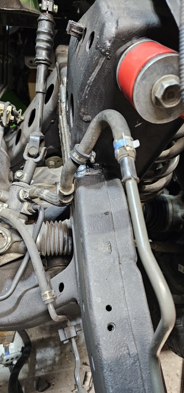

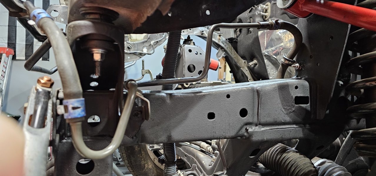

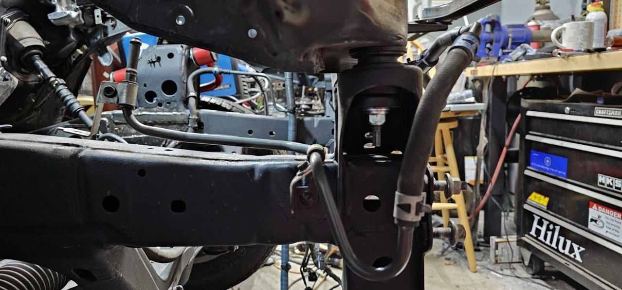

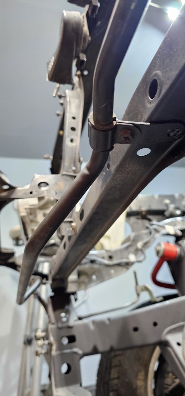

    I got to work on figuring out gx power steering return line. This is what I came up with. I just welded the brackets that hold the bushings. I can still unbolt the line if I need to so this works.

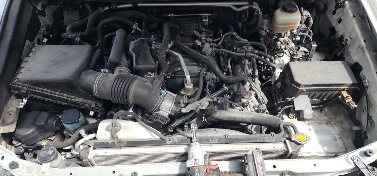

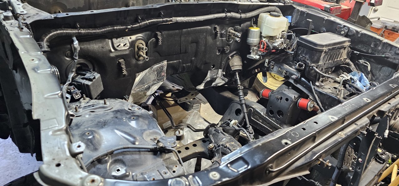

    A little motivational 2.5 gen headlight picture to help further the vision boys. I am very happy with how things are coming along. I had to get the headlight out to check clearance of the power steering reservoir, SAIS pump and window washer fluid reservoir. See picture below to reference how it's layed out in the GX
