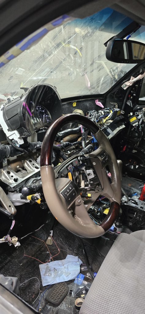

    What I am also excited about is to change out the driving support computer and get the crawl switch. This will allow me to have crawl control and multi terrain select. I am going to do that now while the dash looks like this.

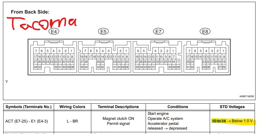

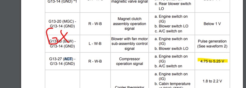

    Today I hooked up a bottle of freon into the low pressure side, I was able to fill about 10oz. I pushed the AC button and nothing. I also discovered I have a freon leak at the firewall where the tubes hook up to the ac evaporator. I suspect my issue is with the ACT signal voltage discrepancy. I'll be working on a solution to seal up the freon leak. What do you guys think about the ACT voltage issue?

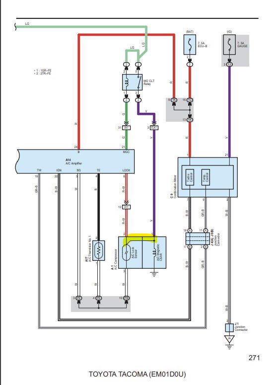

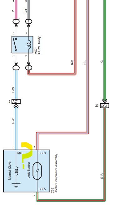

    Also can anyone explain to me why the tacoma lock sensor work be wired with the Magnet clutch relay and the GX460 is not. Is this going to be an issue for me?

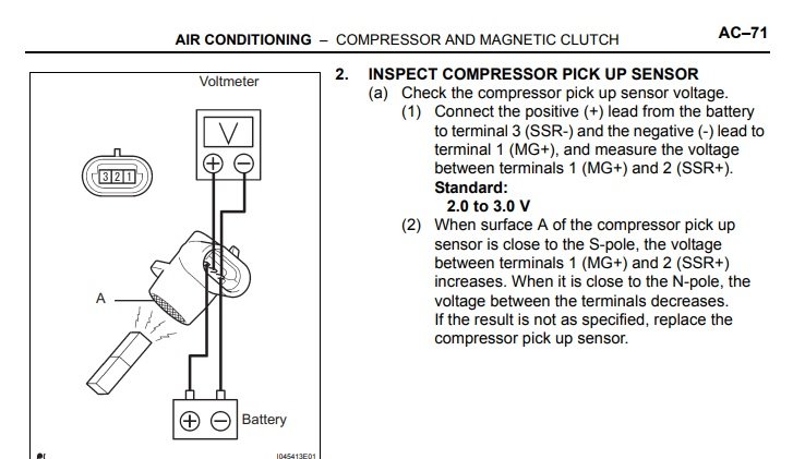

    I can't remember, are we using the Tacoma A/C Amplifier?
    Idk about the GX but on the Tacoma the Lock Sensor gets power on Pin 3 from the same wire that goes to the compressor clutch, Pin 2 is Signal and Pin 1 is Ground.

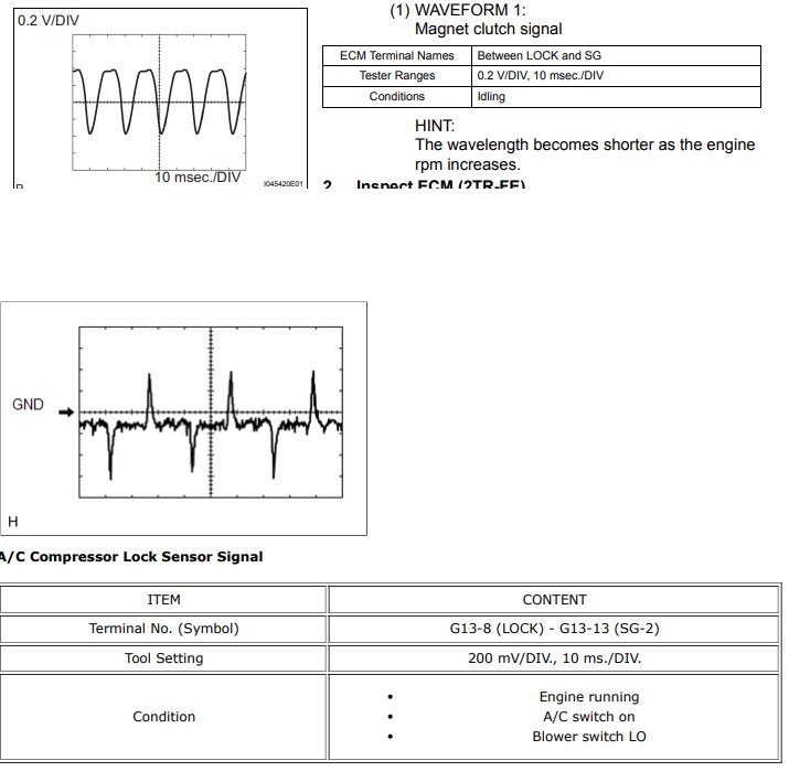

    The GX and Tacoma Lock Sensors look to generate different signals as well.
    Tacoma on top GX on the bottom.

    Yes, using tacoma AC amplifier. I am synthesizing the TW temp signal using a module that I bought from someone on here. I wired up the pressure switch directly to the AC amp. I thinking the discrepancy is at the ACT signal that the gx ecu is putting out and the tacoma ac amp is receiving.

    Right now the truck does not attempt to idle up or lock the clutch.

    Since it needs 12v maybe try powering up that pin through a test light and see what happens.

    Will do, I am going to fix the leak first and then power the pin with 12v. And maybe I need to change the lock sensor on the GX compressor with the tacoma lock sensor?

    I'd go through a test light just incase
    The lock sensors I'm almost certain are different and won't interchange, you can try it and see if it's happy. If it isn't you may need to generate the lock and RPM signals as well like @Pittsy did on his LS swap build.

    I put the plans for the module on that thread somewhere. The only caveat to my module, is that something else needs to be responsible for shutting down your AC system at WOT and if the engine overheats. My Holley was responsible for that, using some relays. This module is spoofing ECT, RPM, compressor lock, so if it did go WOT or overheat without the Holley controlling those aspects, it wouldn’t ever shut down. The stock AC controller still took care of turning the compressor on/off depending on temperature selected on HVAC controller, using the stock thermistors and stuff, and the stock AC button, which was nice. Literally worked like OEM and you’d be none the wiser unless you knew what I did.

    Very Nice!! If hooking up 12v to ACT doesn't work with my method then I will be going this route. I thought about getting one of these Arduinos
    but I didn't know how to write the code. Thanks man!
