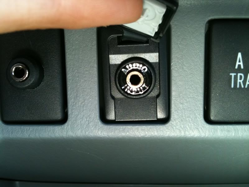

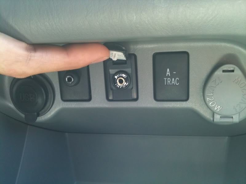

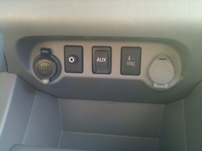

    Pics:
    The 3.5mm jack on the left is for ipod video, NOT AUX input.
    AUX input is in the stock location. You'll also notice i have replaced the 12v cigarette plug on the left with a USB plug, wired up to my iva-w505. I got this usb plug adapter from mp3car.com. here's a link:
    http://store.mp3car.com/Automotive_Marine_USB_Cigarette_Port_Replacement_p/com-040.htm
    AUX input plug in factory location shown

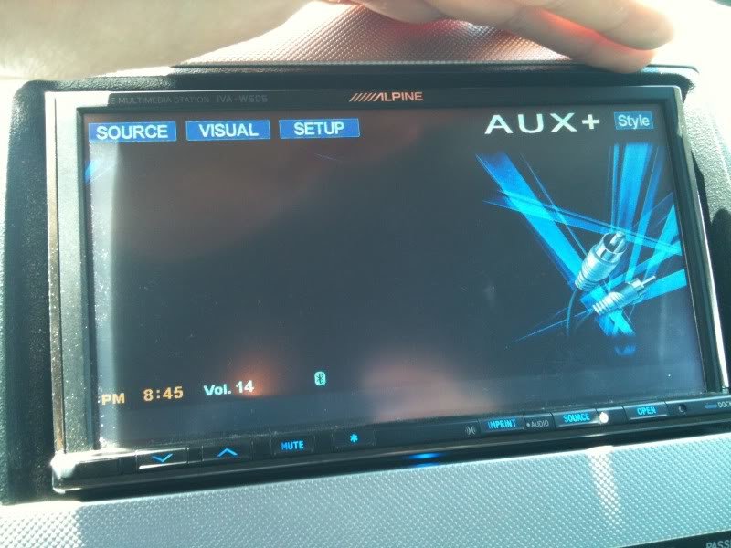

    This is what is shown on my iva-w505 when i'm uning the aux input wired in
    Hope this helps some of you guys and girls out!
