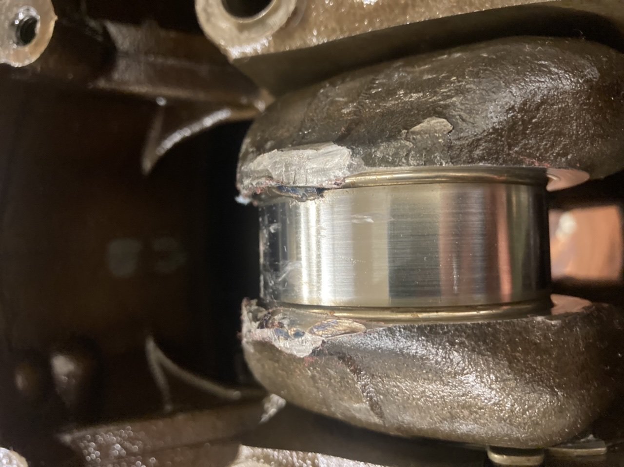

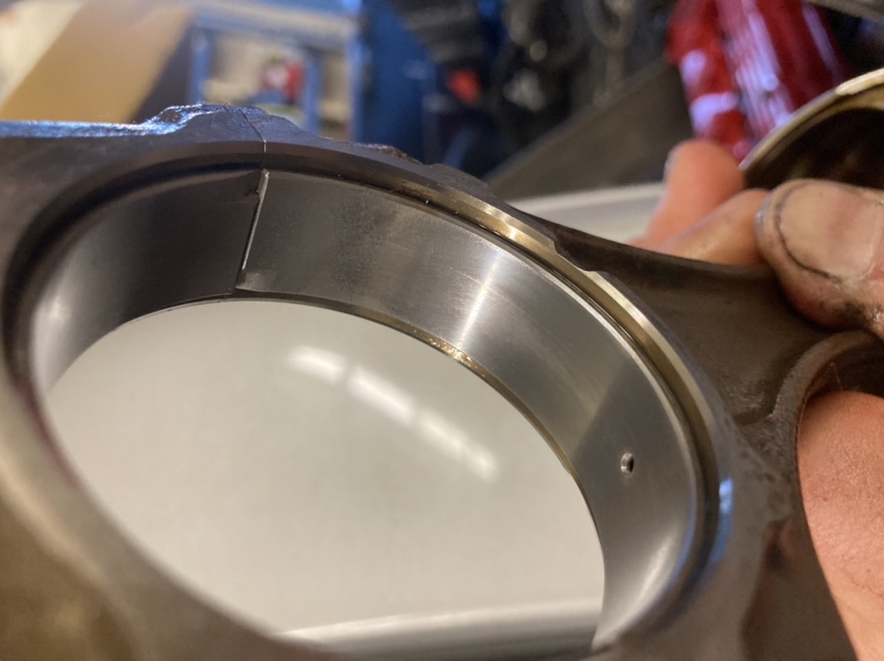

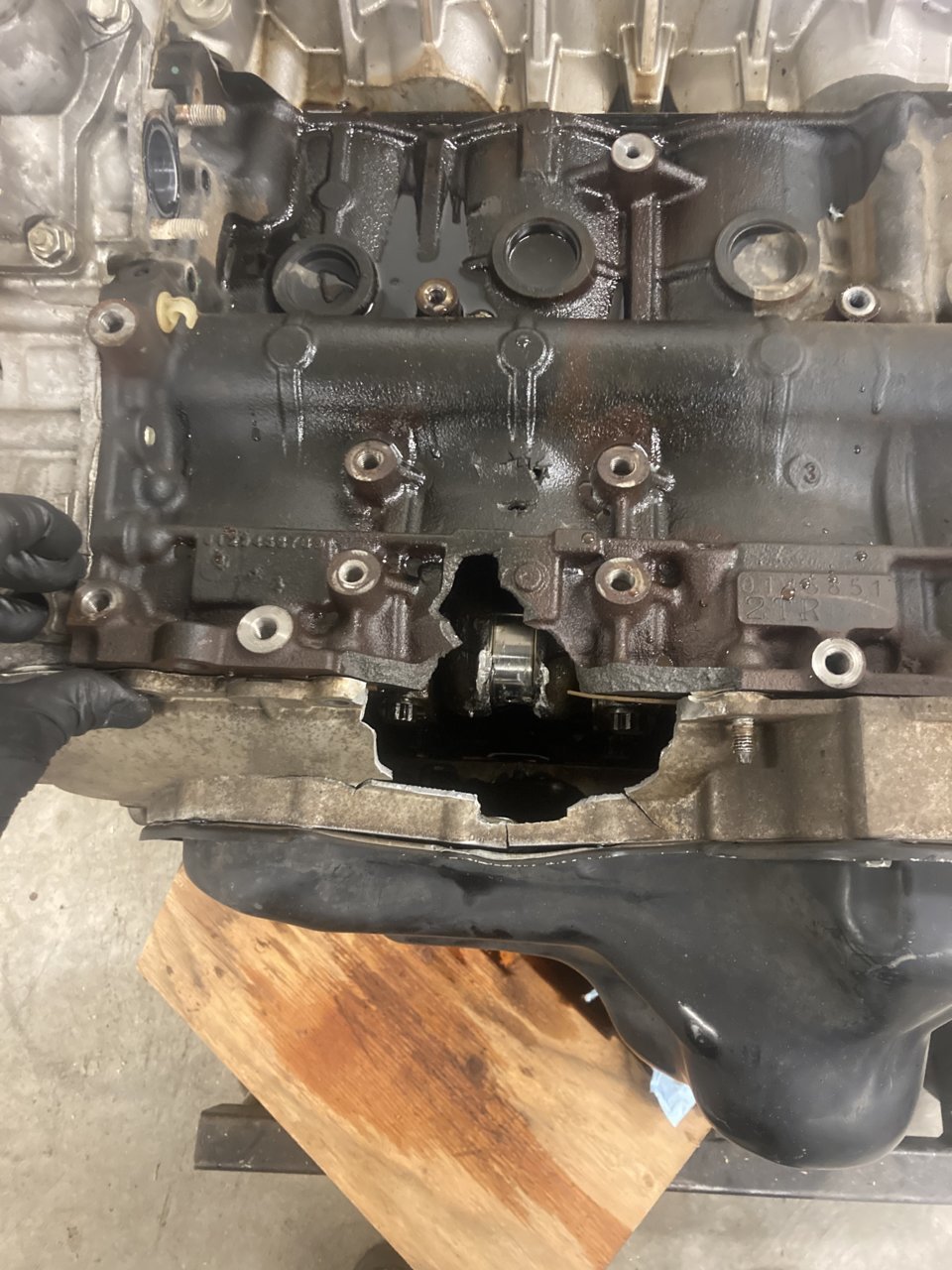

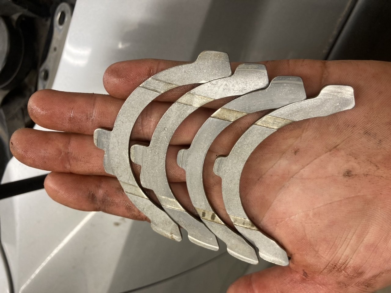

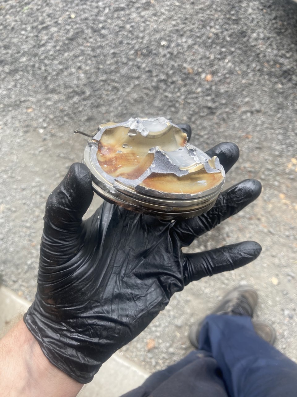

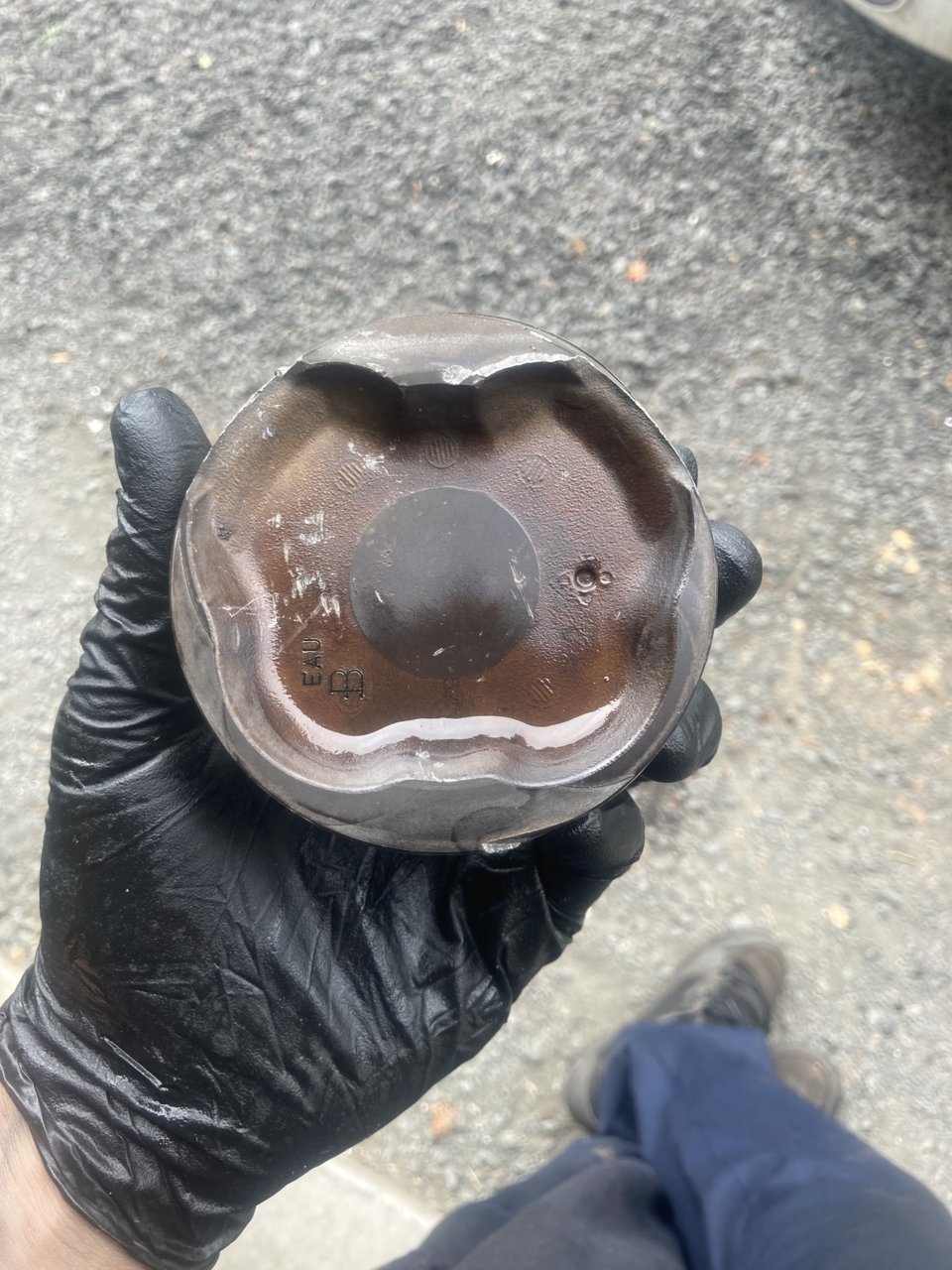

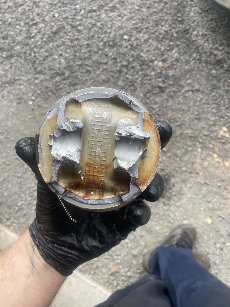

    Carnage pics for the curious2187AAD5-137F-4E3F-9D51-49D6A38AE32A.jpg 1288EDAC-E6D9-452D-9802-33DB18E41FEA.jpg1C50CE4F-8FE4-40C7-990D-9B117426F3C3.jpg F1C6DD76-D8CC-463C-AF36-7D954FF1DFD5.jpg

    Oh, a little JB weld and the block should be good to go.

    Maaaay be a little hard to weld back together. Lol

    Fucken nice sunlight window there. I had a isx 15 that windowed the block that. Drove the old girl in the shop spitting and puking oil and coolant. Pretty cool to watch the pistons going up in down.

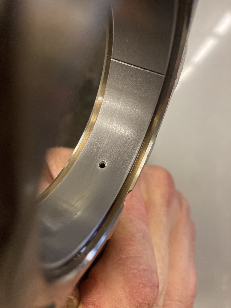

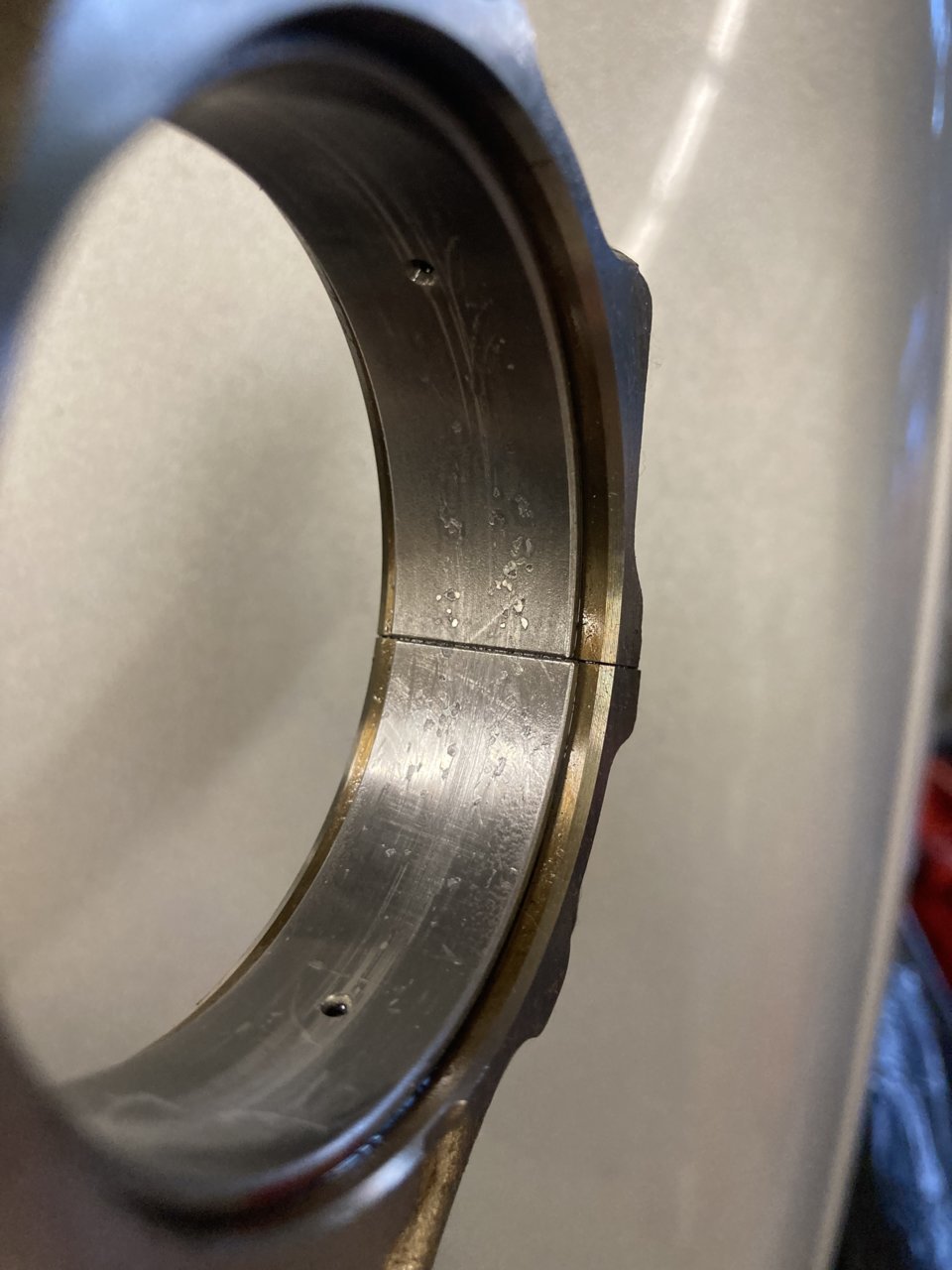

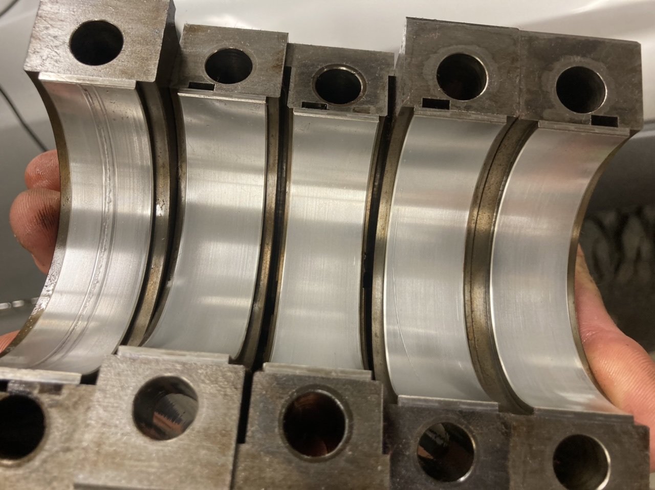

    5BA71BDC-87DC-44D7-9645-AD2641D585B6.jpg F1757A75-E103-497C-8E89-37DA7EE95D19.jpg 2AEF316C-285D-438A-B43B-F2BA28771B17.jpg 30471EB9-010E-4367-80A6-EFF7ACF694B6.jpg F29324B7-50EB-4EDD-BE36-55E6435F3670.jpg 10298EAE-B200-4CA7-AD97-9DBE7C581104.jpg Well, we may have something here. After a complete tear down and inspection i did notice something. Not a cause of failure but possibly a potential failure point. Ive pulled apart 3 engines so far. Both engines with 200k-220k main/rod bearings look flawless like new condition. The supercharged engine was not the same story, mains look good but the rods show accelerated wear on the top Bearings. Not blown out but almost slight discoloration as if low oiling. All crank main rod journals have good polishing still. In teardown of the oil pump and bypass valve it seems as though the bypass valve spring is pretty weak in my opinion. May need to install a washer for heavier bypass pressure. Beings we dont have an oil pressure gauge we would never know what the actual pressure is, or if it was presenting a problem.

    Additionally, a small radius on the oil pump output port will help with volume/flow.
    Are you running any type of oil cooler?
