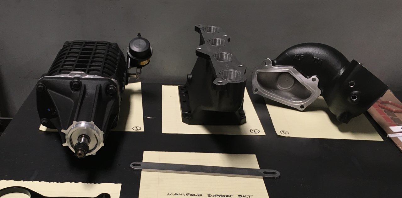

    It looks like his setup is a roots supercharger mounted directly on the intake so there probably isn't room for a sandwich style intercooler plate unless the whole kit gets re-engineered. The meth kit is probably his best option at this point.

    Hmmm…
    See the photo, I’m sure you can figure out…
    The CNC aluminum manifold in the middle bolts to the side of the 2TR. The supercharger on the left bolts to the manifold. The intake plantain bolts to the back of the supercharger. I know it’s not a good pic but I really don’t see much room in between the manifold & the blower? Sadly I’m as far away from being a welder / fabricator as you can get. Anyone else care to give it a shot. Maybe someone could CNC print up a manifold that would accept an intercooler between the block & the blower? Way above my skill level. :hattip:

    Who did that build? The mattford.com sticker is a dealership near me and if they are into this sort of thing, I might need a van.

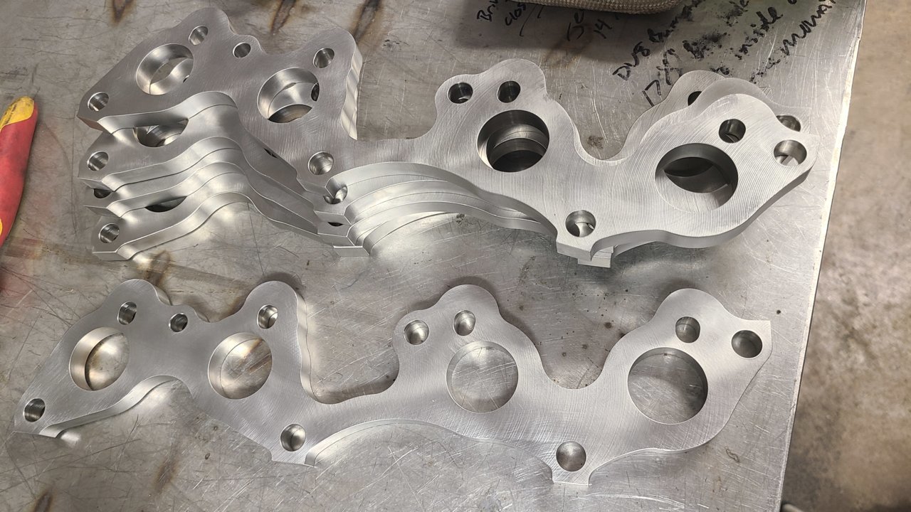

    Torspd Custom Turbo kit [] Borg Warner 9180EFR Turbo [] Haltech Elite 2500 [] TiAL Q BOV [] TiAL V44 Wastegate @ 15psi [] CP Pistons [] CP Carrillo Rods [] ARP Head studs [] ARP Main Studs [] ARP Header - Head Studs [] Ported Heads w/ 1mm oversized valves intake/exhaust [] Brian Crower Forged Stroker Crank [] Darton M.I.D. Sleeved Block [] Kelford Camshafts [] Torspd 160* T-stat mod [] APR Large Fuel Rail [] Walbro 460 LPH E85 Fuel Pump [] FueLab FPR [] APR T56 Conversion Kit [] KP RACING Built T56 [] McLeod Racing Custom Twin Disk Clutch [] One Piece Aluminum Driveshaft [] MGW Shifter [] Custom lowering kit [] Ohlins Front Coilovers [] QA1rear shocks [] Custom Ron Davis Radiator [] Dual SPAL Electric Fans []
    Ordering some more material in the beginning of October. Should things work out as I hope, then with the help of @BassAckwards , we should have a turbo manifold for his truck. Then 4 more to make. :cool:
    Every bit of it.
    I won't be making down pipes, unless the truck is in my garage. Too many turbo variations. My turbo choice, versus others'.
    I recommend getting this type of catalytic converter.
    https://www.stainlessbros.com/Catalytic-Converter_c_84.html
    That manufacturer is used across many oem markets.

    To re-post.

    Jesus‼️ (Sorry I never saw) That looks thicker than 3/8” more like 1/2”!
    Doesn’t look like any exhaust leaks against the head… :bowdown:
    Be worth the drive to S. TX. for an exhaust system, cough cough…?
    1/2" it is. :thumbsup:
