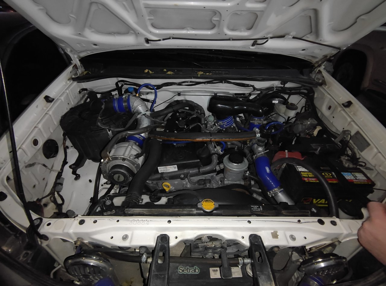

    Rotrex supercharger

    What size pulley are you running?
    Also, welcome aboard!
