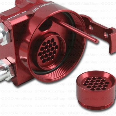

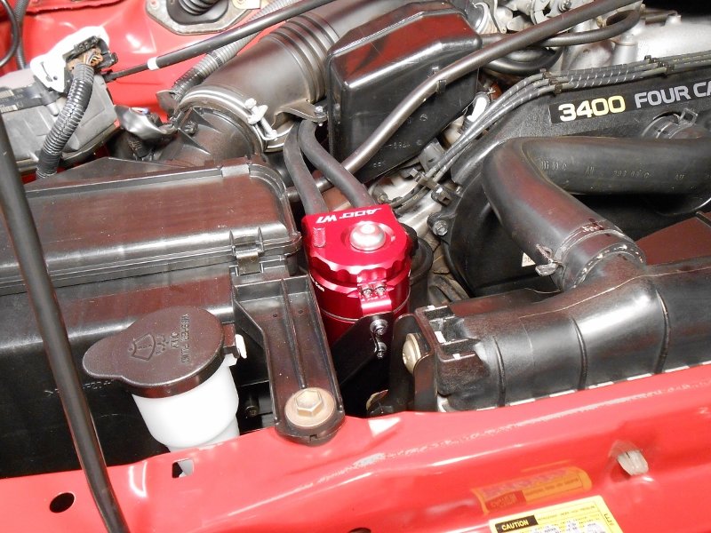

    So I ordered an "ADD W1 Revision 2" catch can for my late 4R 4.0 because of all this http://www.tacomaworld.com/forum/2nd-gen-tacomas/231227-oil-catch-can-install-guide.html
    It was $58 from Newegg of all places as another member had stated (forgot his name), shipped free. I realize one can be made up from air line driers and the like but these things are very nice, and this one is red.:D
    Then I thought of trying it out on my 99 3.4. Several times I had noticed an abnormal amount of oil in the throttle body while most of the time (7 spk plug changes, numerous t-body/IAC cleanings) things were pretty dry. In conjunction with this it occurred to me that I had overfilled the engine with oil on a few occasions (full 6 qts). Not much, just a hair above the full mark. This "overfill" would revert down to the full mark in just a few weeks and stay there. Other than this apparent consumption this engine does not use any noticeable amount of oil at all even with 230K + on the clock.
    The grand theory is this. In spite of the presence of a windage tray of sorts the extra oil was getting wipped up so to speak and finding it's way to the PVC valve. By temporarily (yea right) installing the can on the 3.4 I could monitor the whole deal.
    To date I have run it for about 1K miles starting with the oil level dead on the full mark with a relatively new PVC valve. The good news is no oil has been recovered, none, the can is not even damp.

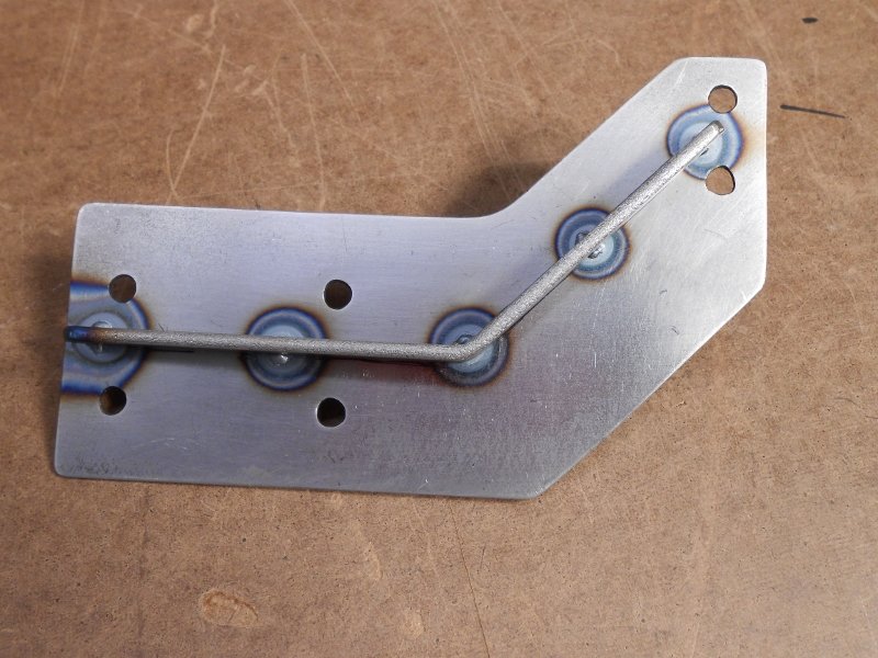

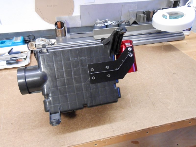

    mount bracket/location and cute little rosette welds.

    The can is located between the PCV valve and the intake and is intended to separate out some of the atomized oil, moisture, and combustion gasses that are sucked out of the crank case by the PVC system before they enter the intake. The late model 4.0 engines "consume" a substantial amount of oil this way. So far it's looking like it's a waste of time on the 3.4 with a good PCV valve and not over filled.

    The "ADD W1 revision 2" can is far from cheap. This thing lists for well above $100 and is a beautiful piece of CNCsmanship, that's the only reason I could not resist $58 shipped.
    It has 2 internal baffles with a removable inner chamber where us OCD folks stuff a wad of stainless steel scouring pad (Chore Girl or Scotch-Brite).

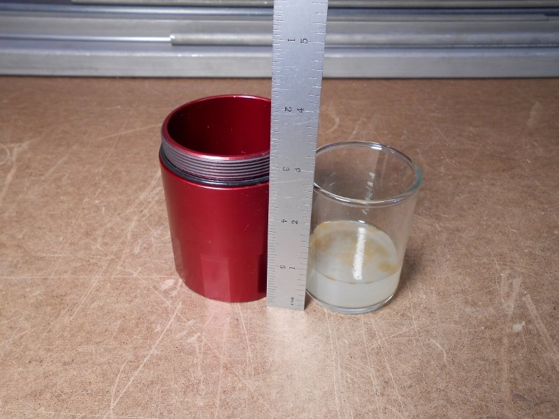

    I did observe a pretty fair bit of water condensation once our weather went from above to well below average. So I will leave the can installed and get another for the 4.0.
    The pic below is after several short trips of 10-15 minutes. From a heated garage into 10-15 degrees. After an hour or so of driving this accumulation would get dried up. To me this points out the value of thoroughly warming up an engine as opposed to short trips. In the case of the 3.4, the PVC hose dumps into the throttle body (EDIT, make that "intake manifold" very close to all the IAC passages. I don't see water setting in there without getting cooked off as a good thing.
