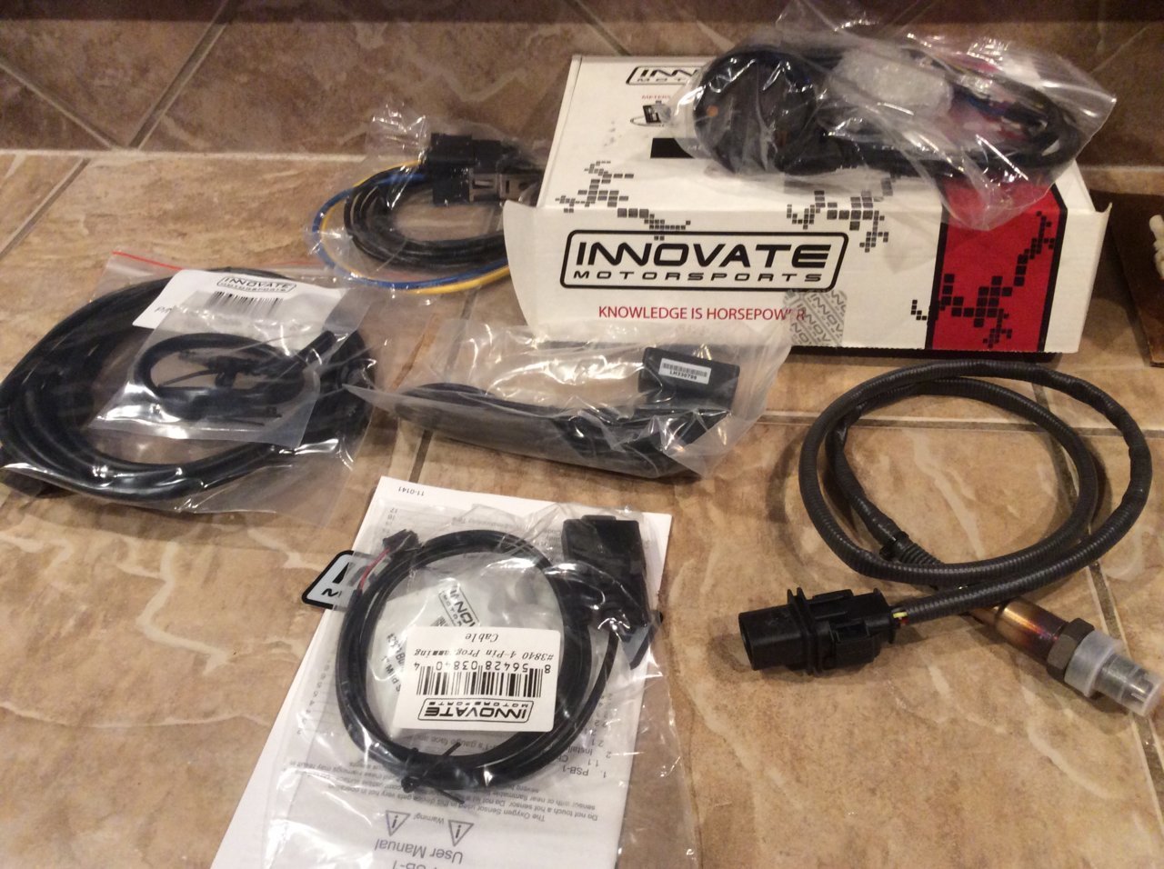

    I’ll be hitting up Import Sport Performance on that AFR Gauge install. There are tons of wires with that kit. It’s crazy. John’s looks clean and super cool/useful.

    You got the boost/AFR in one? Or a separate AFR gauge?
    My AEM one was just a couple wires if I recall, one going from the gauge to the O2 sensor and one going from the gauge to the fuse panel by my left knee, was pretty easy to do (I'm terrible with wiring). I used an add-a-fuse to connect the gauge to the dashboard fuse so that it turns on/off with the key in the ignition. I imagine the all in one gauge has a lot more to it though.
    I should mention I had to follow a step by step Youtube guide to install it correctly lol. And I had a shop weld the bung in for the O2 sensor since I don't possess that skillset.

    I believe he’s putting in the PSB-1 that has Boost, Vacuum and AFR all in one like mine.

    Ok yeah, that's a lot of wires lol
