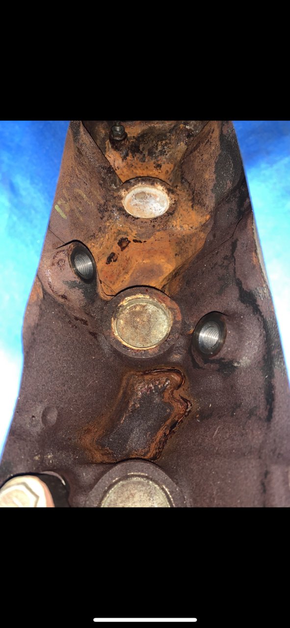

    Well fuck. I spoke too soon or jinxed myself. The truck has been running better than ever before since the knock sensor change. But just tonight I started to get the same symptoms as before.
    Looks like I’ll be doing the GM knock sensor mod sometime soon.
    @Empty_Lord i recall you mentioning you had a customer with fails knock sensors and it turned out to be coolant in the valley.
    when I did my job I had seriously corroded lower intake manifold gaskets with signs the coolant was running into the valley judging by the rust spots.
    The valley plugs looked suspicious as well but I didn’t do them because someone scared me out it it by saying they’ve seen a lot of leaking plugs from bad installs.
    I may have to do this as well…..
    Honestly, I’m just sort of sick of messing with this. One thing after another.
    Too add to this the thought crossed my mind to drill a hole in the rear cover that is part of the crossover tube so I could at least try and stick a borescope in there to check later on. I didn’t do it. The only way I’ll ever know if it’s leaking in there again is by taking it all apart again. Nightmare.

    The valley coolant leak is usually from the bypass pipe. If you had it you’d be seeing coolant running down the bellhousing.
  15. Aug 28, 2021 at 10:39 PM
    #3555
    Shortman5
    Shortman5 Well-Known Member
    Mar 30, 2013
    #100952
    2,725
    Supercharged TRD
    TRD S/C, ADS coilovers.
    my bypass was fine. I replaced it anyway. My lower intake gaskets were toast. They rusted away and there was a concerning amount of pitting on the head valley ports. interestingly the inside of the cast iron block seemed to look totally fine and the inside of the coolant ports looked great. Here’s what I mean about the valley plugs being suspect.
