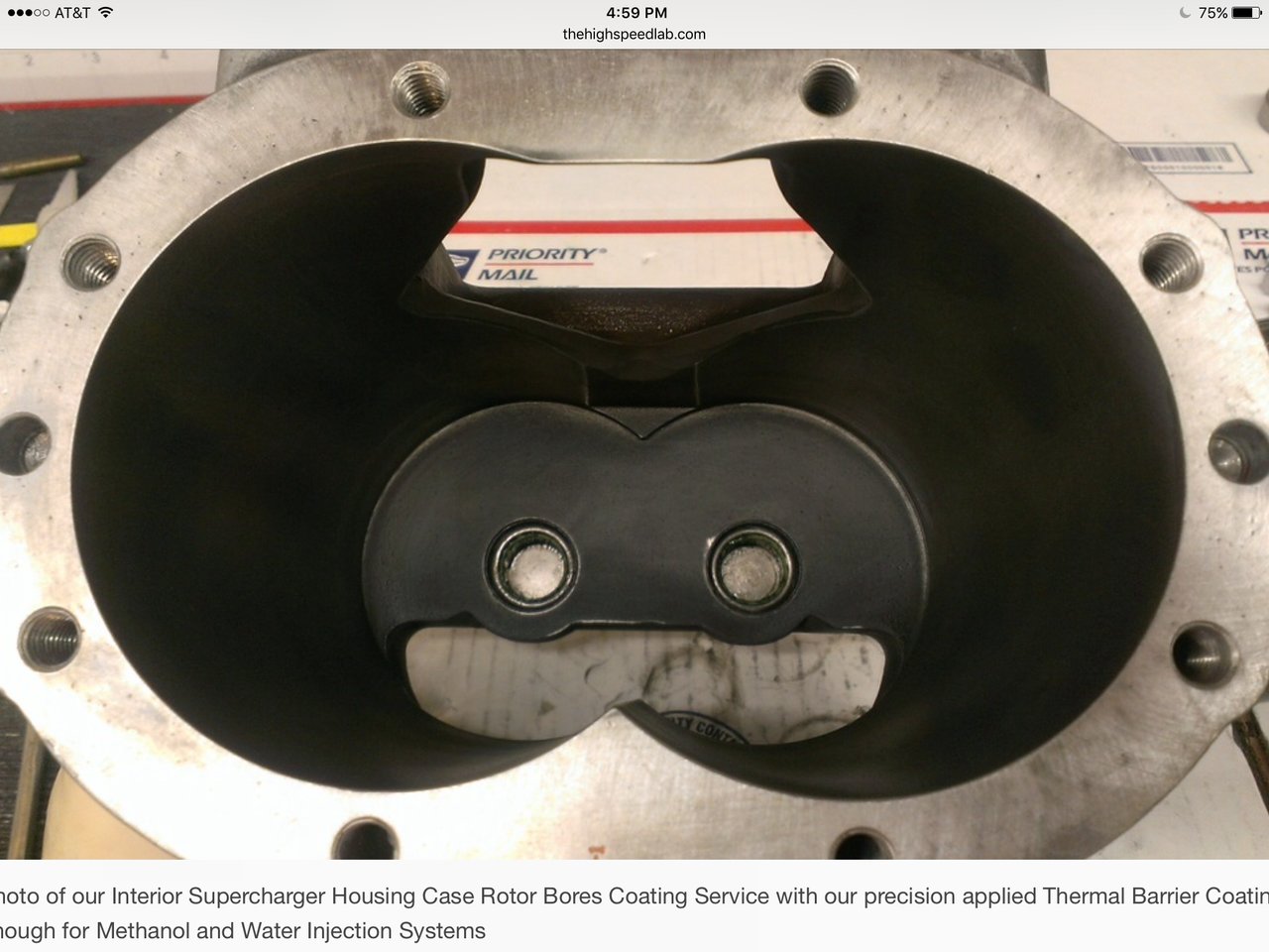

    V6 5sp,RegCab,TVS1320 Supercharger, 56mm pulley, methanol injected Haltech ECU, AC Tvs1320 supercharger,(MUST DO) every 125,000- 150,000 needs rebuild Projector headlights HID 5 speed manual Amsoil for all drive train Smaller 56mm custom pulley, (MUST DO) 2004 DESNO fuel injectors, zero ping ping, 2004 side door mirrors Dick Cepek Rims, Michelin tires LTX, ATM Pathfinders Dynopro ATM ( that last 100,000 miles) Now running Dynopro ATM mud and snow tires KN cold air intake Cat back dual exhaust with ss exhaust tip, Raised exhaust tail pipe to 2" below body line Optima*dry cell battery,red top Alpine sirius radio, 200 watt amp, focal is165 split door pod speakers Focal door speakers Subwoffer behind seat Viper alarm, Electric Locks Dark tinted windows, bucket seats corbeau lg1 Tacoma Rubber floor mats TRD fender extenders, Bilstien shocks, King shocks JBA UCA trailer iv hitch, electric brake control, Drilled slotted brakes, High carbon steel (MUST DO) EBS green stuff 7000 series pads(MUST DO) TRD engine oil cap TRD stick shift, Marlin crawl shift kit. Rear sliding window 2002 4Runner functional hood scoop cut into Tacoma hood, 4Runner dual overhead map light Gentex Auto dim + Compass + Temp, garage,rearview mirror Snow Methonal kit stage 2 Custom 3 core aluminum radiator Linex bed liner Haltech stand alone ECU, Intake supercharger gauge. Stainless steel brake lines, Custom leather wrapped steering wheel, Haltech stand-alone ECU,
    it's a gamble, it might just need a full rebuild 1000.00 if you can't do it yourself with rotors coated.
    But with other parts needed your quickly close to 2500.00 with rebuild, Still you don't know if there are any other problems. My opinion is to pass, I would only buy one from someone that KNOWS it running or who has some history or if you could listen to it. This one looks rough,
    I don't like the look of the marks on the rotors.

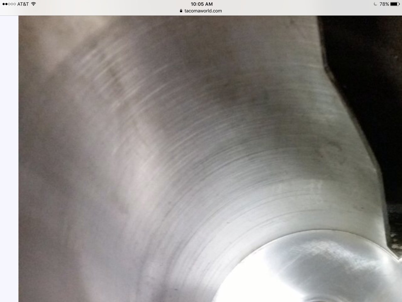

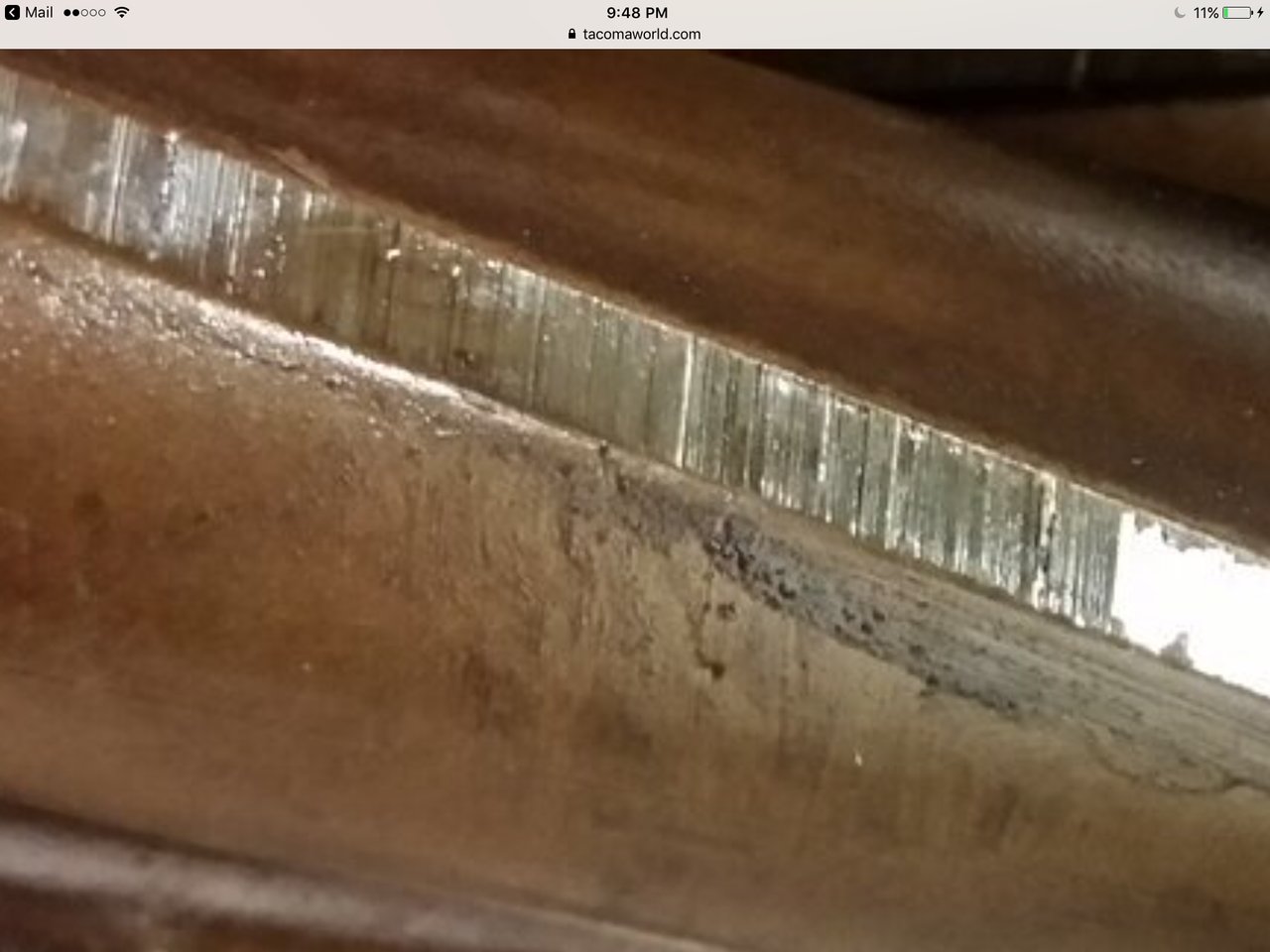

    Those rotor walls looked all scratched up to you???
  9. Dec 19, 2017 at 11:04 AM
    #629
    SCRunner12
    SCRunner12 Tundra Troll
    Aug 8, 2011
    #61363
    9,115
    Robert
    Santa Cruz, CA
    2006 Tundra DC, TRD, 4wd
    Hard to tell with pictures, but they look normal to me. Have to remember dirt and such does get passed the filter and will be circulated throughout that casing. As long as you can slide your finger along and nothing major catches you, it should be good to go.
    Jerry311SD likes this.
  10. Dec 19, 2017 at 4:14 PM
    #630
    1997tacomav6
    1997tacomav6 V6 5sp,RegCab,TVS1320 Supercharger,Haltech, 800k
    Oct 5, 2013
    #113940
    10,393
    John
    Denver
    97 reg cab, v6 5sp 300hp supercharged, Methonal Injection, 800,001 plus miles, Original Owner
    Well looks like a lot of wear marks on the walls which would mean a looser fit between the rotors and the wall, less boost, this is probably expected with a used supercharger. I would get the Internal Case Rotor Bores - Thermal Coating done, that would help for a better seal with the worn areas you see and more boost for the extra 200 some dollars considering it needs a full rebuild anyway.
    The tighter the fit with the rotors and walls the better it will perform just like an engine piston.
    souvang likes this.

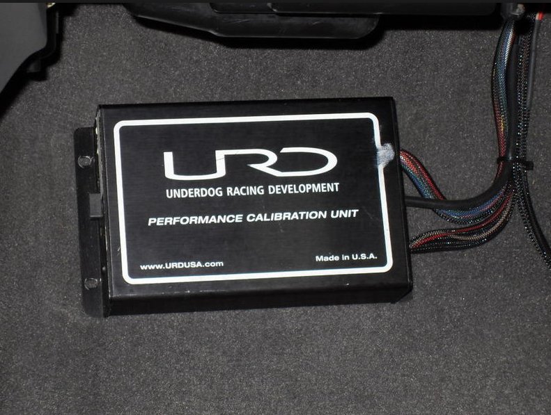

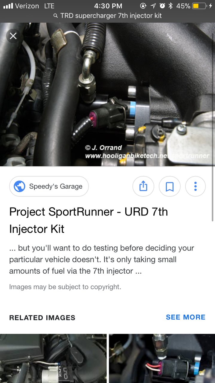

  12. Dec 20, 2017 at 1:25 PM
    #632
    eon_blue
    Mar 4, 2016
    #180213
    69,860
    Azusa, CA
    You'd have a shiny braided steel line plugged into the back of your supercharger, it's hard to miss. I'll post a pic in a sec...
    alphabravo[QUOTED] likes this.
  13. Dec 20, 2017 at 1:30 PM
    #633
    eon_blue
    Mar 4, 2016
    #180213
    69,860
    Azusa, CA
    It would look like this, except the blue line would be a steel braided one (not blue).
    Also you'd have the piggyback ecu for it hidden somewhere on your truck, mine is up behind the glove box.
