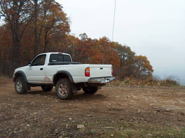

    I have 33's now, but that picture was after the lift, but before the 33's.....they were the 265/70/16 stock size tires (31's)

    Do you have a link with more pics of your truck with 33's? Also, do you just have a basic 3" suspension lift. I'm new to everything so i'm curious.
