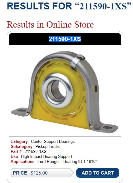

    Appreciate the feedback on the CB vs 1-piece. I am still leaning towards a 1 piece even after $140 on that one for the ford ranger. I made some calls at lunch and I'm going to get a quote on a 1 piece after work today. Regardless, I will rebuild this one and keep it as a spare.

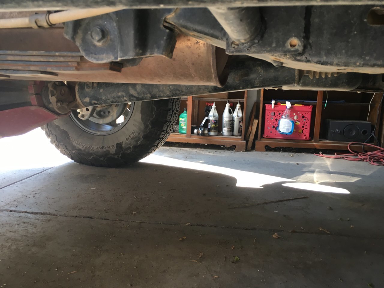

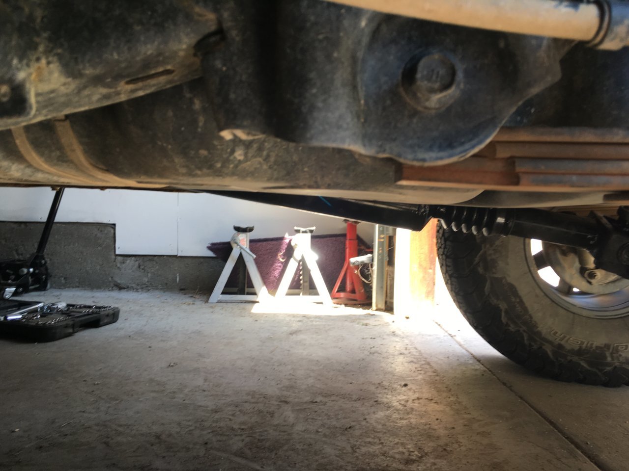

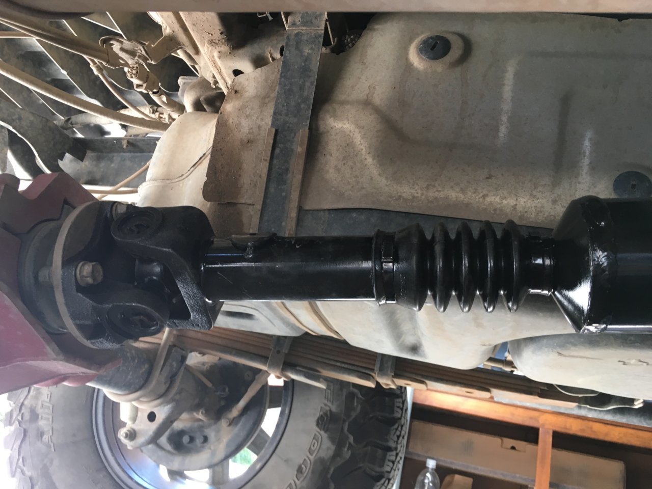

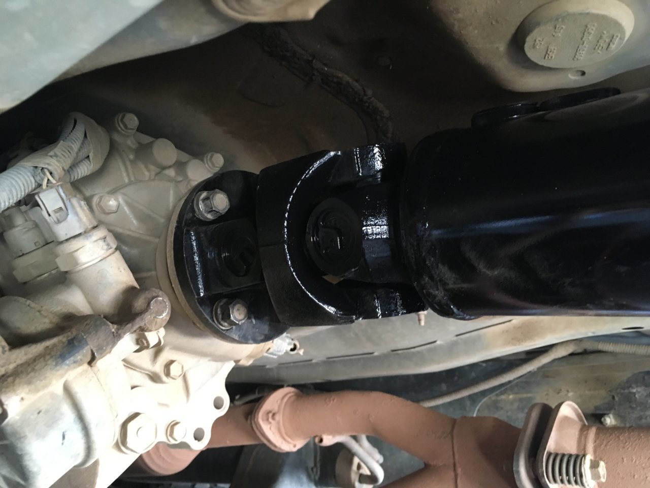

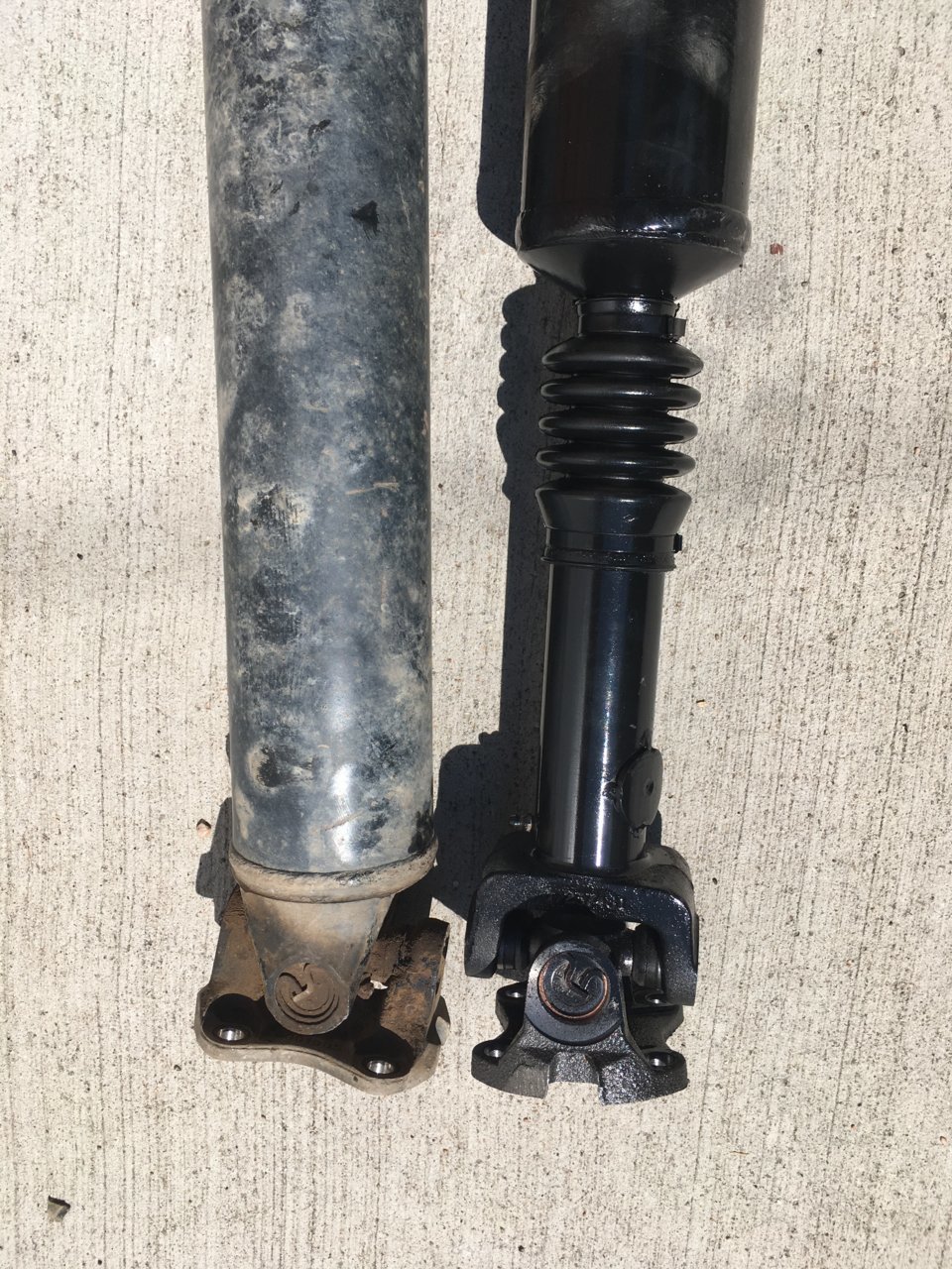

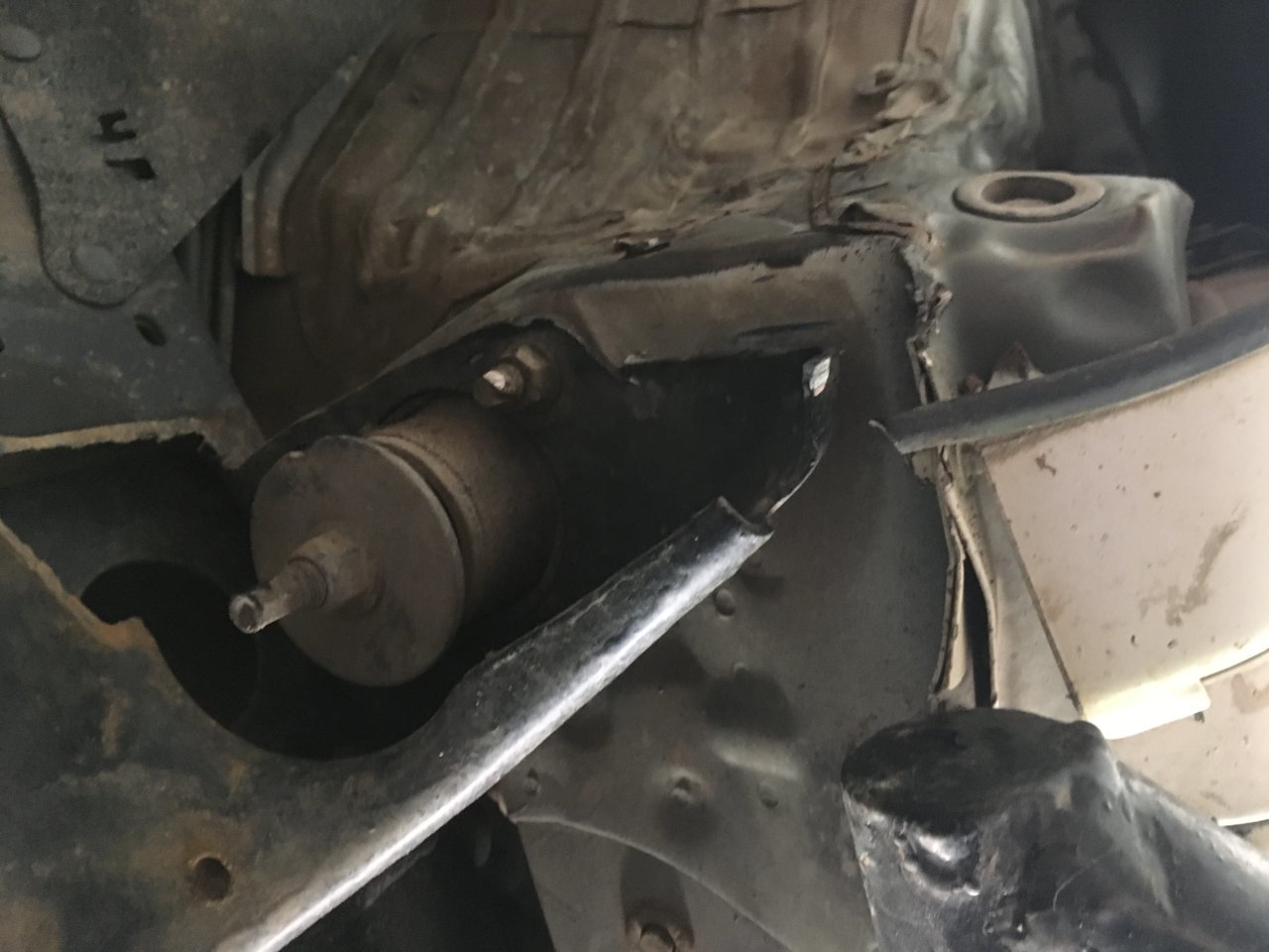

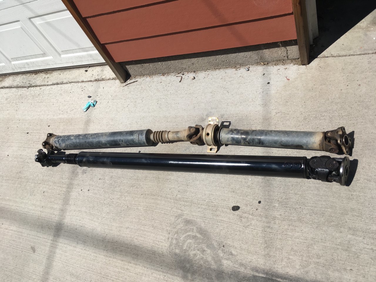

    Picked up and installed my 1-piece double cardan from Bills englewood driveshaft (https://m.billsenglewooddriveshaft.com/)
    I love their slogan...
    “You can’t beat my shaft!”
    I really can’t tell any difference in clearance. Hangs about as low as the factory one as far as my eye can tell.
    5D030482-586B-4B6E-8F25-8FAA269A5754.jpg 1B0EF5DF-AC78-4E9D-BF9A-2D3C60107BD8.jpg
    BD1D1A9D-22CC-46F3-BF58-EC5512E005A4.jpg C01F843F-ECDE-4714-9642-B87098A896F3.jpg
    And the best part is, no more launch vibe! I forgot what a proper drive train is supposed to feel like.
