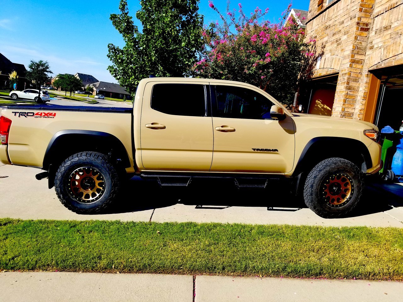

    5100 NOT maxed out, with an AAL in back... very close to level, only a slight rake.... 285 KO2sTaco.after1.jpg

    Not maxed? But 4th notch? Stock coil? And stock uca?
    Looks good. Im going for about the same set up.
    How does it ride compared to stock
  18. Oct 23, 2017 at 6:40 PM
    #218
    RebelliousOne
    RebelliousOne Well-Known Member
    May 27, 2016
    #188023
    154
    Cliff
    Frisco
    2017 Tacoma TRD Off-Road 4x4 DCSB, previous 2016 TRD Sport 4x4 DCSB
    4th notch, stock coils and yes, stock UCAs. Between the slight lift and the taller tires it sits nicely...
    I love the ride.... I haven't trimmed anything, so if i turn left sharply or stick it just a little to the left, I do get some rub... but otherwise it's good to go... I will probably end up trimming back a bit...
    Therby likes this.
