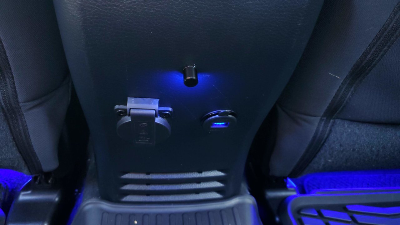

    Got mine completed today, works great! Glad to have it now, I was tired of running a 6ft cable from teh dash to the back seat to charge the ipad the kiddo watches on our hour commute three times a week.
    Not finished in this pic, but you get the idea.

    Nice gear there. Probably the best surface mount I’ve seen so far.

    you got to give us details on that 12v set up, its nice, matches the 110. more pics ...
    i love the setup

    Please post your part numbers on the three outlets there.

    The 110v outlet is in my post from Amazon very cheap 2pk under 10$

    ZRM&E 2pcs 15A 125V Electrical... https://www.amazon.com/dp/B07QHT19M7?ref=ppx_pop_mob_ap_share
    Electop Dual USB Socket Charger... https://www.amazon.com/dp/B077MC3L3B?ref=ppx_pop_mob_ap_share
    yep! It works great
