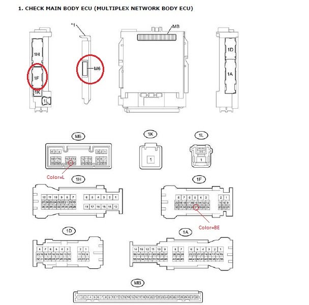

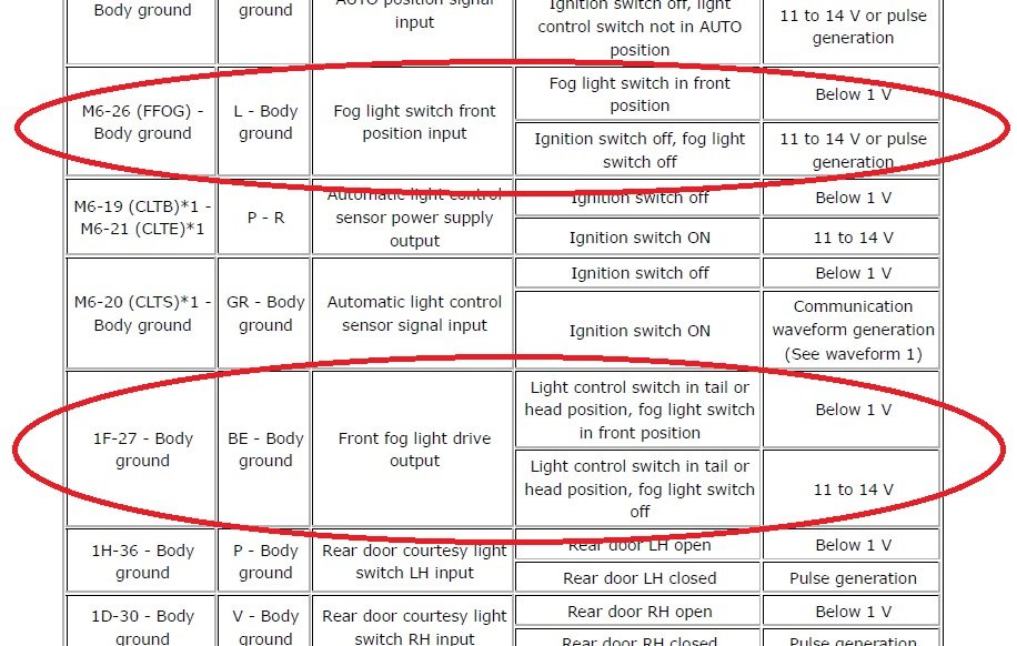

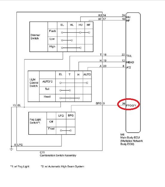

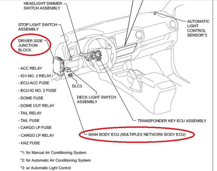

    I have not done it; don't want to...but I think I figured it out. Maybe it'll help...
    Basically, you need to get at the Main Body ECU and Driver Side Junction Block.
    Splice together the wires from terminal (1F)27 and (M6)26, bypassing the ECU.
    My thought is, the fog light control is open in the ECU whenever HU14/HU24 is grounded via the headlight dimmer switch.
    My only pause for concern is the last pic; it shows voltage on those terminals when tested against body ground in the "OFF" position. There shouldn't be anything on those; it's just a switched ground.
