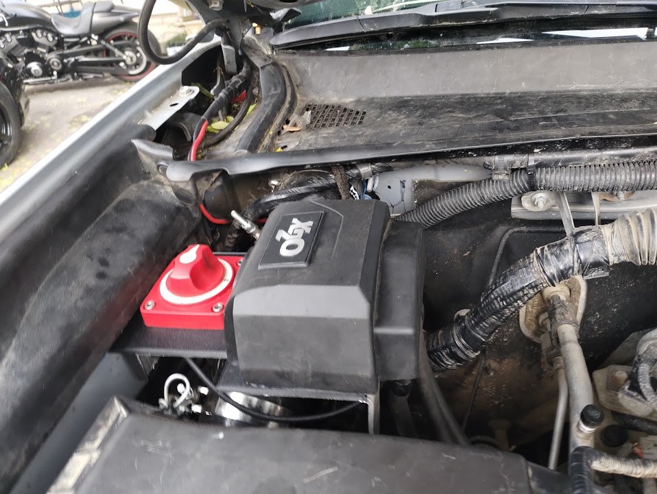

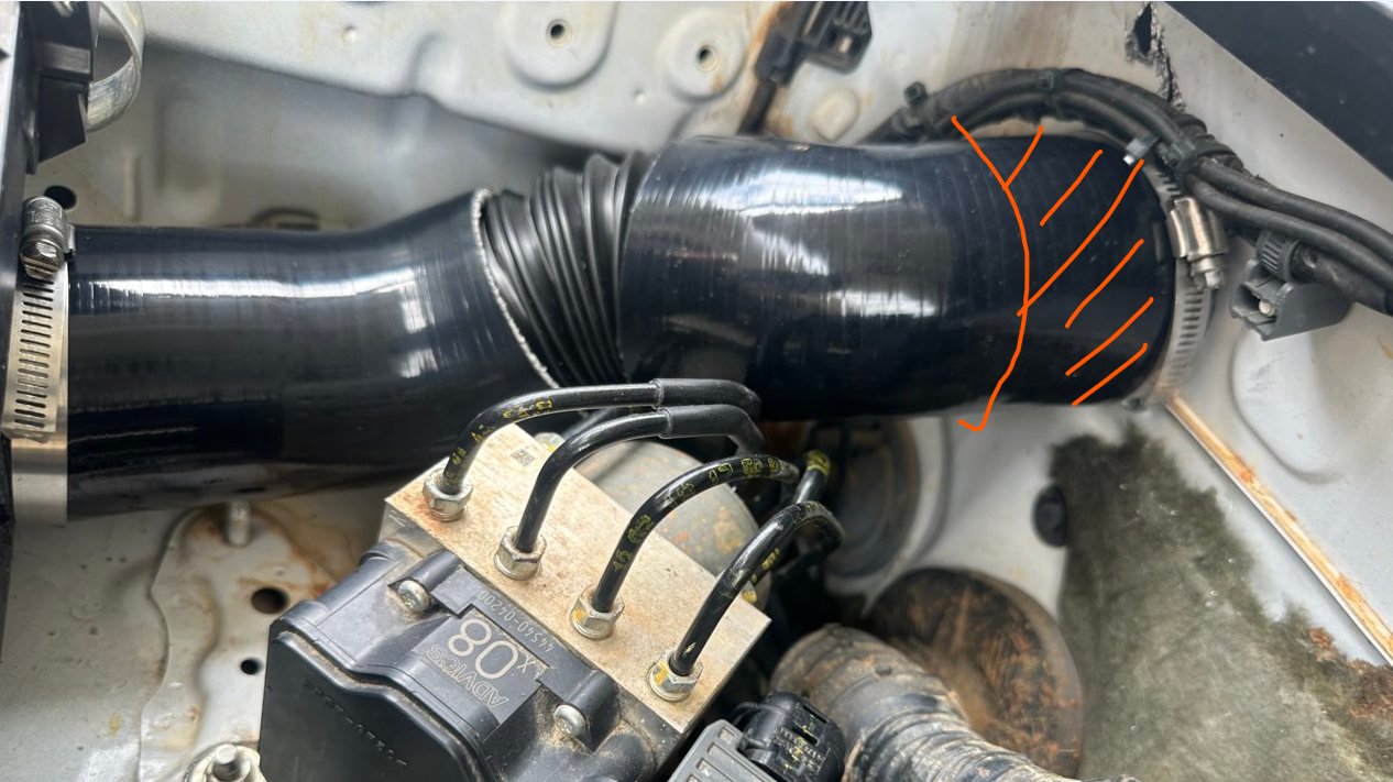

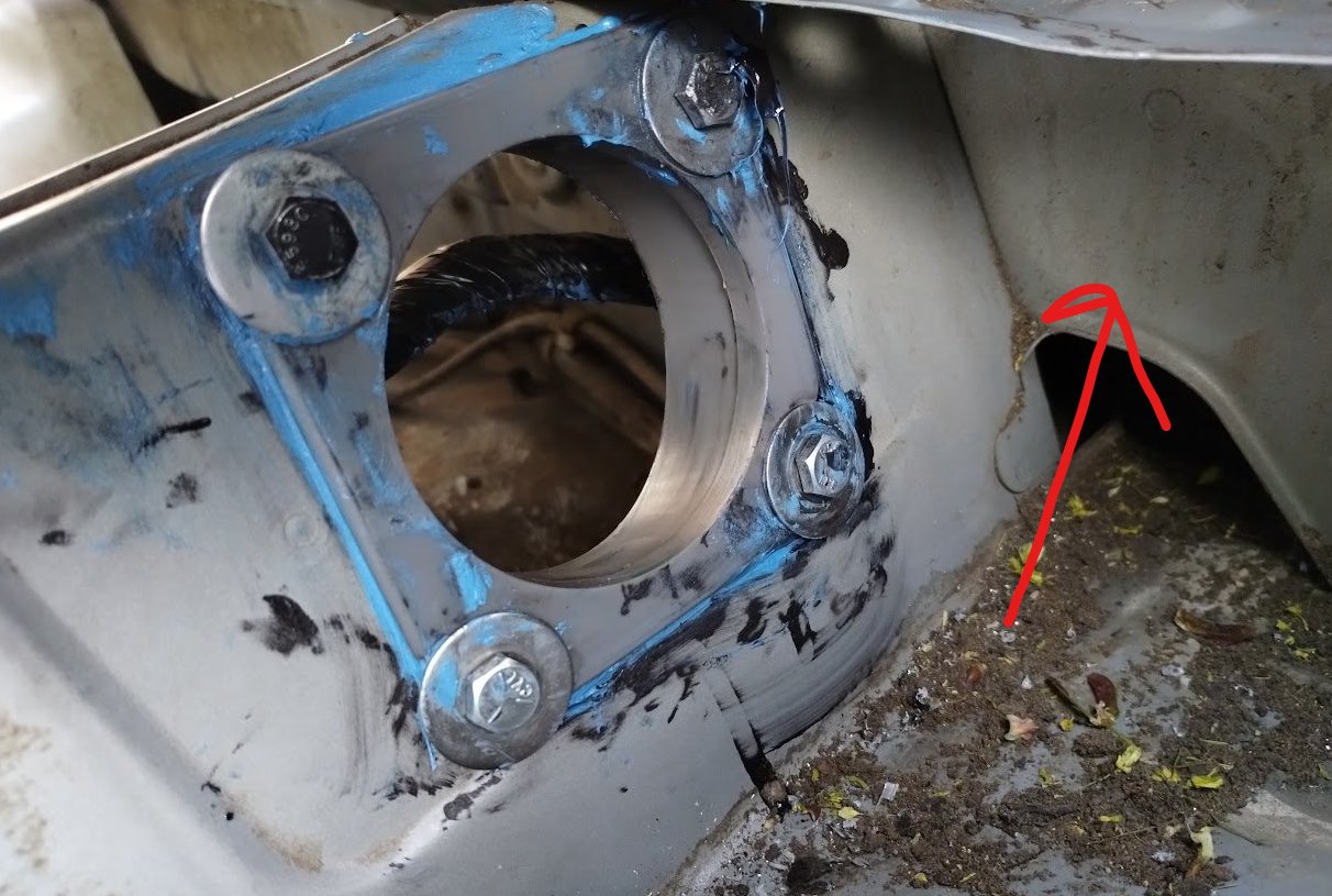

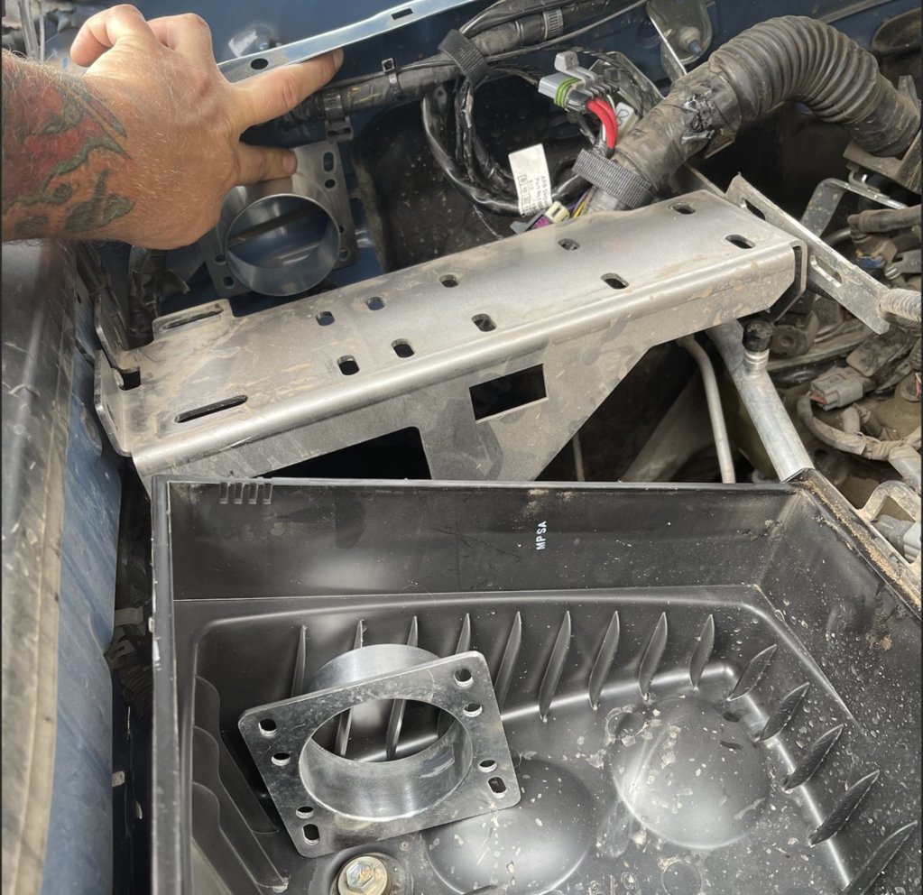

    Continued the project and learned some stuff (mostly how to 3D print).
    V7 i think was printed in PLA+. Did not hold up after 3 weeks baking in the sun. Reprinted in PETG which should hold up a bit better overall.
    PLA+ melted in 35c+ heat soak. ( granted was printed with 20% infill unlike the 60% i did in PETG.
    Overall there is a full inch above the X20 winch controller, so would need to snap off before hitting the underside of the hood

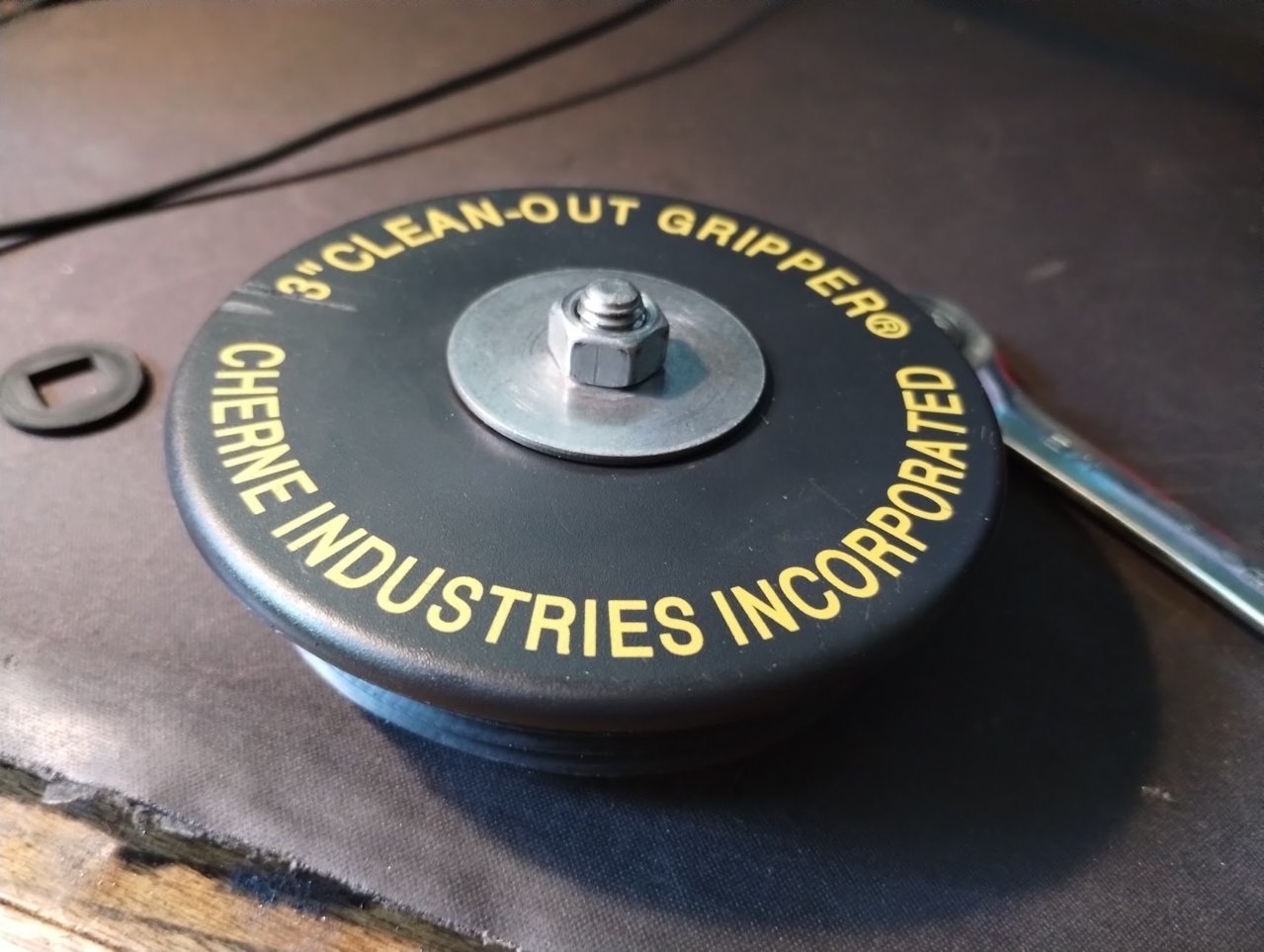

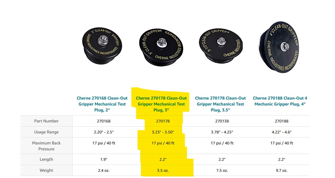

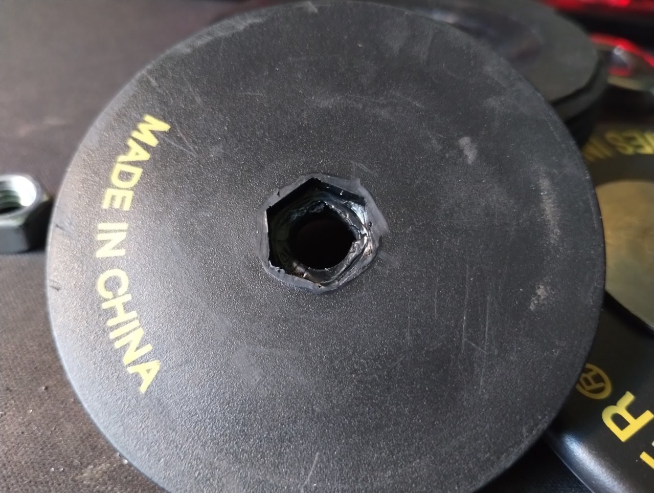

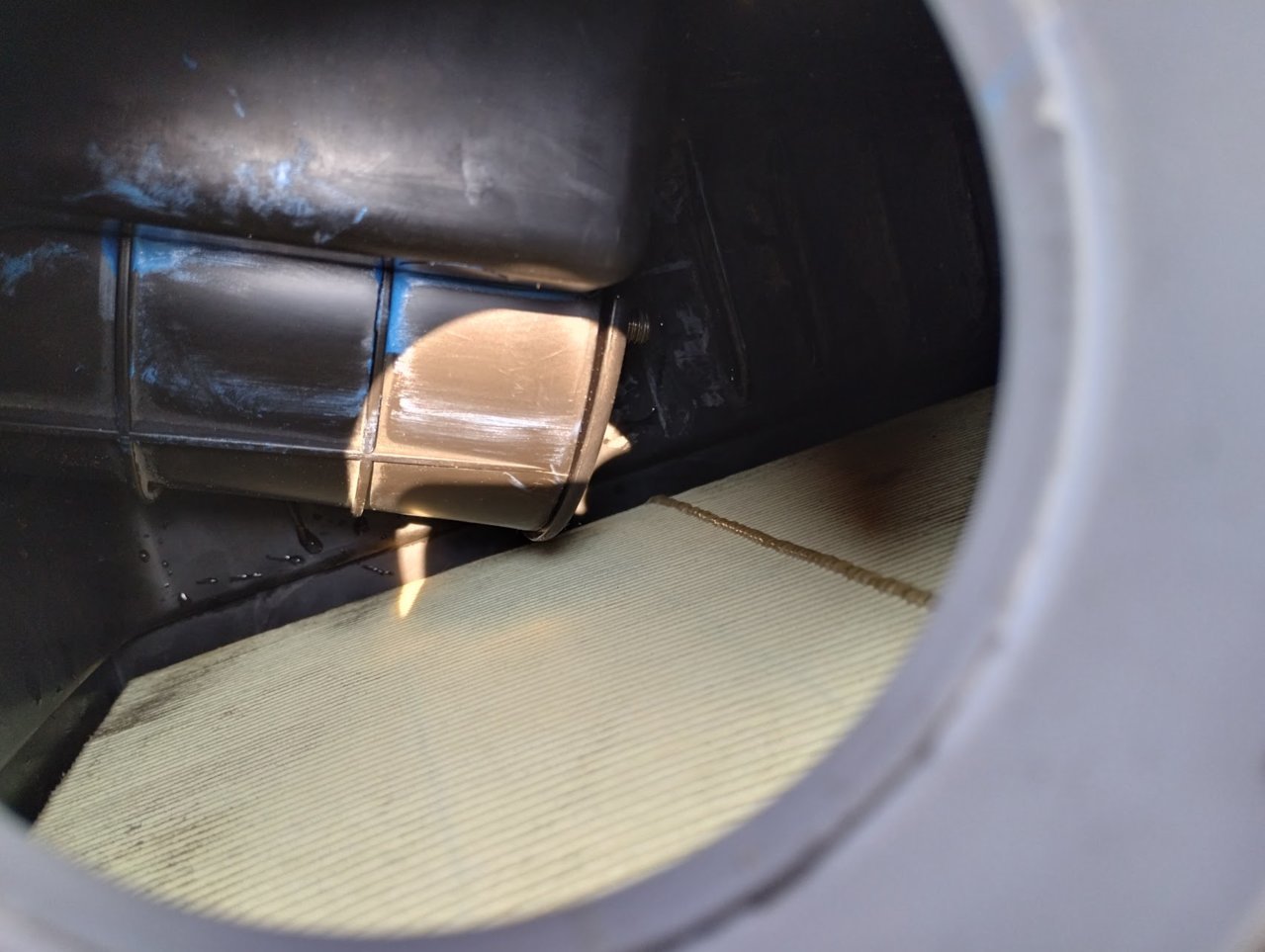

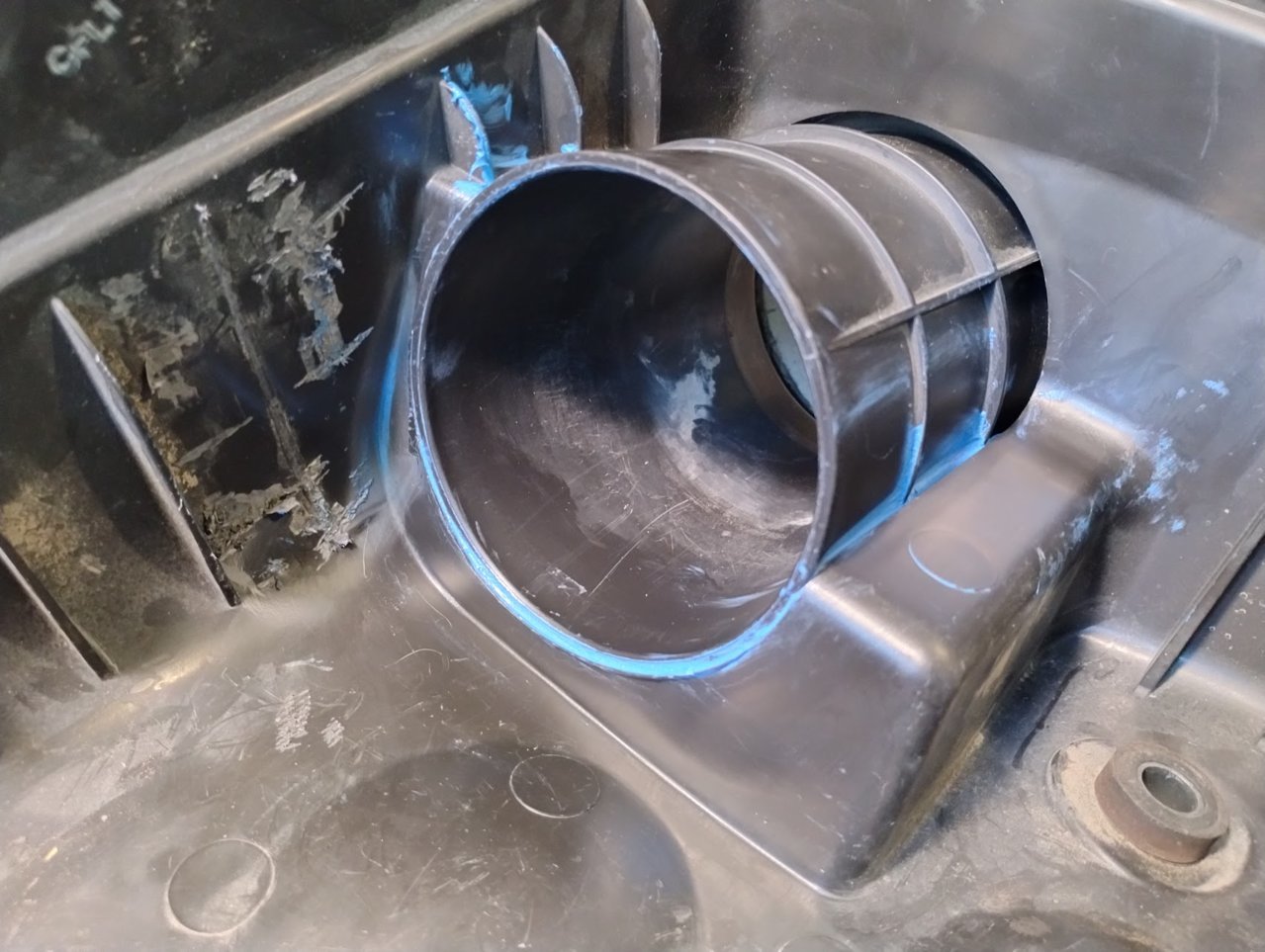

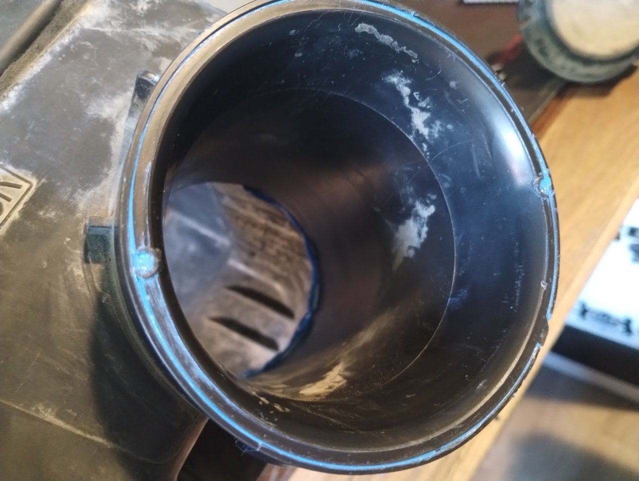

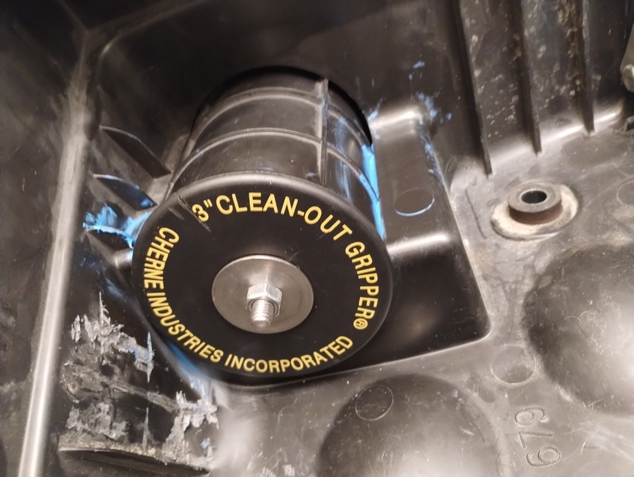

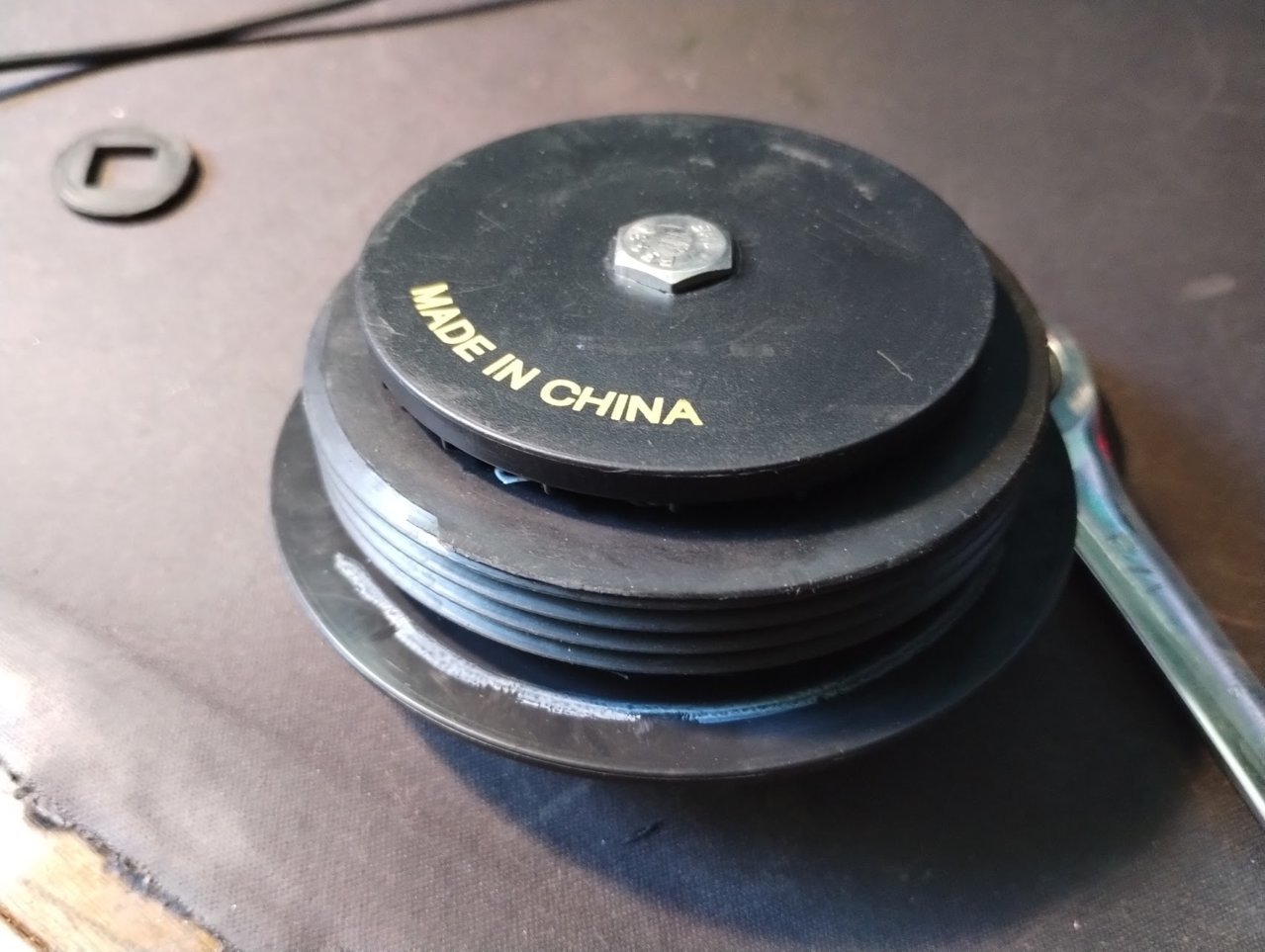

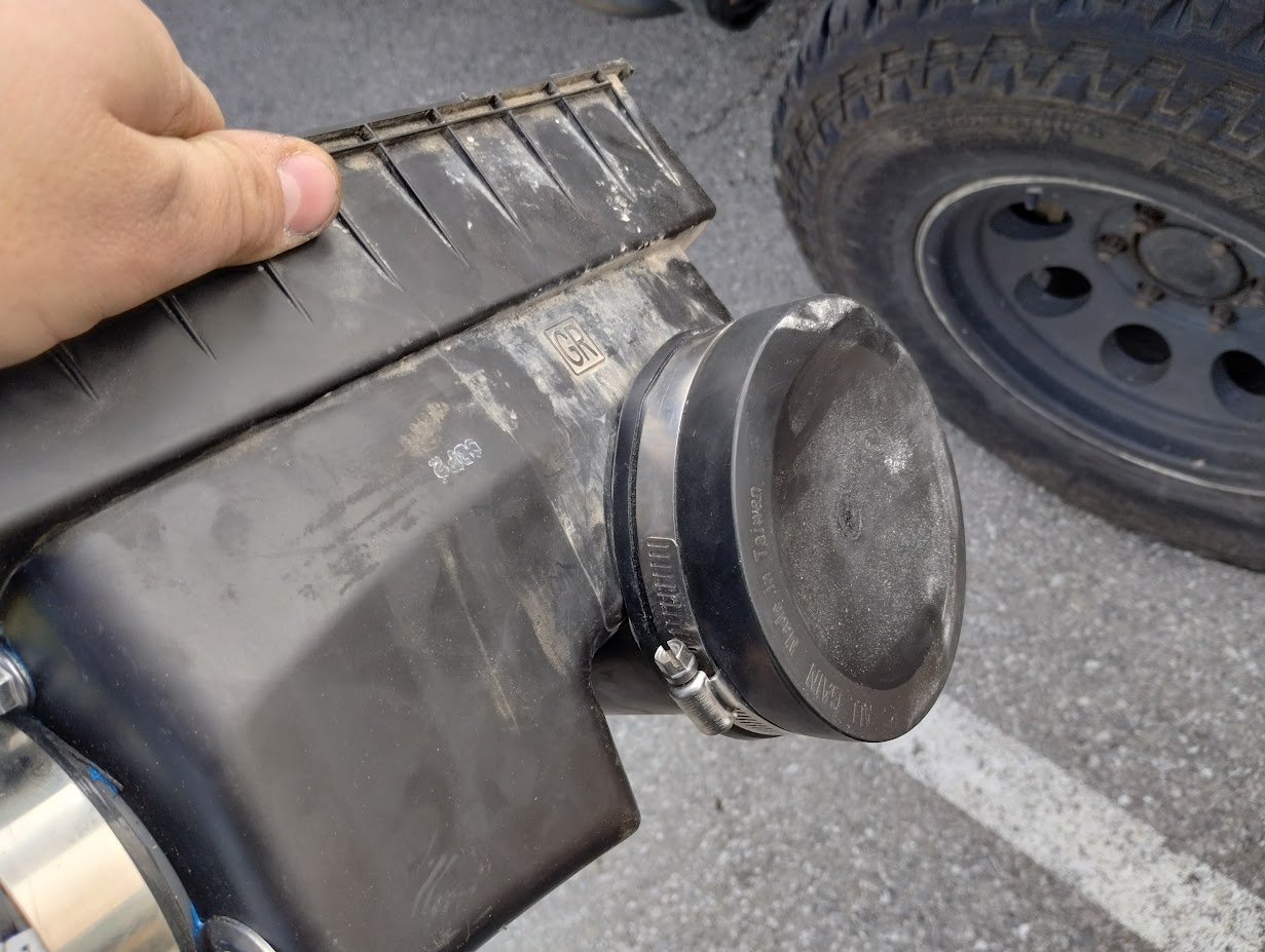

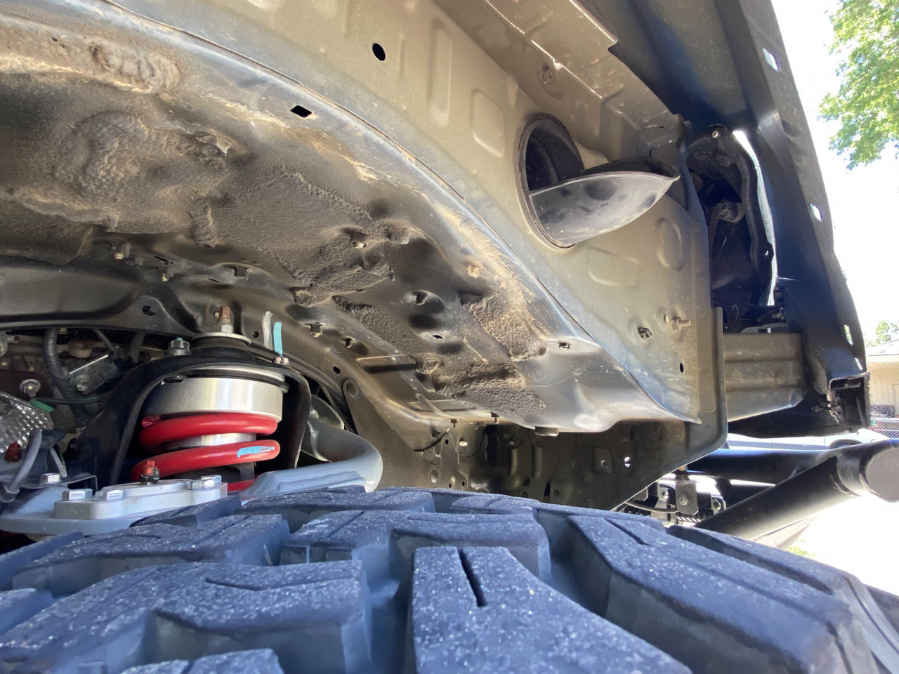

    Found a plug that will let us seal the 3-1/2" oem intake instead of taking it off. This way we can have both the oem intake for highway driving, and the snorkel for crossings/ in the dirt. This solves the issue/ concern of any input lag from too little air getting to the engine from the 3" induction pipe
    It's a 3" to 3-1/2" pioe plug that expands out and grips to the inside of the pipe instead of a traditional cap that grips the outside.
    Parts and tools:
    Stuff i got was all from Amazoom:
    https://www.amazon.ca/dp/B000VYL5CC?ref=ppx_yo2ov_dt_b_product_details
    But you Americans can get your hands on the same thin from Home Depot:
    https://www.homedepot.com/p/CHERNE-Gripper-3-in-ABS-Mechanical-Cleanout-Plug-270178/306895666
    So According to Amazoom, the 3" version of the mechanical plug expands from 3-1/4" to 3-1/2"
    I HIGHLY recommend removing the Nylon washer that comes with it and replacing all of the hardware with something nicer - the Stainless that comes with this stuff was fairly rough/ crunchy and basically used a blow torch to heat up the head of a bolt and force in a new slot to capture the head of it.
    Reason being i recommend this, because once you squish the system to the 3-1/2" diameter we need it do, the nylon washer compressed and slipped into the hole with the screw. so when it came to unbolting everything, it jammed up HARD.
    had to take a grinder and cut off the hardware it came with.
    also threw in a fat 1-1/2" fender washer to help it out a bit more.
    Glued the OEM intake funnel with the same RTV silicone that i had laying around to try and water proof it slightly and also to keep it in place
    And yes, lots of room remains to the OEM paper filter
    As it';s a mechanical compression bond, it shouldn't budge but i've marked it with a paint marker and gonna keep an eye of it to see if it moves for the next week. otherwise, should work

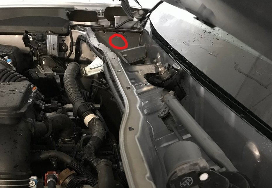

  4. Jul 25, 2023 at 10:36 AM
    #184
    honkonbobo
    honkonbobo Well-Known Member
    Sep 5, 2018
    #265270
    935
    Eric
    SW Ontario
    2021 ACLB TRD OR 6MT
    yes exactly there. planning to put a hole in both sides.

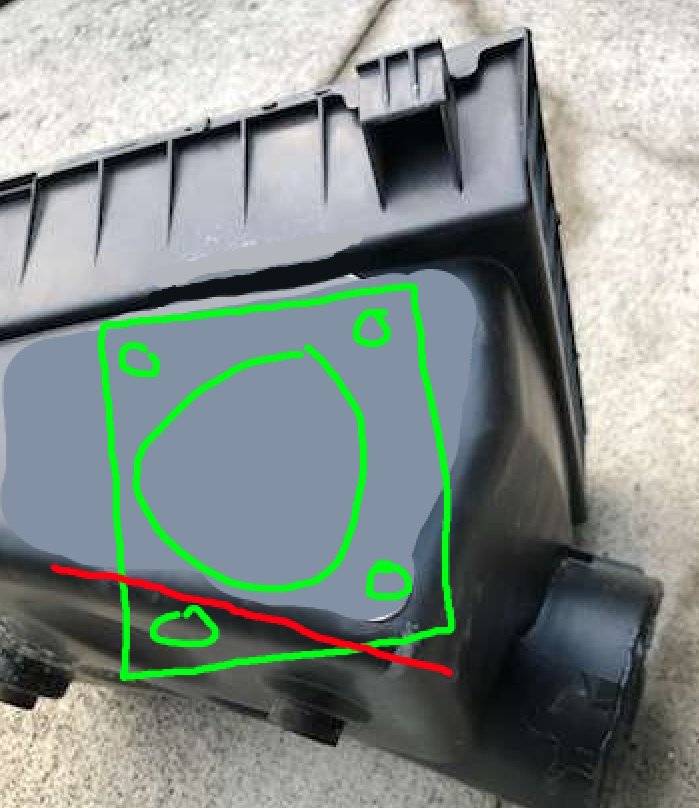

    Thinking of up sizing this to a 4" ID variation
    1. ($38) one 4" 4-Ply Reinforced Straight High Temperature Hump coupler hose
    2. ($32) one 4" 4-ply 45 degree elbow coupler hose
    3. ($32) one 4" Mounting plate (Spectre 91489) ||| (alternate $12 4" plastic mounting plate(Spectre 9148))
    4. ($45) one 4" Spectre Performance 9775 flex boot
    For the hose, either go the 4" aluminum/ stainless straight pipe or go with a 12" length of the 4" silicone hose
    my concern is the 4" hose collapsing but i can't imagine that happening unless a vacuum is created, so i think the silicone would be more than enough. could also get rid of the bends as well as you would just cut the hose to fit the mounting plates

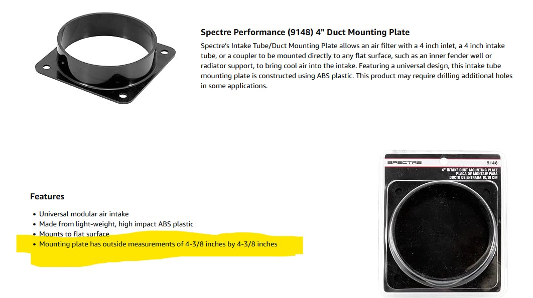

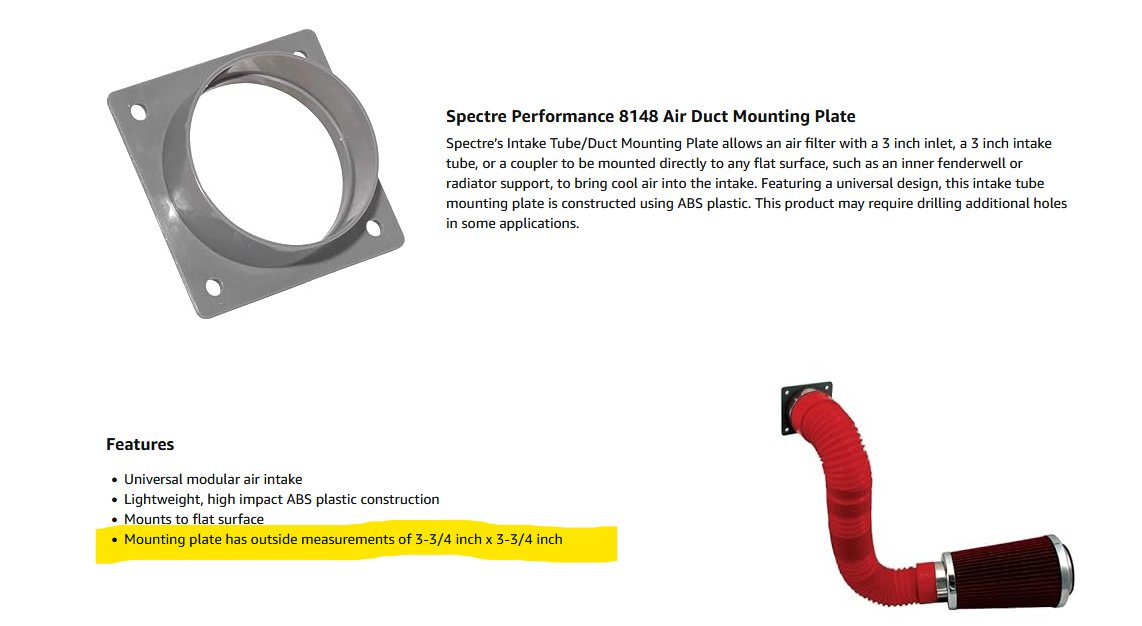

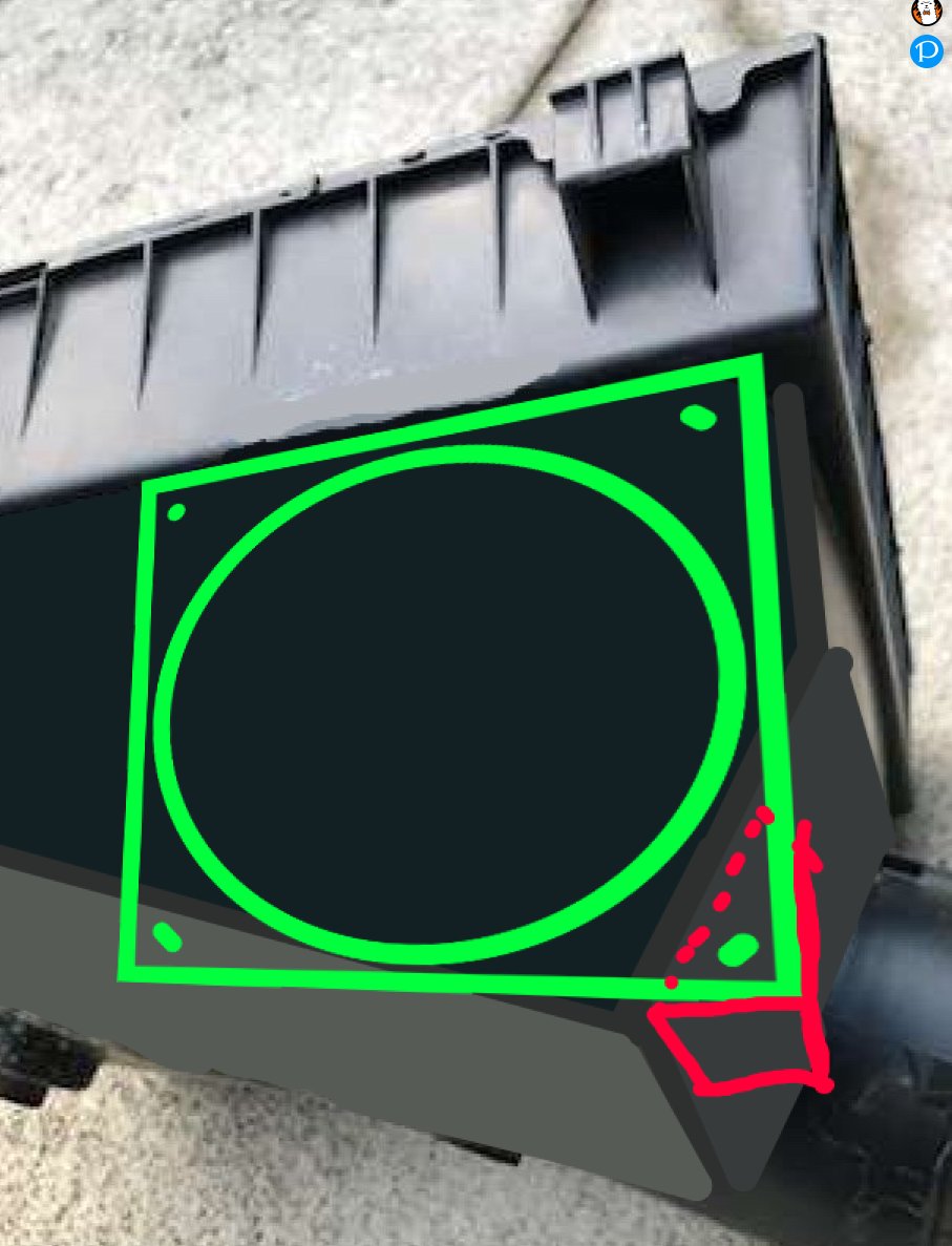

    My largest question is mounting the 4" hose to the airbox from the outside.
    according to Spectre their 3" mounting plate has an outside diameter of 3-3/4'" by 3-3/4"
    whereas the 4" plate has 4-3/8" by 4-3/8"
    So technically we wont be able to mount it inside the airbox, but we'd need to figure out a way for the outside.
    thinking maybe a 3D printed wedge on the outside to bolt into..

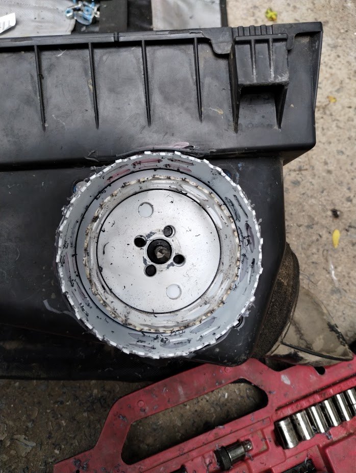

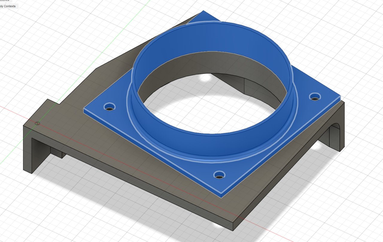

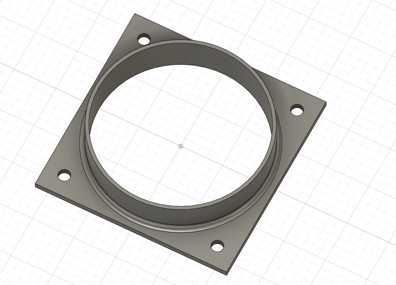

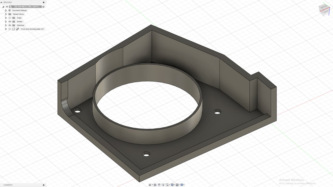

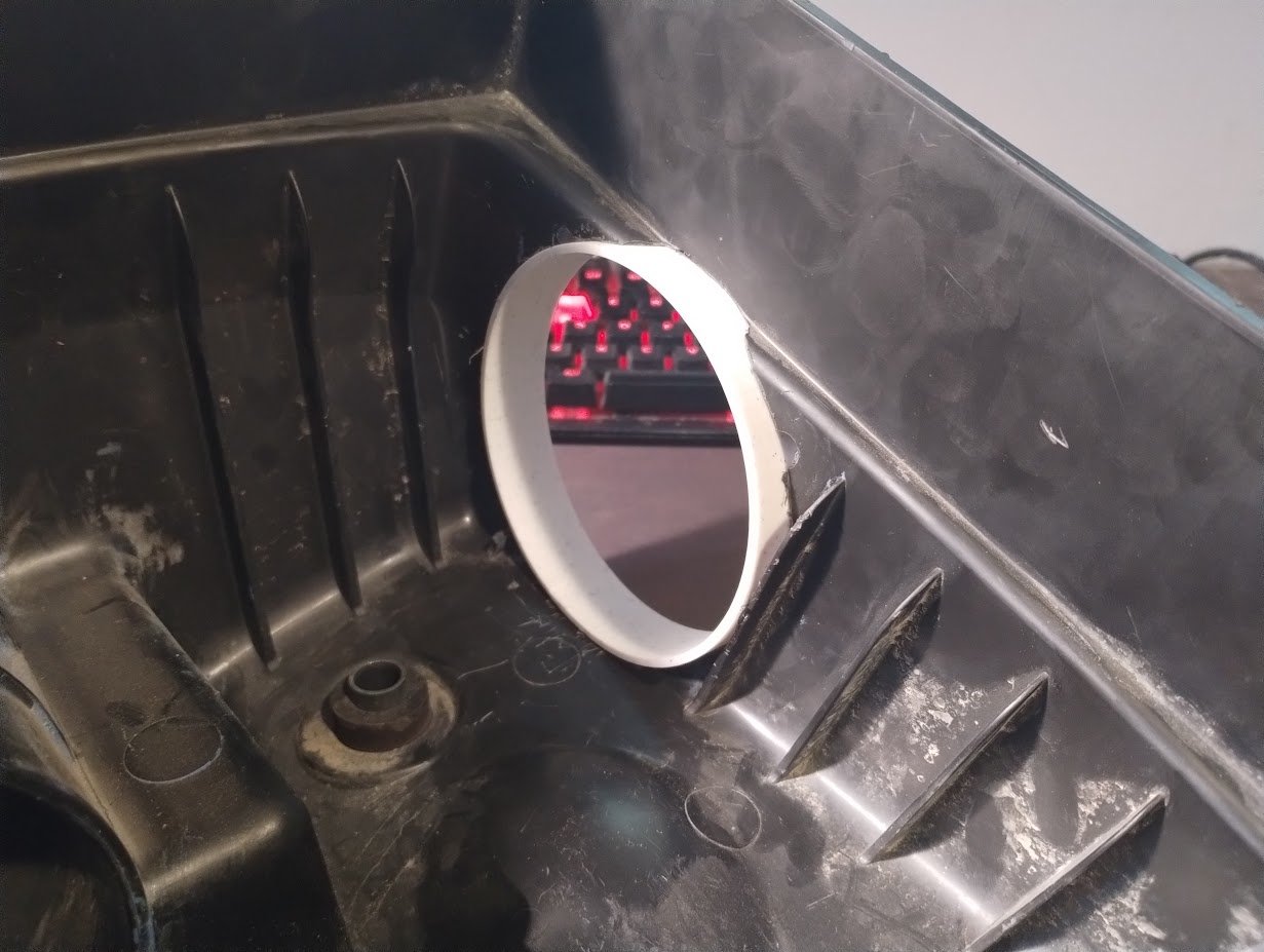

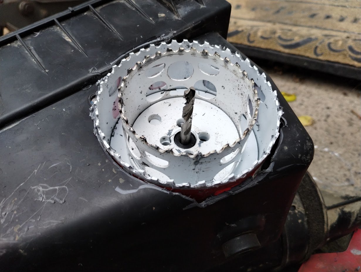

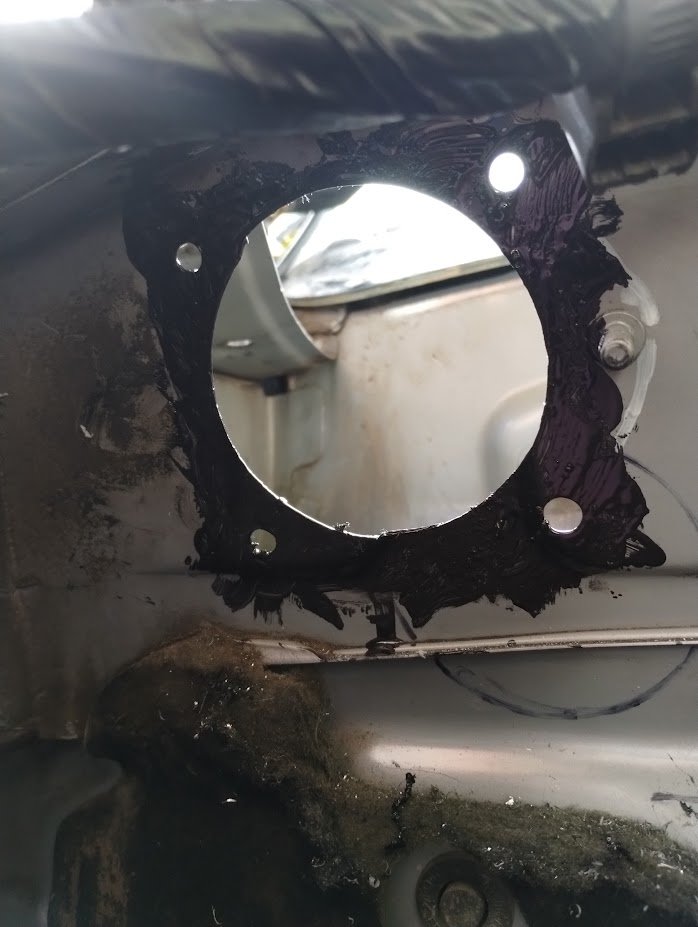

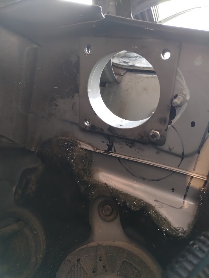

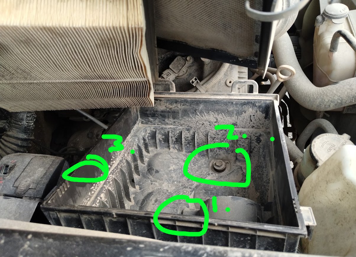

    I managed to find a spot that the 4inch holesaw carved though without much issues.
    as discussed, there isn't a way to mount the hose to the inside of the air box, so what i'm in the middle of working on is a fancy cowl adapter that shoooooould work. This is V2, just refining some stuff on it;
    V1 is on the 3D printer now to get a decent idea for fitment.
    Also i realized i can just 3D print the mounting plate, just did some minor alterations to the 4inch plate i used for the standing A/C earlier this summer...
    you can see the 3 and 4 inch ducting mounting plate attached, it's basically a carbon copy of the Spectre 8148 and 9148 plates
    idea is to print off 2 of the 4"duct mounting plates, one for the cowl and the other to attach to the air box adapter like so;
    this will make printing much easier and less wasteful (mostly faster)
    with this way, the part list was reduced
    going to try a 4" straight pipe and just need two 4" stainless hose clamps

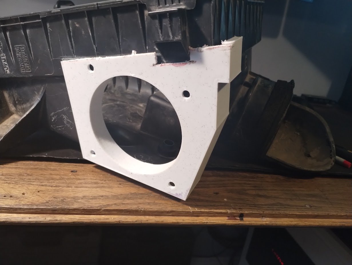

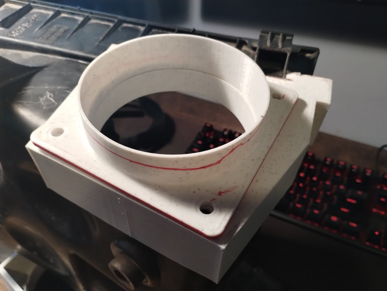

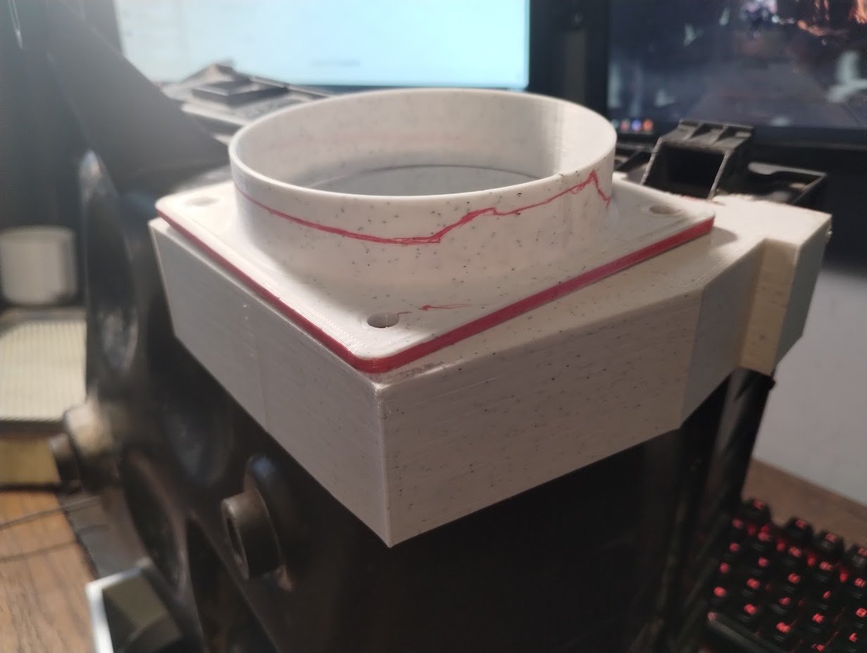

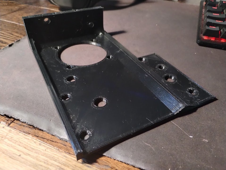

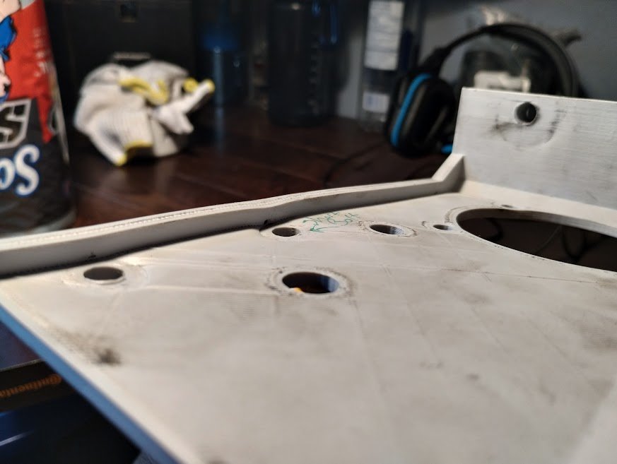

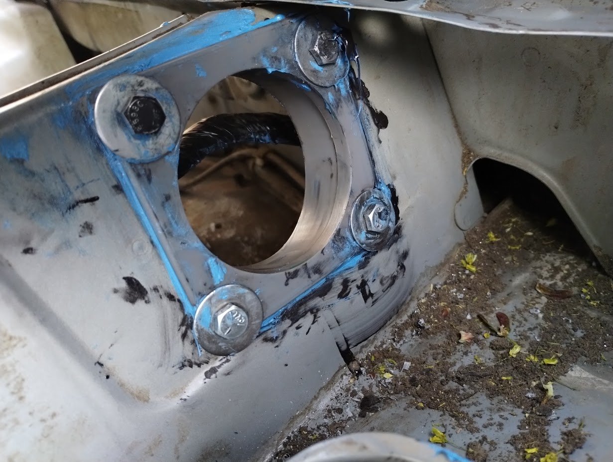

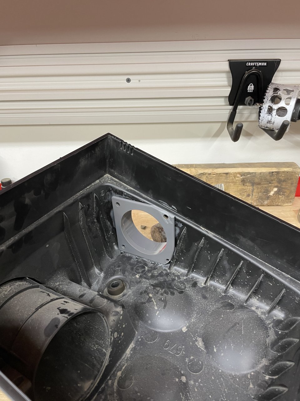

    V2 Printed, Concept works and the last little bit of fitment is known.
    IMG_20230925_174627009.jpg IMG_20230925_174632766.jpg IMG_20230925_175319028.jpg
    Just need to make some design considerations and dimensions changes and i should had a PETG/ ASA print done before the end of the week at this rate. Plan to upsize the Airbox hole to let a 4" holesaw nest into and have it as a guide for anyone doing this first time. @TacoPandaTRD Overall i think this will work. Just will need to bond the bracket onto the airbox somehow, PL supreme Glue should be super good enough right? :D
    CemenTRDgen, Tacodog and TacoPandaTRD like this.

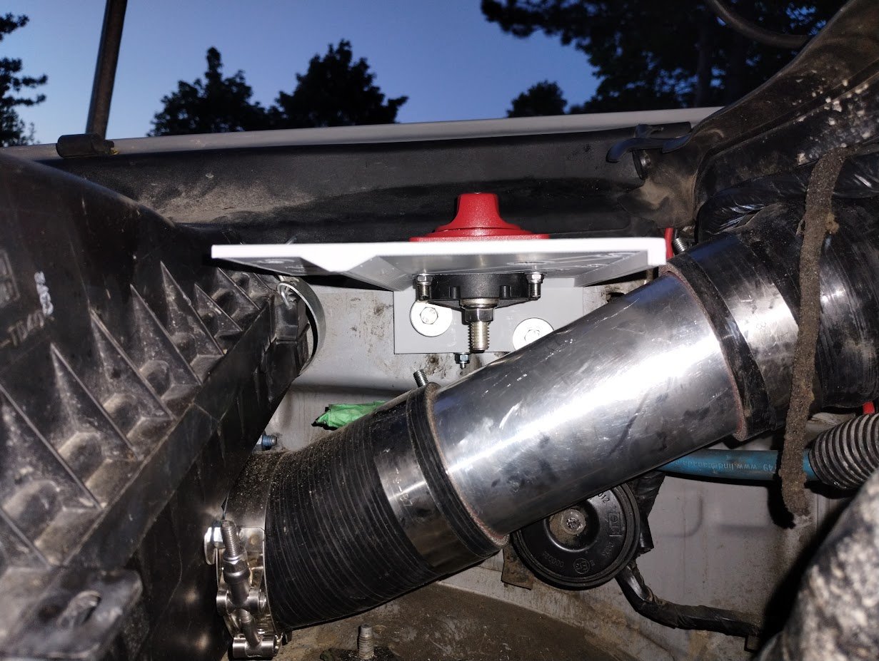

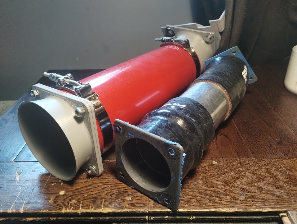

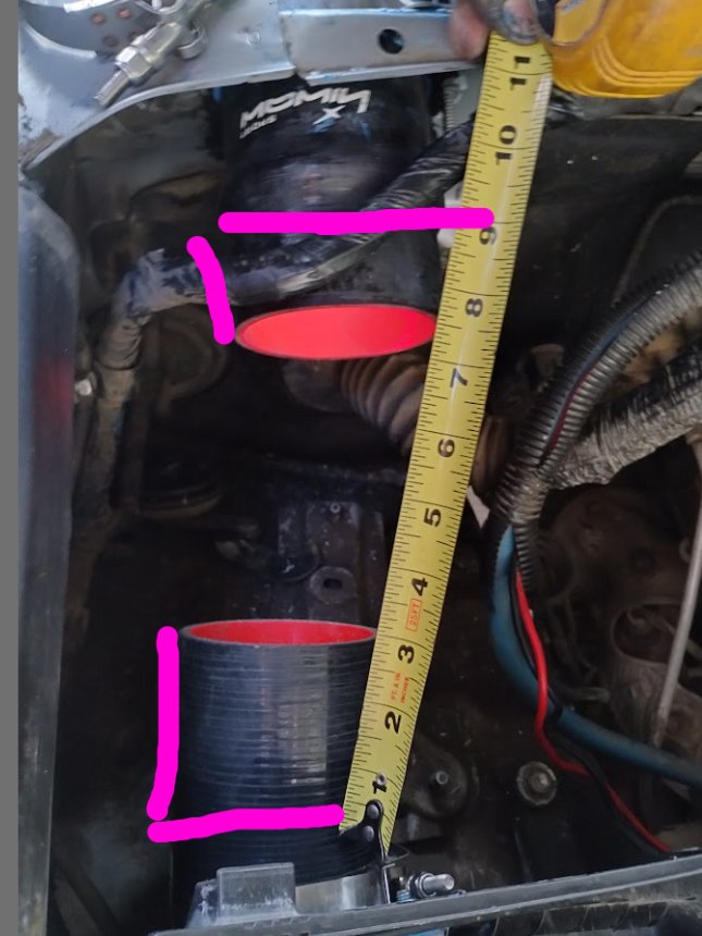

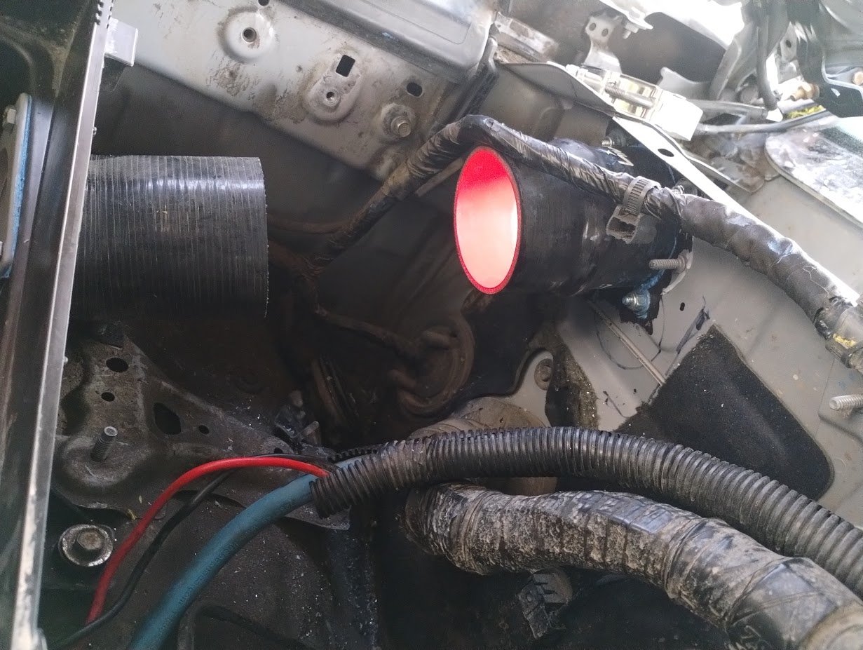

    update:
    You Vs the the Snorkel she doesn't tell you about:
    Parts list:
    two Stainless T- Clamps
    4 inch x12inch long straight silicone hose
    3D printed stuff:
    4inch Trumpet intake
    4inch mounting plate
    4 inch bend mounting plate
    cowl adapter
    Plan to mount it and test it today
    but this version is stupid cheap, $65 on amazoom and then a spool (about 100m according to Cura, so 300ft) of PETG+ like $30. so $100 in material costs (implying you already have the 3D printer)

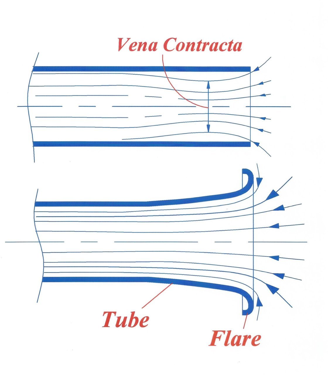

    the intake trumpet is a special use-case, optional but i think really good to have. Like earlier there was concerns of water getting in, the sort of acts like a lip.
    but also does trumpet stuff, like whatever this important diagram says

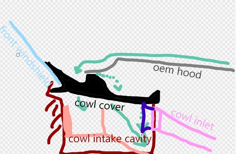

    I thought the cowl was an area of high pressure and aided in induction though? (I'm not an engineer :anonymous:) definitely open up the sides of the cowl though
  19. Sep 29, 2023 at 7:00 AM
    #199
    Shveet
    Shveet joe-shmo
    May 28, 2018
    #254719
    6,406
    Own-tario
    2018 shitbox
    fluid/air dynamics and all of this voodoo to me, i have no idea how the trucks work or what goes where and how much of it. i'm just winging it like everyone else with basic surface level knowledge and just shitting on Toyota's millions of dollars into R&D thinking this is "better" than what they did.:bananadead: I just look at it and think "yeah, this is super good enough" and call it a day.
    as @3JOH22A mentioned in the Ontario BS thread
    so yeah, good point about opening up the sides
    Brownmatthall[QUOTED] likes this.
