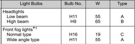

    From the owners manual. TRD OR has the wide angle, H11 for 2020 double cab.

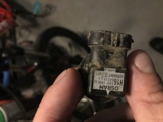

    okay. Looks like there are mistakes. This is what I had pulled out of the fog lamp from the factory.
    So they are H16, Toyota’s owners manual is wrong.

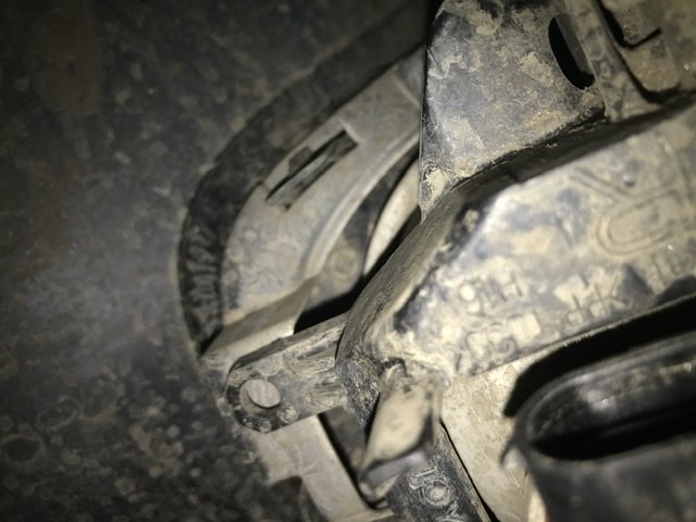

    I was able to get my phone in there to take a picture, SOMEHOW, and this is the Amazon H11 led cheapie light installed on the passenger side.
    Note this is upside down.
    what you can’t really tell from the picture is that I’m not 100% sure one of the tabs actually went into the slot before it rotated. I would think it would be way off and easily noticeable, though, if that were the case. So, I’m not sure. They are fully plastic so maybe the cheap plastic construction allowed it to fit just fine? I’m not sure.

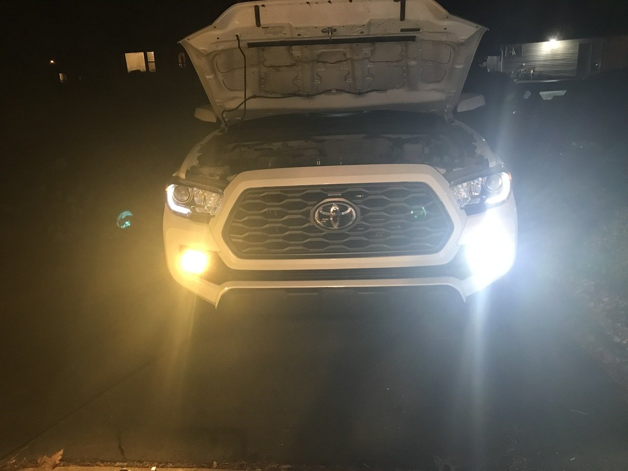

    I did but with the better fogs I can get around town with just the fogs on. We have streetlights everywhere. I’m basically treating my headlights for highway use or high beams. Once they burn out they’re going into the trash.

    Oh I almost forgot about this one too. From when I was dicking around trying to get a picture of the light in the housing that might be seated improperly. Bulb size is stamped on the housing. H16.

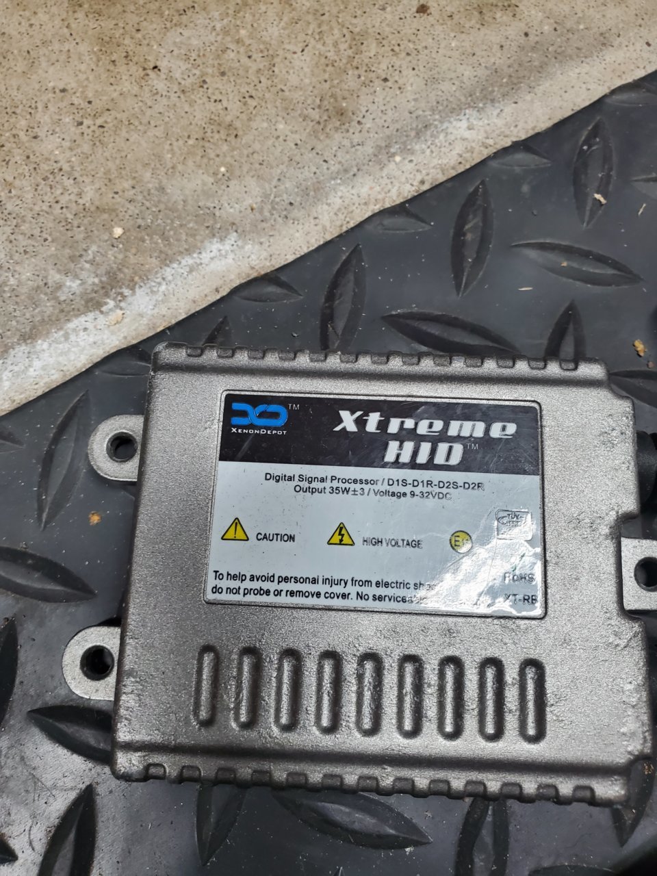

    I've had the XD xtreme HID's for 3 years and my brother on his taco for 1 year. They've held up beautifully. They were a bit pricey at the time but well worth it.

    20201128_205711.jpg these if anyone was curious
