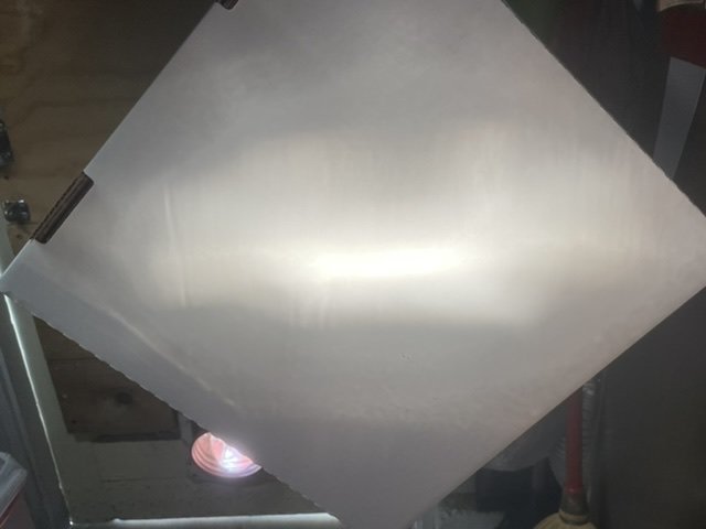

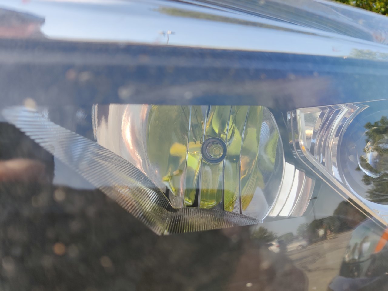

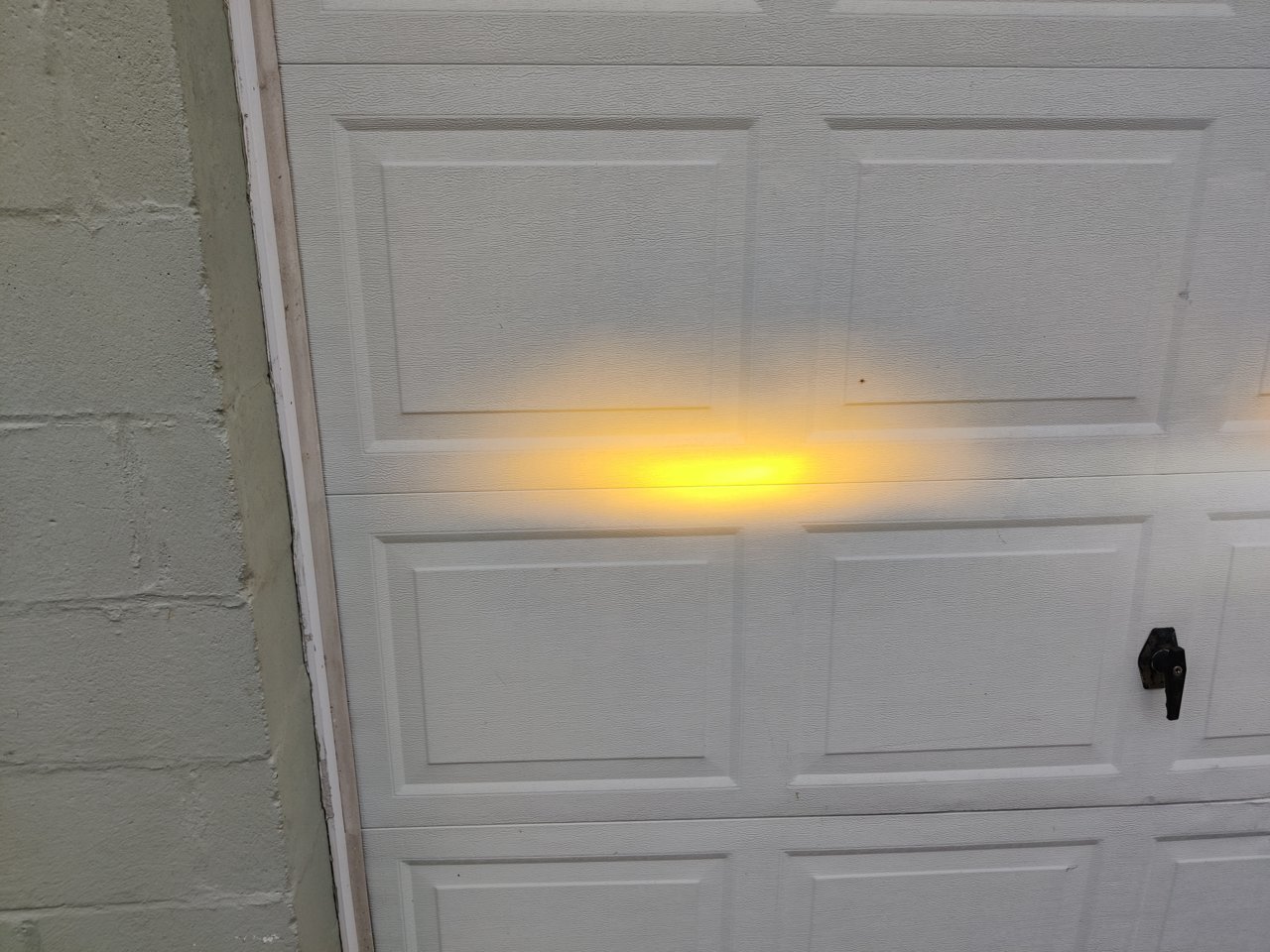

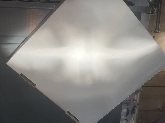

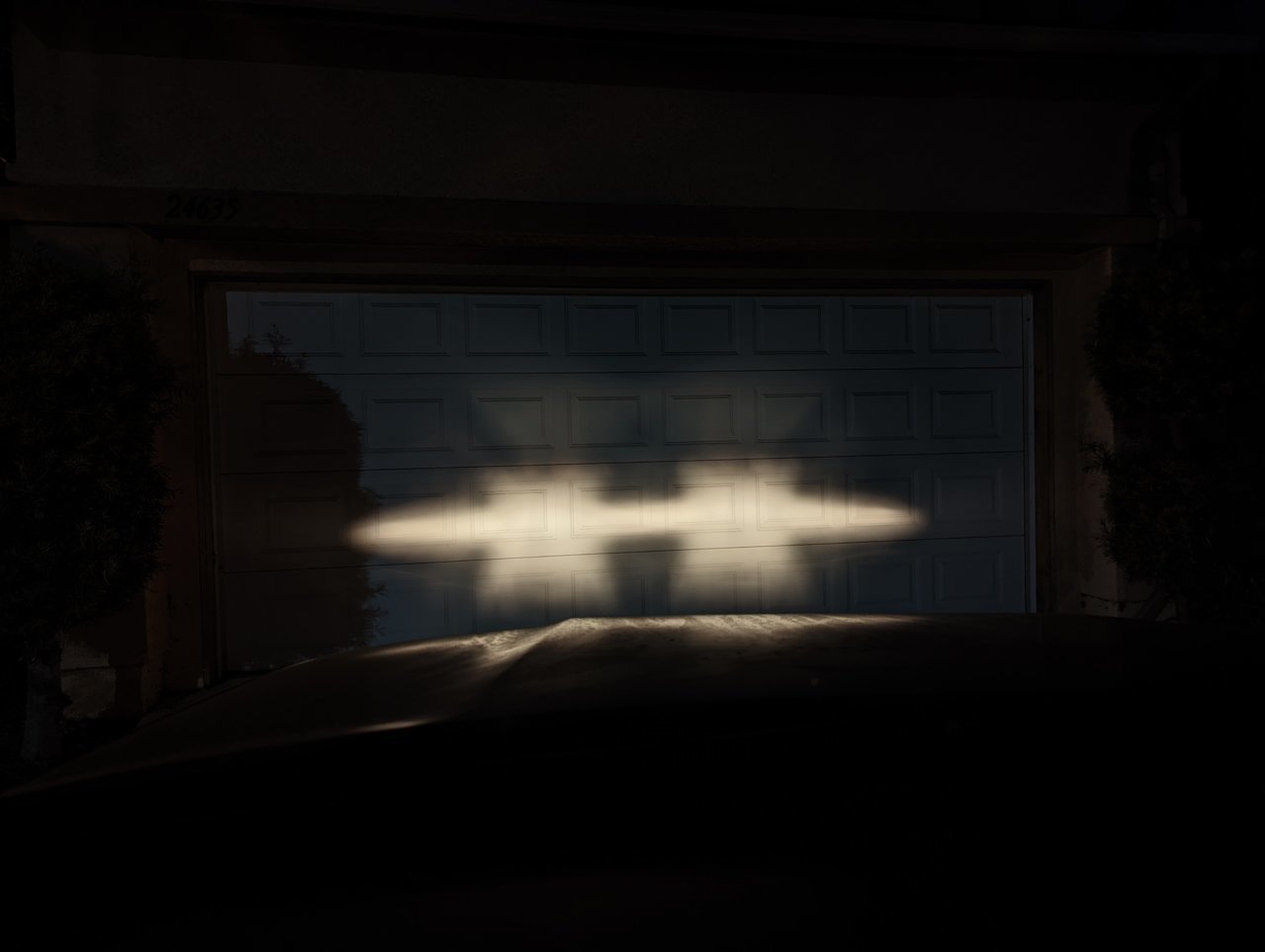

    Interesting development over at 4runners.com
    @ElectroBoy and @replica9000 have taken pictures to show the apparent difference in the reflector beam patterns for the new bi-LED headlights. For the older halogen reflectors that are DRL and high-beam, they have a distinct hotspot that overlaps with the low-beam with a flood pattern above.
    The new headlights with bi-LED projectors and DRL only reflectors appear to have a different pattern- more of a box or X-pattern, that adds foreground light below the main hotspot.
    So it was presumptuous of me to assume that the reflectors are the same across the board. They certainly look the same in the housings. Strange that Toyota would bother to update the optics slightly, without addressing what seems to be the major complaint of them still being "ugly halogen" DRLs.
    Since the pattern has changed, I don't think it's wise to assume that they are useful or safe to use as primary high-beams. To be fair, the bi-LED projectors with shutters are supposed to be the primary high-beams, and adding full brightness to the reflector housings for a quad high-beam effect is not the intended purpose. Something to consider.

    • For 2021 low-beam only, appears to be no change (Replica's are 2021 LED low-beam and appear to have the "old" style reflector, his are the Nokia hyper yellow above).
    • For 2021+ bi-LED headlights that elect to ignore the shutter in favor of halogen only high-beams, there may be a state of non-compliance or a pattern incompatible with requirements for high-beam. I don't know enough to answer definitively.

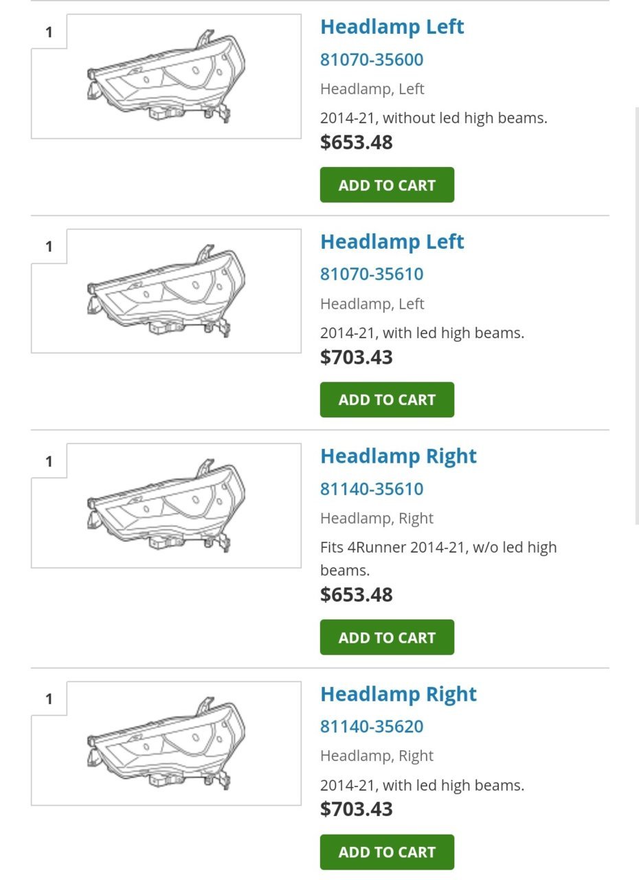

    Interesting. It kind of makes sense to change to a wider dispersion pattern if you are still using the halogens for the DRL feature exclusively. I wonder if the older reflector is available separately for anyone wanting to bake open their lamps. Or is there a part# difference between the two sets of headlamps?

    replica9000
    replica9000 Death to AI!
    Apr 6, 2008
    #5782
    16,447
    Lake Chargoggagoggmanchauggagoggchaubunagungamaugg
    2019 T4R ORP
    These are the part numbers

    Parts are not available as sub-components of a headlight assembly through Toyota, so you'd need donor assemblies. The Bi-LED high beam performance isn’t very good compared to the halogen HIR upgrade high beam in the LED low beam only assemblies, so it seems like a lot of work for modest gain.

    I would think no. The bulb for the high beam fits directly in the back of the housing, so the high beam reflector is a part of the housing itself.
