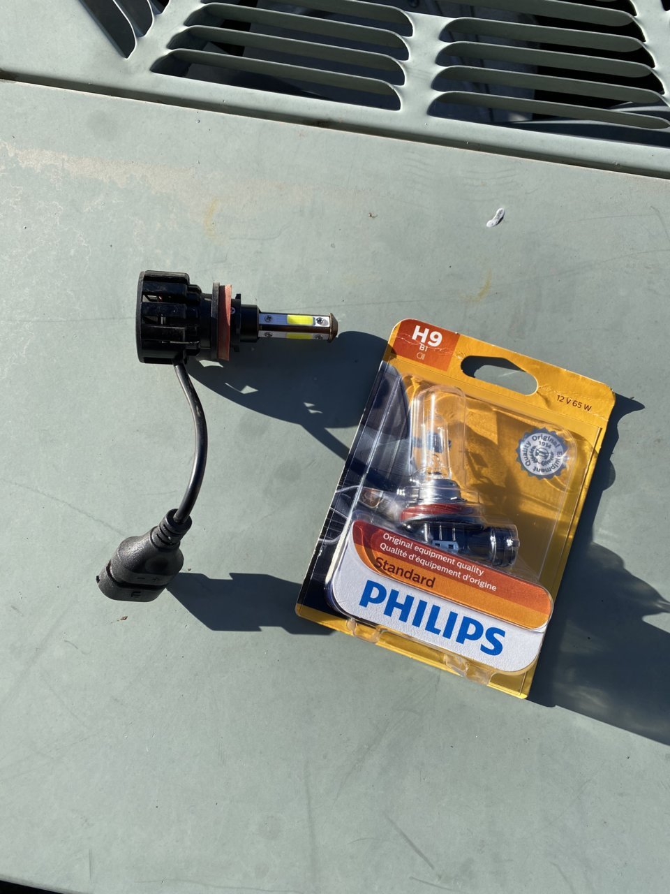

    I just ordered the Philips H9 to go in my lowbeam headlights. Will do the install this weekend. I’m looking forward to seeing the difference.

    Made the swap in the low beams today. Elected to trim the tab in the light instead of removing the green connector. Did no trimming to metal tabs as crash showed they can fit if put in a certain way

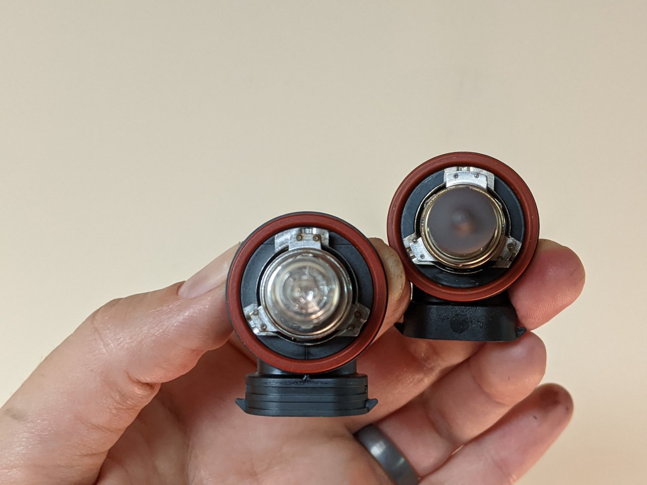

    Hey @crashnburn80
    I ordered the Philips H9 12361B1 bulbs on Amazon to replace my H11 halogens in my '21 SR5. I've trimmed the tabs off to fit the H9 connectors but the metal tabs on the bulb base do not match my H9s and they do not fit into the housing. Do I have the wrong bulbs or is there another step here that I've missed? I ordered on Amazon from the link posted and they sent me German bulbs. Apologies if this has been covered somewhere in this megathread. Here's a photo:
    New H9 is left, old H11 is right.

    The tabs are different but they will fit with the right angle. Alternatively you can trim the top tab on the H9 to fit much easier.

    Thank you very much for the fast reply :bowdown:
    Ok awesome I'll work on them a little more to see if I can get them without trimming, figured I'd ask before I broke something.
