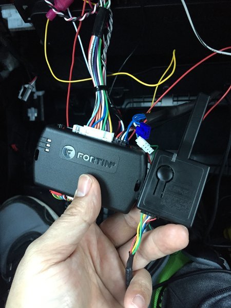

    Install done, works great. I have no electrical experience. I initially used the tap splices and couldn't get it to work. The people at Voodoo were great and answered the phone sunday morning at 11 when I called. They walked me through a few steps as well as telling me to T splice. I did that and everything worked great. These forum's are great, people like @GoGoStAm and the people at @KBVoodoo make this stuff so easy for even the novice Tacoma owner. Thanks again.

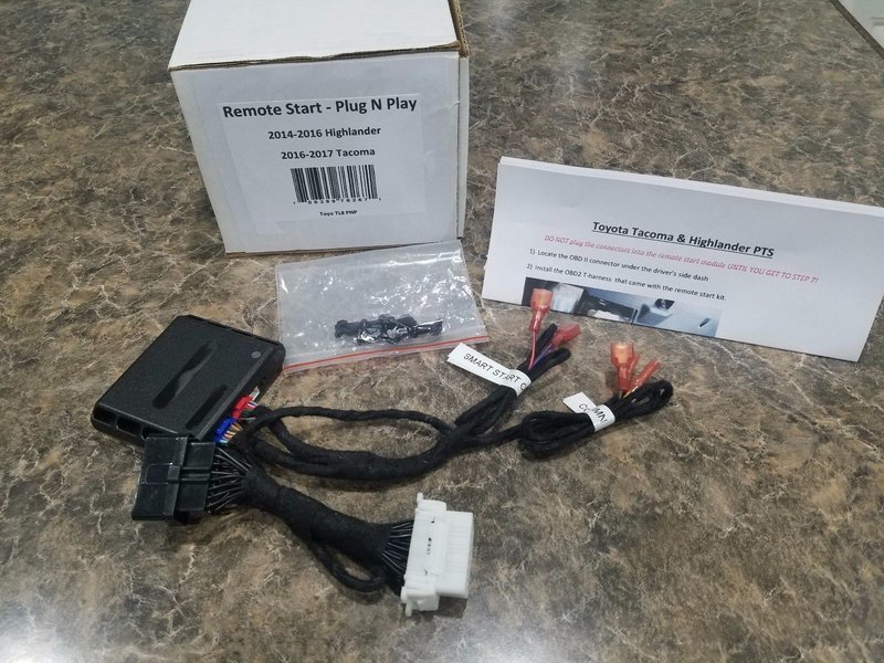

    got my remote start installed the other day. can control with factory fob or mobile app via smart start. purchased the only true 95% plug and play system available. they hope in the next few months to have a complete plug and play system. id highly recommend it for your tacoma. see below for install writeup, purchase location, and in use videos
    great guys to deal with!!
    truck is a 2017 tacoma PTS
    available at:
    http://www.ebay.com/itm/272510643020?_trksid=p2057872.m2749.l2649&ssPageName=STRK:MEBIDX:IT
    and https://www.12volt.solutions/collec...coma-highlander-plug-play-remote-start-system
    **mention Matt or midvale496 when purchasing**
    *****USEFUL LINKS*******
    INSTALL WRITEUP https://drive.google.com/file/d/0BxMd_h2OfnBxVnBDeVpEcEtzeEE/view
    smart start mobile use video:
    https://youtu.be/oSSx4l2fULE
    factory fob use video:
    https://youtu.be/pkpFvYRLDdQ
    enjoy

    Looks like that's the @FullMotionHT unit also referenced here. Good on him for figuring out that the DBALL2 will work with an alternate configuration from the manufacturer's instructions. Using an OBD2 harness and pulling power and ground from it instead of the other locations is a great idea to save three factory harness connections.
    Not sure how four wires tapped instead of nine is 95% but whatever.
    BTW, glad you liked my SmartStart module install location. :D
    Why? What do you get from people mentioning your name or Youtube handle?
    We also have the lower priced @KB Voodoo option, using the same DEI DBALL2 module, who is a TW Vendor supporting the site. Or the even lower cost roll-your-own DBALL2 option I wrote up.
    It's a nice thing that folks have options. Let's not cloud the picture for the TW community with marketing-speak.
