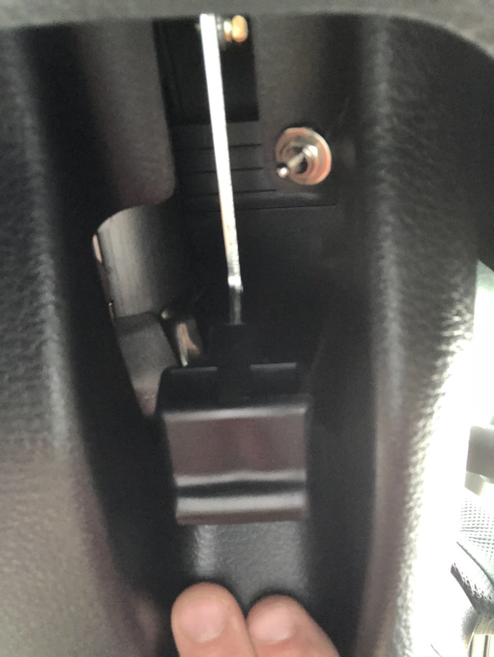

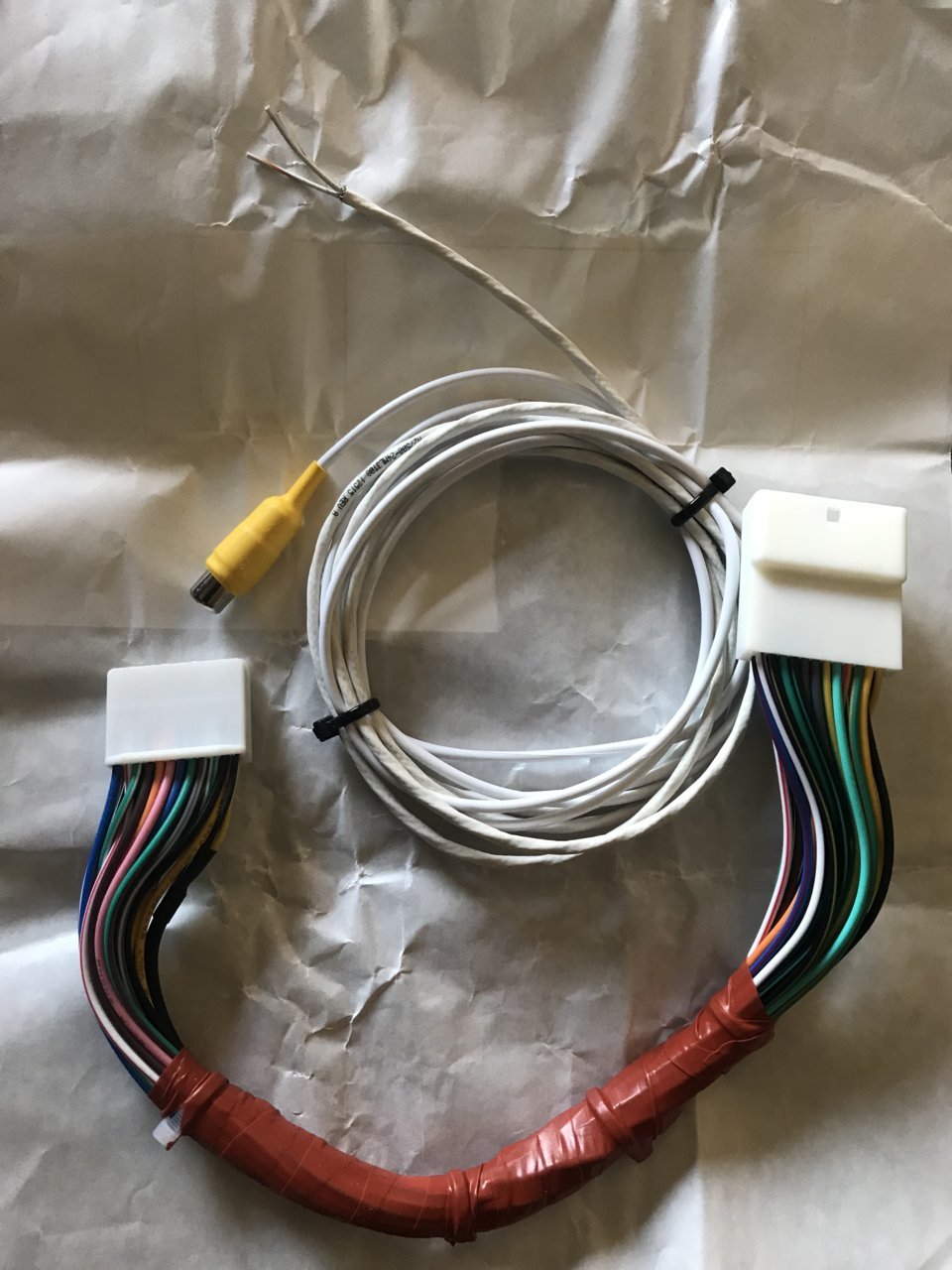

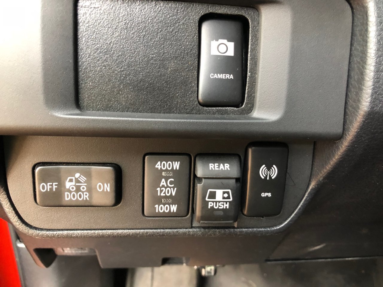

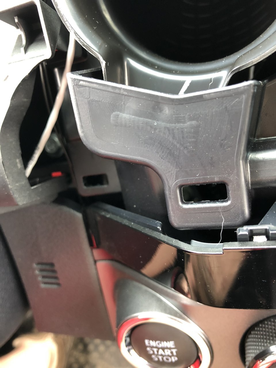

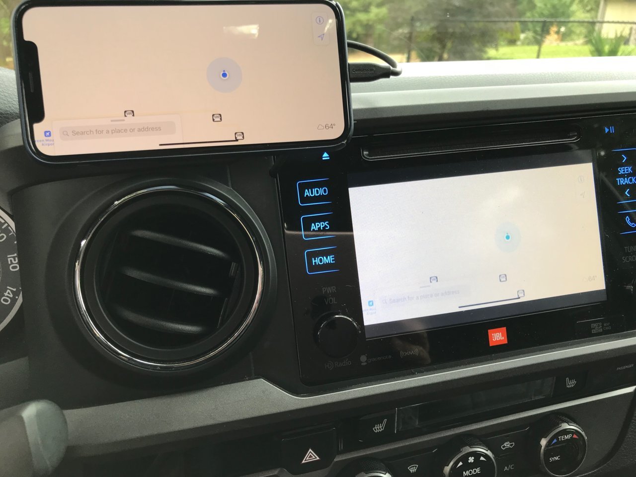

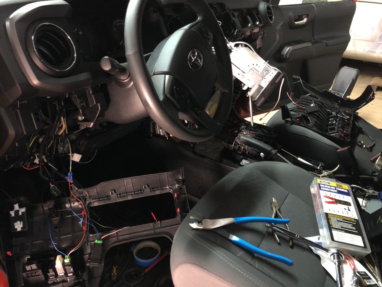

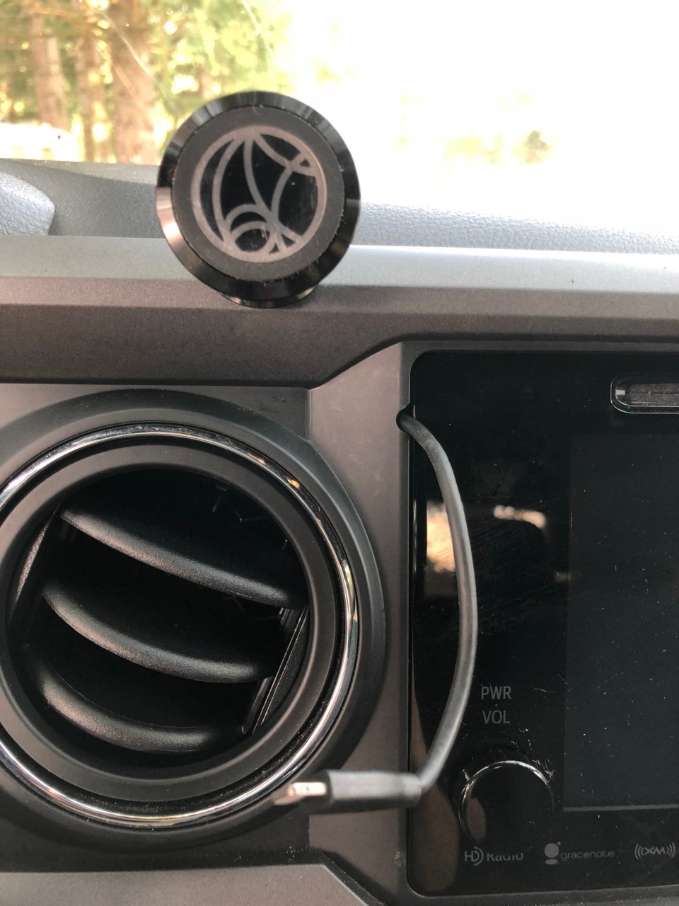

    I finally got around to installing my HAI cable. I wanted to mirror my phone and charge @ the same time so I went with using the apple AV adapter. I did try a mirror box but had 2 units that were DOA so I ended up using iSimple ISHD01 MediaLinx HDMI To Composite Video/Audio Adapter Cable because it claims to be iPhone compatible. A cheap HDMI to RCA adaptor also works. I also added a fuse tap to get power to the switches and tapped in to the dash fuse along with USB power tapped into the cigaret lighter.
    I replace the GPS toggle switch with a dash mounted switch listed below. I ended up making a custom bracket to mount the switch in the drivers side cubby. If I had to do it again I’d use this OEM Style Switch Panel for 3rd Gen Cubby. I made some mods to the stereo bezel adding a notch to let the lightning extender cable and used a screw to attach the magnetic holder.
    Parts
    Tools
    Issues
    • Iphone X not going into landscape mode my wifes iPhone 6 plus works fine
    Next add front camera.
    MGMSangTaco and ScottyR like this.

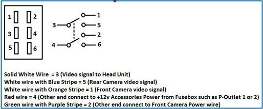

    @Hoangde Question for the add on cable. Which of these 3 wires is which?
    LEFT= Solid White
    MIDDLE= Blue Stripe
    RIGHT= Orange Stripe
    Hoangde[OP] likes this.

    Sorry for delay, here is your info..pay attention on pin 3, 5 and 1
    danyo_saan[QUOTED] likes this.

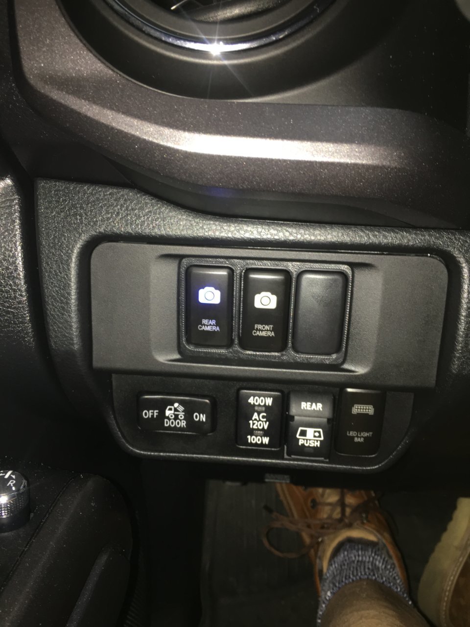

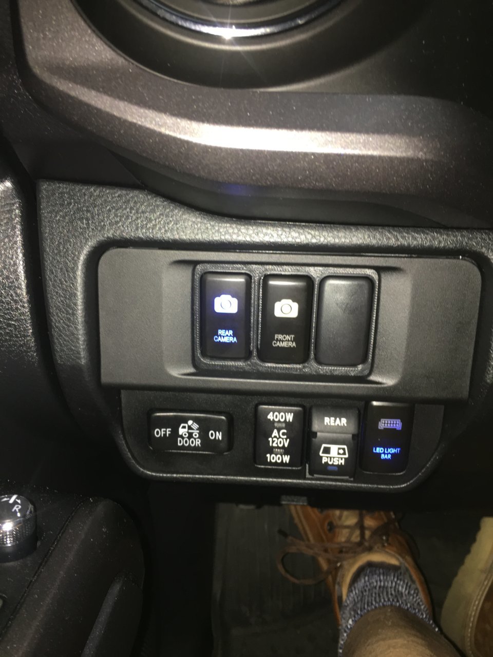

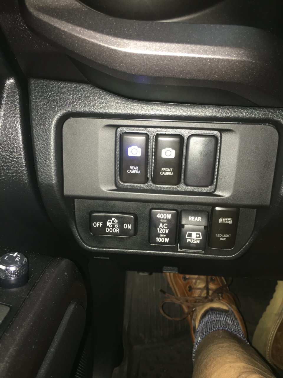

    Finally got to install mine today.. pretty straight forward, but also helped all of your ideas and tips. Thank you!!....IMG_3448.jpg IMG_3449.jpg IMG_3450.jpg
    It did take some time for the GPS to catch up once the over ride switch was on, but then it worked fine.. :thumbsup:
    MGMSangTaco, Hoangde[OP] and tonered like this.

    Nice!! Looks clean, I want to do mine like that with front and rear options! So it was easy to wire it so front and rear camera switches to work seperately pretty easy? Do you also need a seperate camera override switch? I am a novice and still trying to go through all the notes and figure it out.
    El Latigo[QUOTED] likes this.
  17. Sep 30, 2018 at 9:50 PM
    #597
    El Latigo
    El Latigo Well-Known Member
    Jan 4, 2018
    #240278
    659
    Anaheim CA
    2017 MGM TRD OR Double Cab Short Bed
    Thank you.. :thumbsup:
    No, not hard at all.. but i do highly suggest you look at the other posts on this thread and see how others did it, how they ran the cables, connect, install the over ride switch ect, this helped me a lot..
    to me the hardest part was, pulling and keeping the HU out, apparently the cables connected to the radio are short and didn't allow me to pull the radio much, so room to fish the HAI cable was limited.. other than than everything else was pretty simple and straight forward..
    also, be gentle when pulling the plastic trims out, i broke one tab...
    good luck..

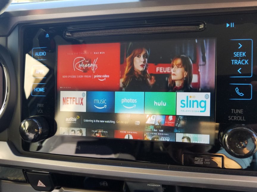

    Result from Fire Stick
