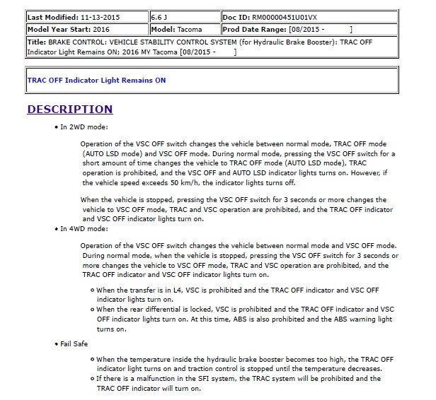

    Is there a mod that enables the traction control to be turned completely off without stoping and holding the button down?
  15. Sep 3, 2020 at 4:08 PM
    #375
    gudujarlson
    gudujarlson Well-Known Member
    Jul 2, 2019
    #298083
    7,415
    Minnesota
    2020 TRD Off-Road DCSB 6MT
    Kings, Dakars, SPCs, 33's, Mobtown Sliders, TRD Skid
    The original post suggests that TRAC is enabled in 4lo on a SR/SR5/TRD Sport/Limited, but I do not think that is the case. I never heard the ABS brakes operate in 4lo (without the brake pedal being applied) on my 2016 SR5. I did however notice it when in 4hi. I have a 2020 OR now, so I cannot confirm it.
    I am referring to this section:
    7. 4Lo TRAC ON and VSC OFF.
    8. 4Lo TRAC OFF and VSC OFF

    2017 AC TRD OR Auto 4wd, 2012 AC SR5 4.0 MT 4wd
    Extensive team testing did indicate SR/SR5/Sport/Limited does have TRAC in 4lo (by default), as shown by the posts in this thread.
    I can't verify that from personal experience (OR model here).
    Start reading thru this older thread for some verification
    https://www.tacomaworld.com/threads...s-non-trd-offroad.437814/page-8#post-16945563
    That video is fairly convincing. I know I tended to disable TRAC/VSC with the long push every time I wanted to have fun, but I don't remember having to do it in 4lo. I remember 4lo defaulting everything to off. Maybe I wasn't observant enough, my memory fails me, or I had an oddball 2016 SR5. I wish I had an SR5 to go test with again.
