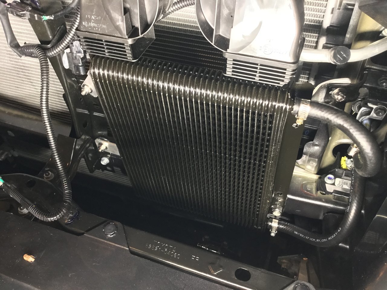

    Here’s my install. Isolated with rubber pad and rubber washers and using some sturdy scrap aluminum strips in the garage for brackets. That can be purchased at HD or Lowe’s.

    with how cheap they are now, theres really no reason for using a tube and fin cooler anymore unless your replacing an OEM part and thats a slick install, just needs a fan and its perfect

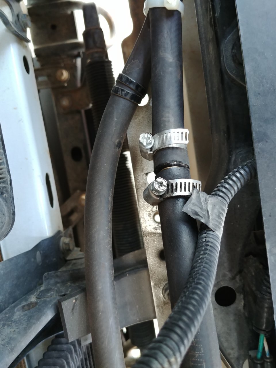

    I removed my return line filter today. It was starting to weep on the input side and I assume it's clogging up after 20,000+ miles. I replaced it with a brass plumbing barb
    Picture did not rotate correctly. It flows from passenger to driver side
