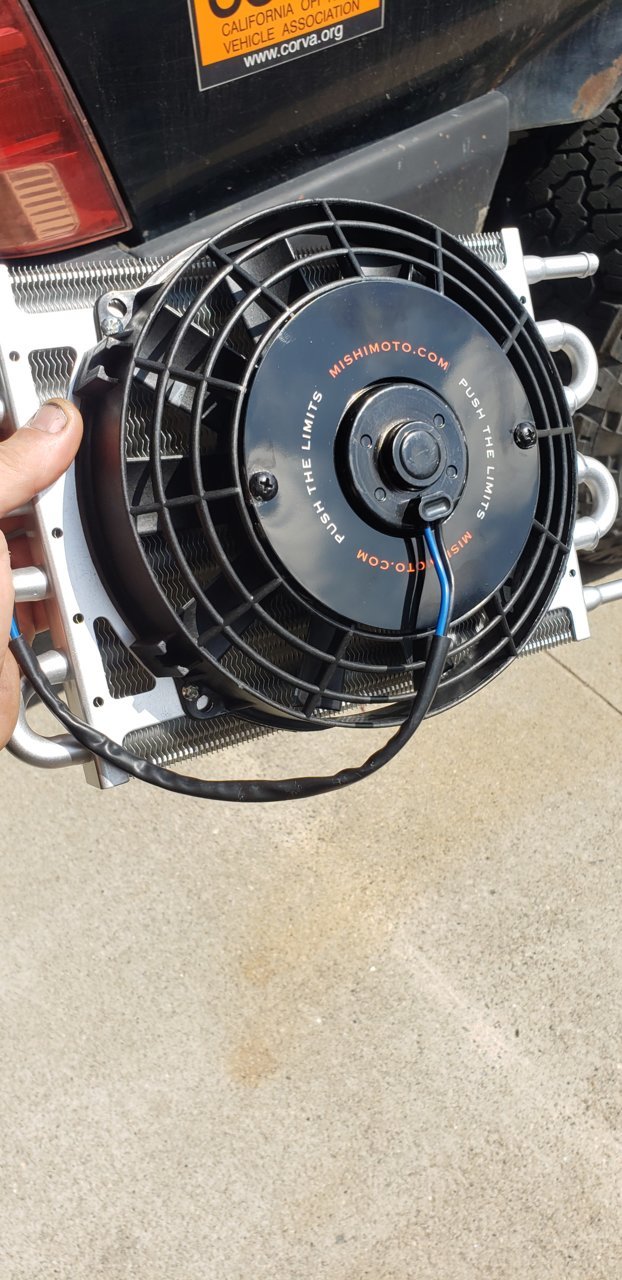

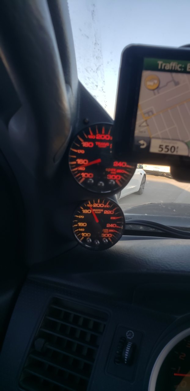

    This is how I did mine, I wanted something that was totally closed loop and separate from the OBD/ECU, and did not have to rely on Bluetooth APP monitering. So I found some Gauges from Autometer that can trigger a relay based on user programmed set High Point.
    My aftermarket Transmission Fluid Gauge I installed has the ability based on a programmable set temperature to control a relay which controls the fan on my trans cooler, all it does is it closes a ground signal to the relay. It's all dummy proof with no switches or user input needed. The Gauge is pretty nifty that the Face starts blinking Red when the set temperature is reached, and after 10-15 -ish seconds the Gauge stays solid red until temps fall below the set.
    Weatherproof Relay kit from Frastronix
    I also just got done this past weekend of deleting the Factory Clutch Fan and installing a General Motors OEM Factory PWM controlled Spal 18" Electric Fan that's used on Corvettes and Camaros. Goal is to build a overerly built cooling system for the coolant and trans fluid. Pretty sure im getting close to that goal..

    I didn't know that had guages like that but I did think about adding a trans temp gauge and coolant temp gauge. Right now I have an app to monitor that stuff but it's a pain to have to connect every time. I thought about scanguage too but actual gauges would be nice and look better than a scanguage. I might have to look into that gauge and change some stuff up. I thought about swapping the fan out too but that project will have to wait until spring. I'd be interested to read more on your fan set up.
