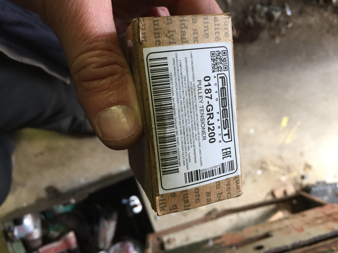

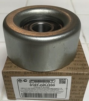

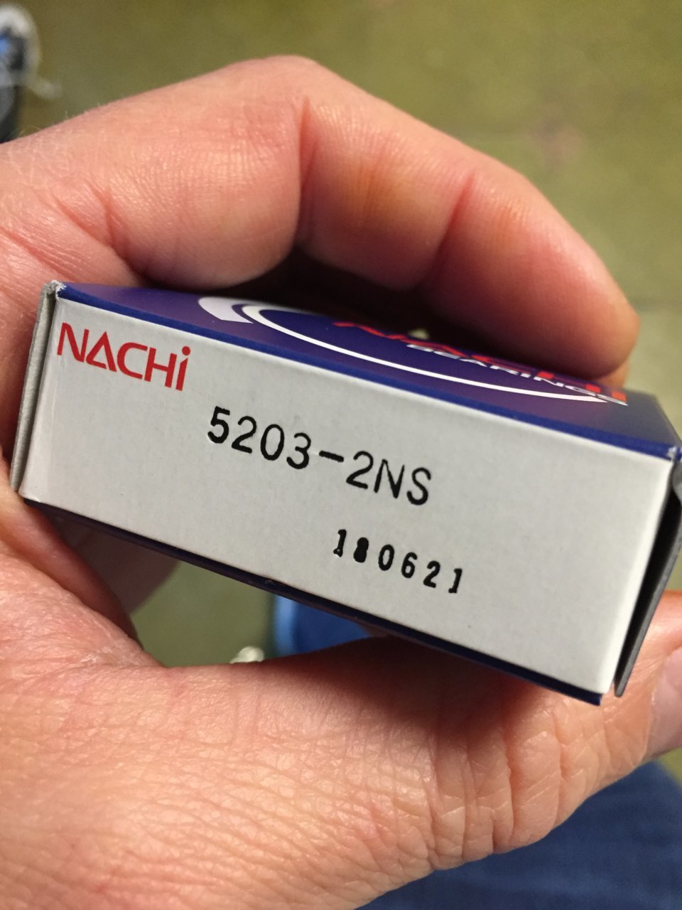

    Febest 0187-GRJ200 is the tensioner pulley/bearing, ready to go. But, it has a made-in-China bearing. I got one as a backup for off-roading. It's better to get a good quality Japanese bearing and replace it. A press is handy but not necessary. You can youtube replacing bearings without a press. The bearing size is 17X40X17.5 (ID X OD X Width). I installed a Nachi 5203-2NS bearing.
    Febest on bottom. OEM to the right, with Nachi bearing on bottom right.
    [​IMG] [​IMG]

    Just received my Nachi bearing today. Waiting on the Febest pulley so I can swap these into it. Any tips on pressing bearings without a press?

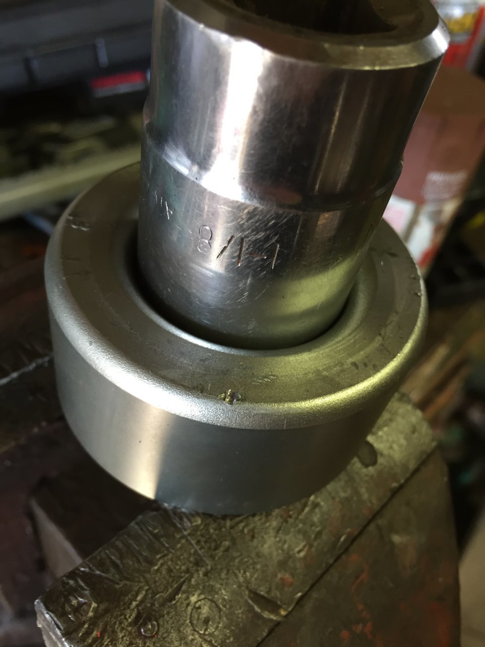

    With an assortment of sockets, and/or cups from a BJ or wheel bearing set, you can use a sledgehammer or BJ C-clamp to press out and in. Once you get one out, you can use the old bearing to press in the new one. Alternatively, a 3/4" bolt/nut can be used. The important thing to remember is to press on the outside of the bearing when pressing them into the pulley. There are several utube videos showing how to do this.

    A 1 and 1/8” socket was perfect for pressing the bearing
