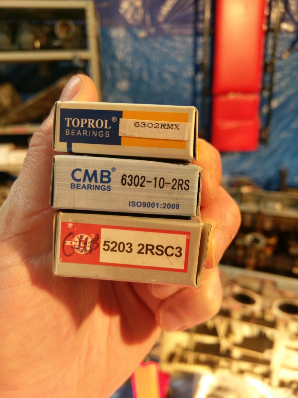

    I went by the bearing shop. These guys have never not found me a part. They looked through all the parts books and made a few calls. Could not locate a 10mm 6302!
    The 5203 in the pic, I have bought from them twice when needed to be changed, over like 6 years or so. Works perfect.
    This got me curious, I bought the 6302's off of eBay last week just to see. I pulled some spare pully's off the shelf and pressed one of each each bearing in and swapped out the pully's last Sunday. So far so good.
    What's the worst that can happen, have to put original pully's back on and I wasted $10 each on bearing?
    What's the best that can happen, found some good cheap replacement bearings :)
    We will see!
    (5203 - tensioner, 6302 - upper idler's, I bought extra 6302's, thinking about trying double stacking the lower idler with 2 6302's like someone suggested, just to try it)

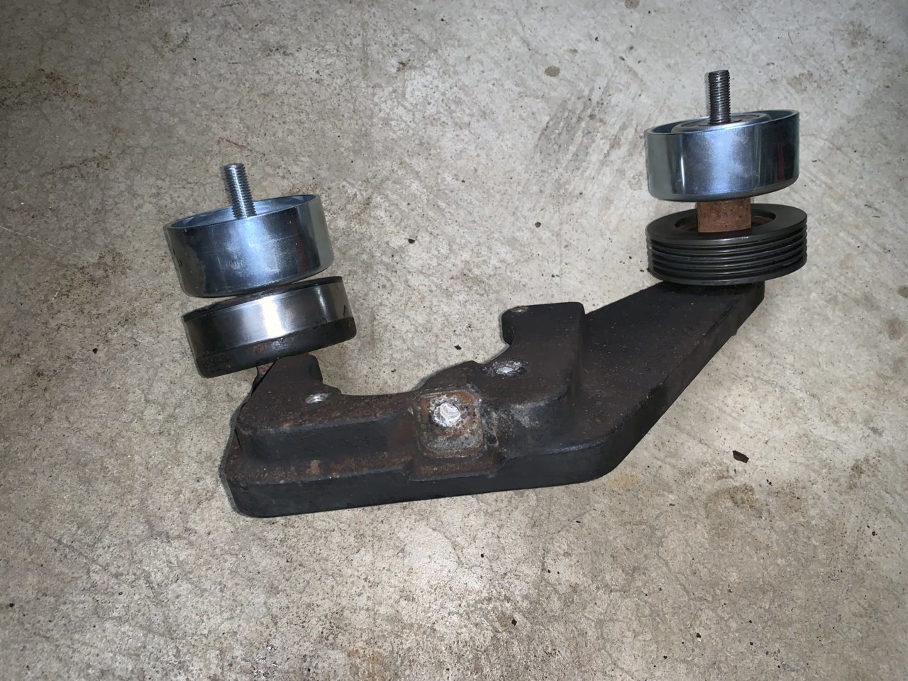

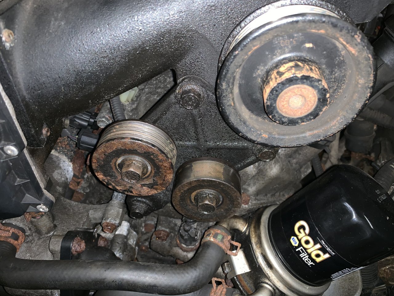

    Though I would add a little info since I am doing my pulleys and bearings. I also have the Trd supercharger and the bearings are also bad in the pulleys for the supercharger belt. Here are the bearing numbers for future reference.
    The bearings in the 2 small pulleys near the supercharger and also the bearing in the supercharger tensioner pulley are 6303-2rs bearings. B4DFD68F-CA73-4705-8FB8-ABF5BC635EF0.jpg
    The pulleys that are on the bracket in front of idlers # 1 and #2 on the alternator side are these bearing numbers :
    Grooved pulley infront of idler #1 is a 6303-2rs bearing.
    Flat pulley in front of idler #2 is a 6203 bearing. 3DAF1C3E-BB4B-4E5E-9285-3075051E14B8.jpg

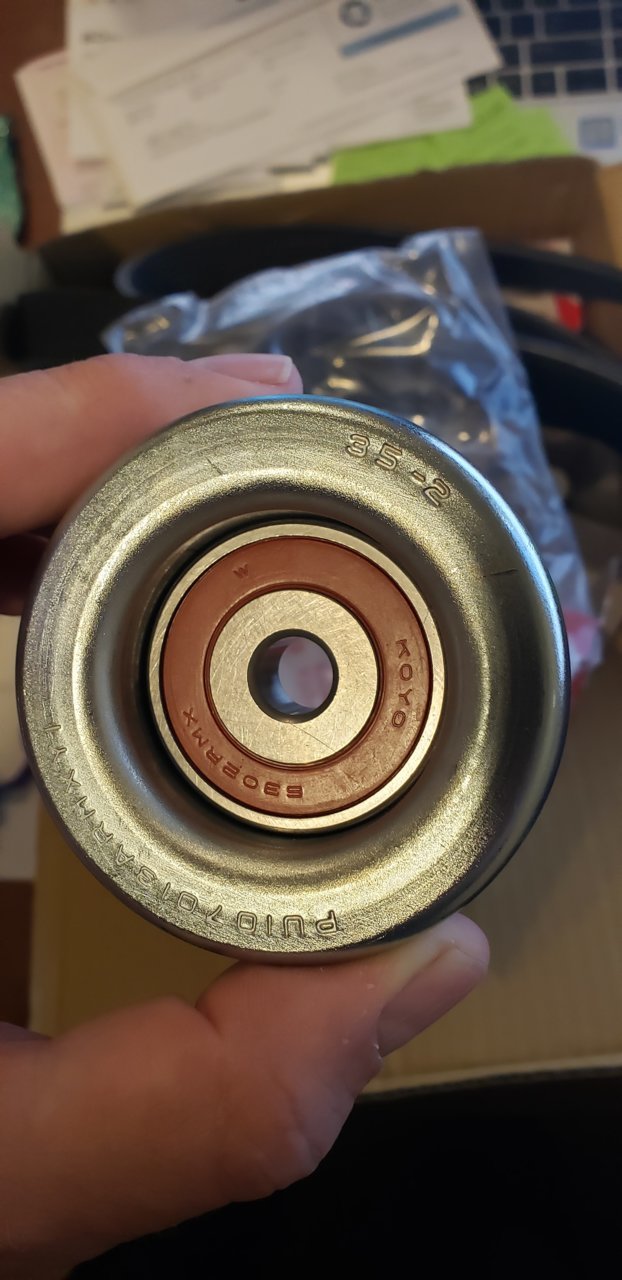

    Would you mind posting some pics of the markings on the bearings? Hopefully they are genuine. There are really good fake spark plugs, possible that there’s fake bearings as well.

    Here you go:
