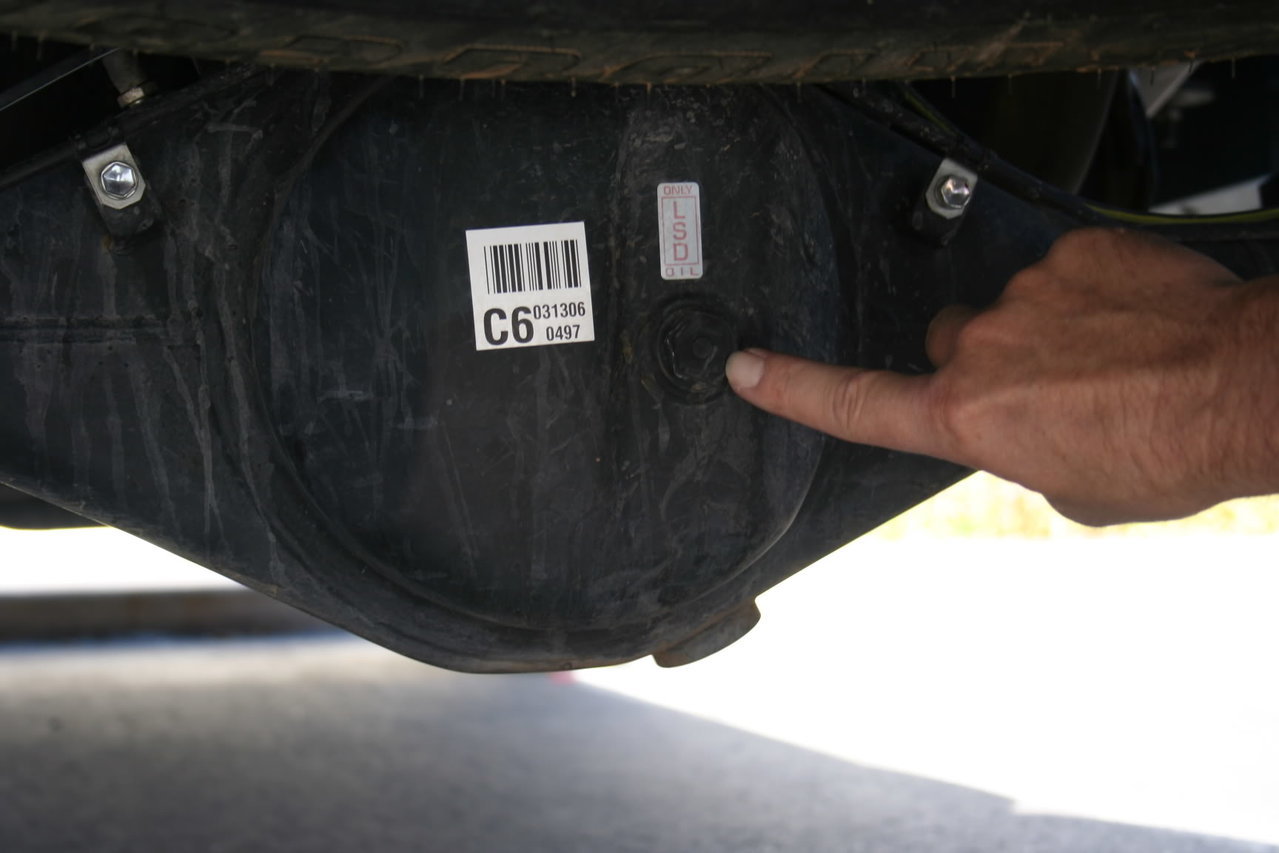

    Some '05-'08 require an LSD additive.
    If you drive an '05-'08 TRD Sport, or if your rear end is an LSD from these years read this for some input on what to put into your rear diff:
    https://www.tacomaworld.com/threads/beware-changing-lsd-lube.93117/
    I stole the above photo from this thread, which is an excellent walk through for those who need help with your rear end:
    https://www.tacomaworld.com/threads/changing-differential-fluid-a-step-by-step-how-to.24545/
