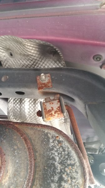

    Check it...found this bullshit today...I'm gonna put all my shit back together zip tie this up and go down to the muffler shop that did it...could that possibly be causing all those codes?

    Noisier then normal, I wonder if your VVT oil feed is partially plugged up.
    A broken exhaust holder isn't going to cause a code.
