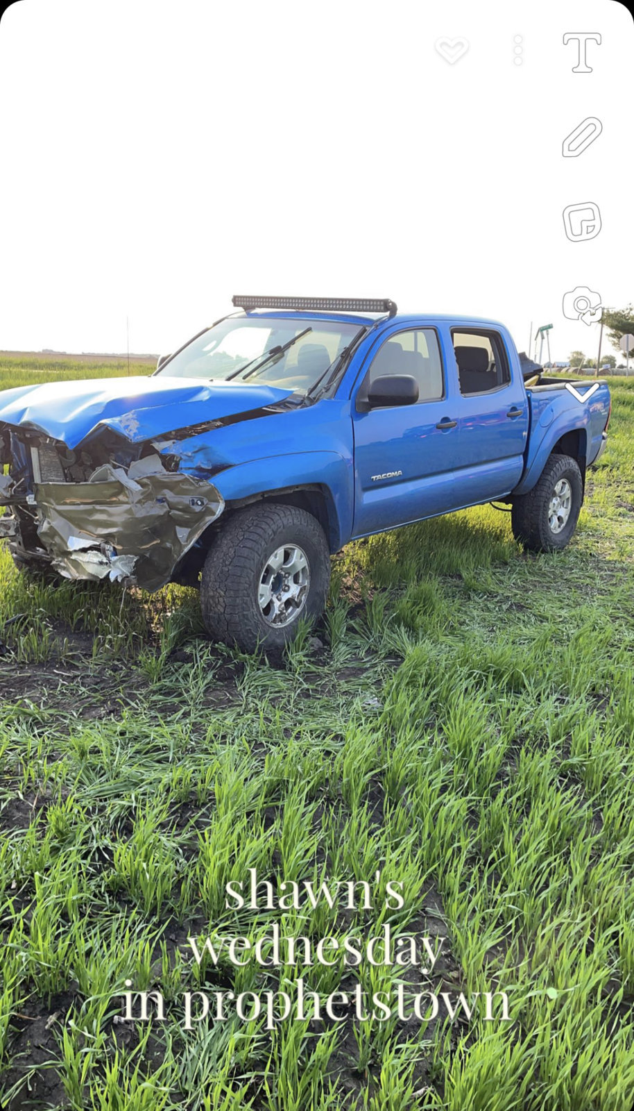

    I had the entire engine rebuilt with better head gaskets and urd cam gears. I tried to get the arp head studs but after 3 months of waiting I went with new head bolts. I had the csf radiator to keep thing cool. After the rebuild I got in an accident with 5000 miles on the rebuild and 210k on the truck.

    that is no good man. maybe not the news you care to hear but i may sell my s/c 2015 soon. if you have interest pm me. take care.
