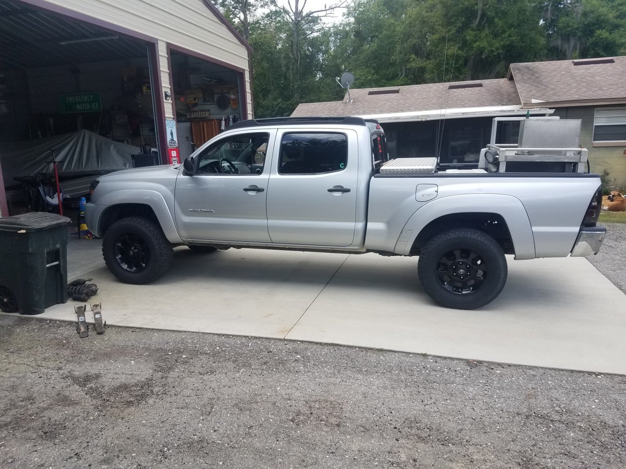

    I do not think so I have looked and no switch for Locker I have no other buttons that I know of. I was waiting for some pictures I didn't see any so I didn't have a locker I'm pretty sure that mine is not an off Road

    Post pictures of your truck and hopefully someone can tell you what model you have. Buttons on the dash and engine bay could give us an idea of the model. Take a look at the other threads too, they might be able to help you.

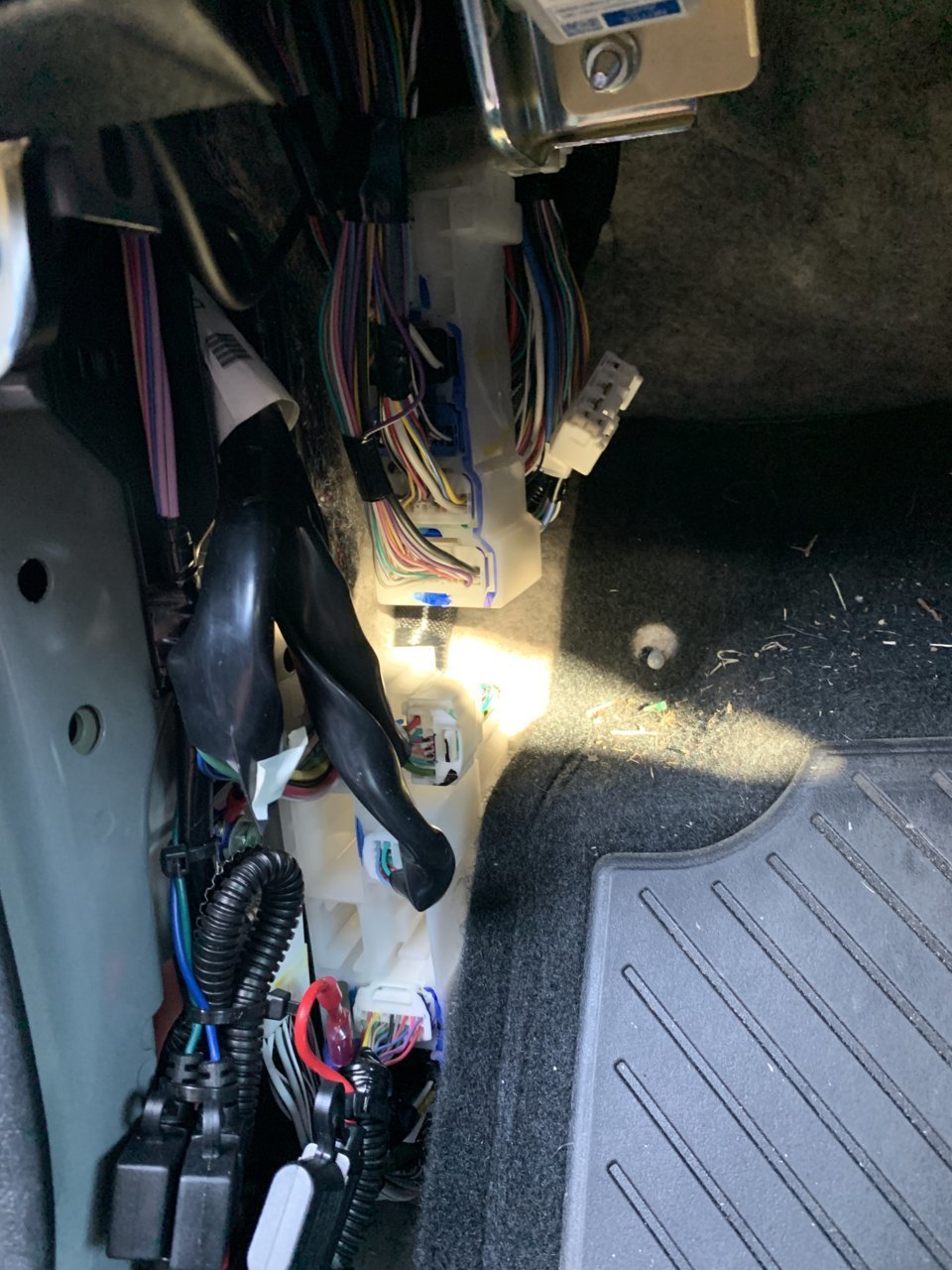

    Thanks when I looked I found the light green wire just like the post blinking and cut it and put the switch in but my ABS light is not shutting off when I switch it on and off. Now my switch is the same type has that safety toggle switch so I couldn't do it accidentally but mine only has two terminals because it is not lighted so I'm not sure if that makes a difference or not? Also I see your first posted link if something a little different.
    I do not believe my truck has differential lock or a track because there's no buttons or anything like that it's an 05 automatic V6

    My ABS light is not coming on IE being inactive. The wires that I cut even after I cut them the light doesn't come on so apparently I have cut the wrong wire or something SMH

    Sounds like you need the ground method. Others have reported the same problem. Read through that thread to verify. Hope that helps.

    I'm still trying to figure this out, is it right for me to hook up 1 wire to one lead and one more to the other on the back of my toggle it only has two terminals so I was guessing one on each? Here is a picture of the back of the box it is one of those flip up racing style ones and only has two connectors on the back.
