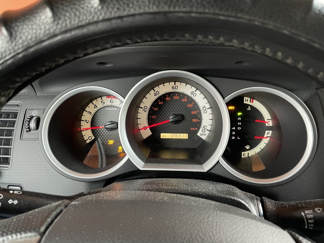

  15. Dec 25, 2021 at 11:08 AM
    #415
    Turbo-Taco
    Turbo-Taco Well-Known Member
    Aug 22, 2013
    #110941
    460
    Randy
    Portland, Oregon
    2024 Toyota Tacoma SR5
    Sort of reviving the thread I just did the abs mod, light green wire on a 2013 4x4 sport and seems to work as it should. Here is what lights up on my dash when the switch is thrown, does it look correct 253BABD5-372F-444A-8902-D3CF8F79619C.jpg
    Update: had a snow and ice event here and this worked like charm, nice to shut off ABS
    reallifedog likes this.
