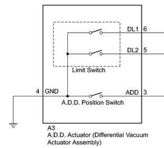

    However I may have learned something that is causing you an issue. The front actuator (ADD actuator) can be inadvertently driven into invalid positions. The truck checks the 4wd system on engine start, and during any command position changes. If the system detects any component that is not in a feasible position/operating mode, it blinks and locks out.
    Specifically, the front ADD has a total of 3 limit switches and the motor. The system checks that the 3 limit switches correlate to an acceptable position. It doesn't have to be the correct position, but it does need to be valid. If for any reason the actuator gets driven slightly past the limit switches, such as while installing it, it will enter an invalid position. The ECU detects this invalid position and locks out the system. Power cycling the truck doesnt help, as the system checks at every start up.
    If this is the cause, you need to manually (electrically) move the ADD to a valid position with the truck off (with ADD installed), and it will then recover when you power cycle.

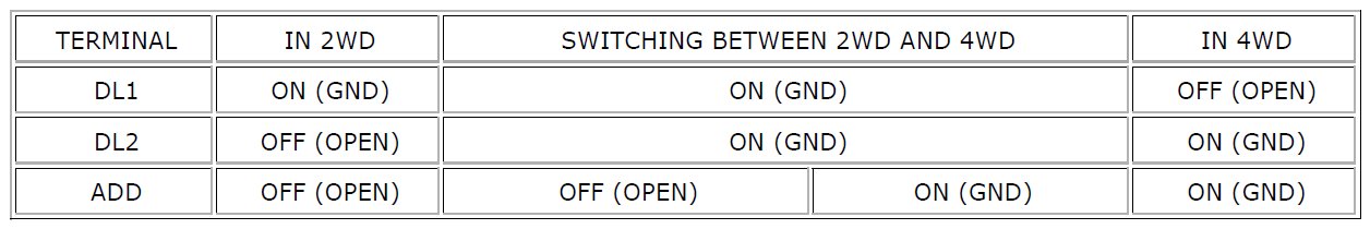

    In case anybody is interested, this table (from the service manual) shows what the ADD is supposed to show for each position. If the ADD is operated too far in either direction, the feedback wipers show open (per my recollection), leading you to think the ADD is bad. First time I did it, I thought I had hosed up the truck bad...
