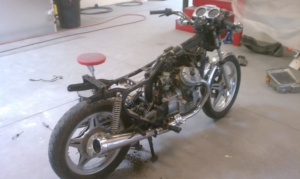

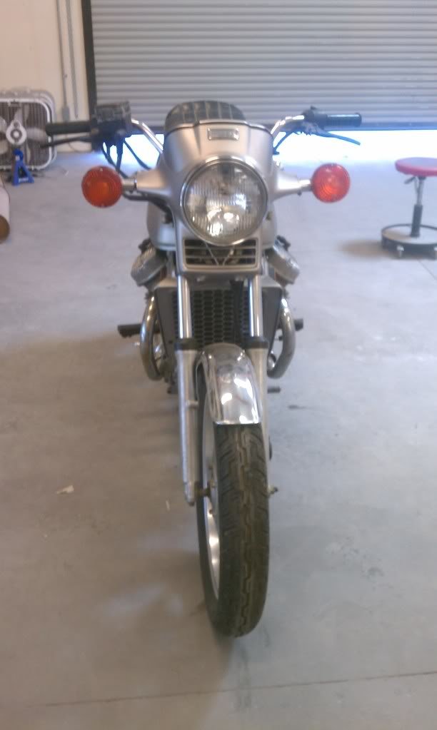

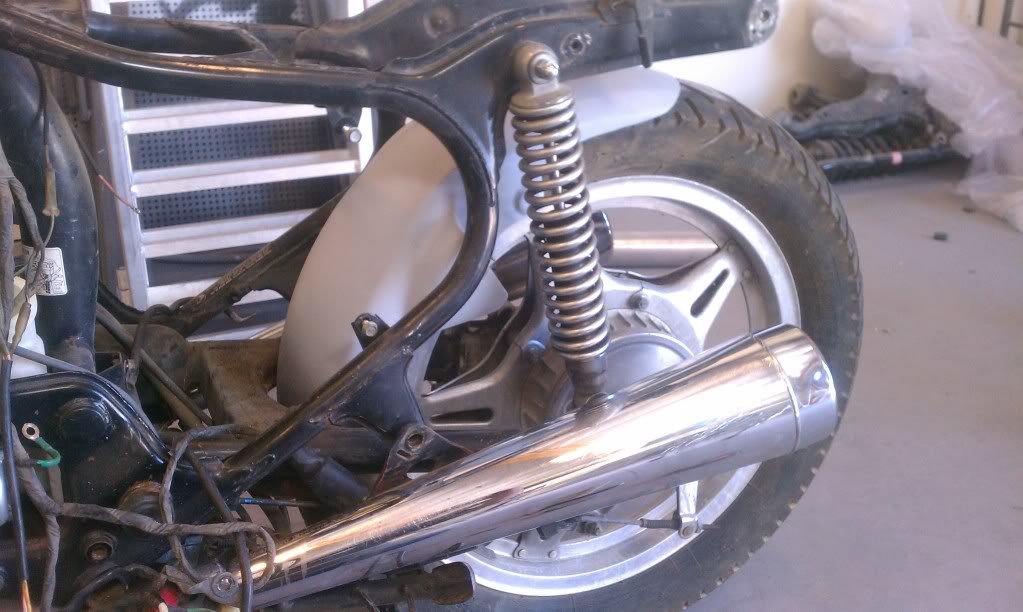

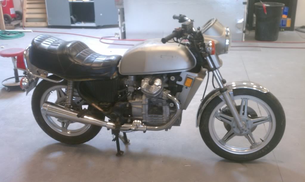

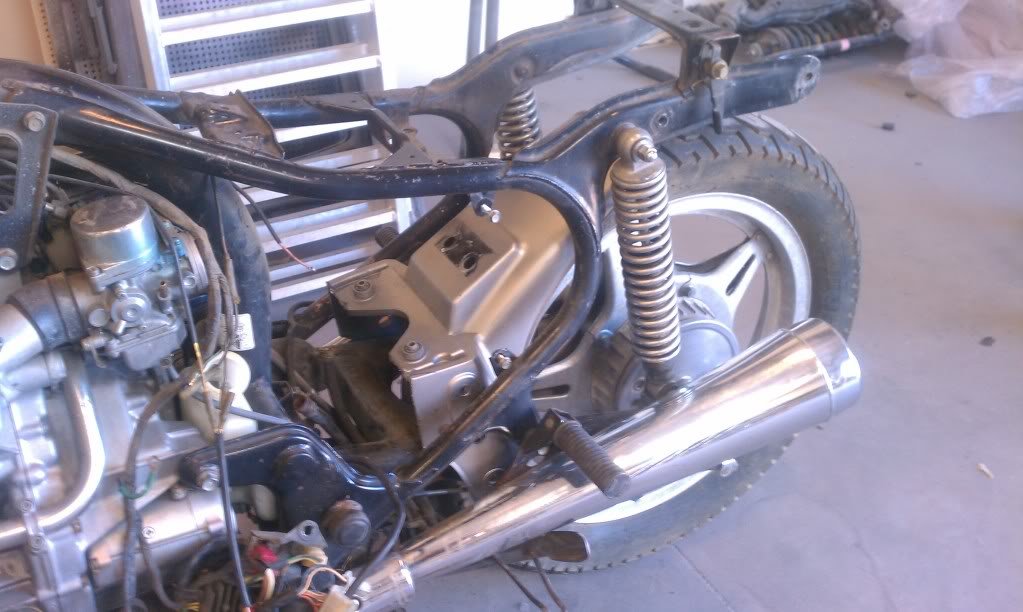

    OK guys. I finally got a good candidate for a motorcycle build. I found a 1978 CX 500 Standard. I picked it up for $250. Not sure if it runs yet. The battery needs charged or just replaced and the fuel tank needs cleaned out. That will be enough to see if it fires up. I plan on making it a monoshock rear end and making the paint very nice. I think I'm going with a Gunmetal with black accents theme. It will get all the small stuff like tires, fluids, front brakes, clutch cable, and some wiring clean up. It should move along quickly though. I am going to try and have this done inside 30 days. It may take a little longer though since I'm out of town for a week in June. Since I have access to hydrographics I might stick some half naked zombie chicks on the fenders or something. They blend in well with a dark graphite or gunmetal color. The front fender is going to get chopped down too. I'm sure there will be changes in the plan along the way.

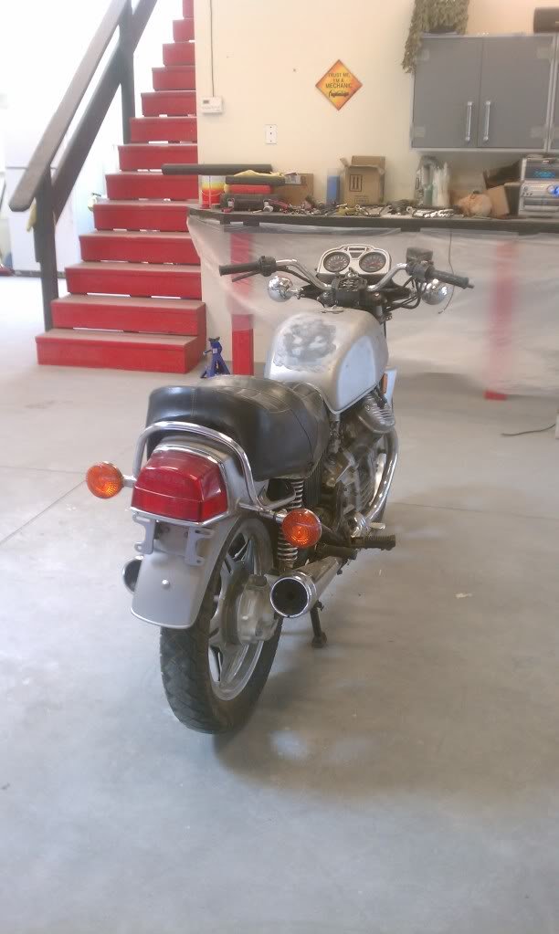

    Here are a few pictures of what happened to day after I picked it up this morning:
    Suggestions are welcome!!!

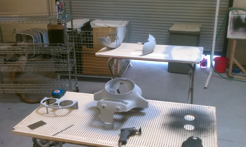

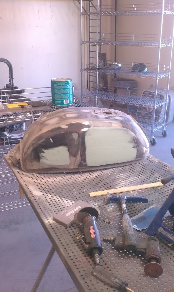

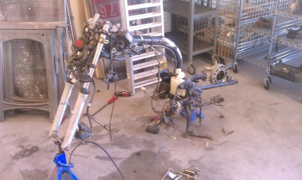

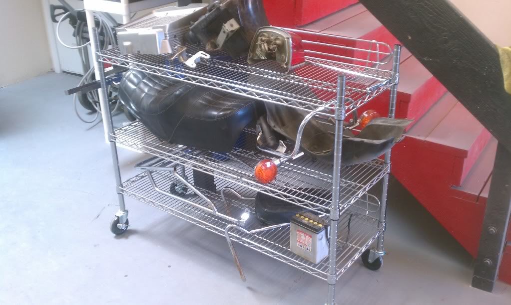

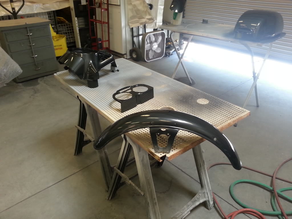

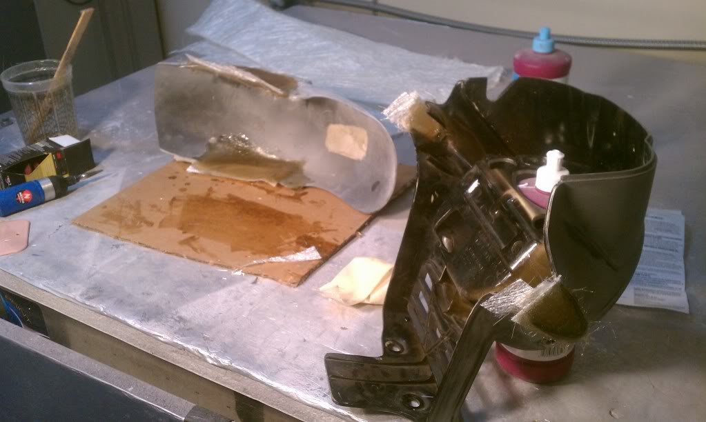

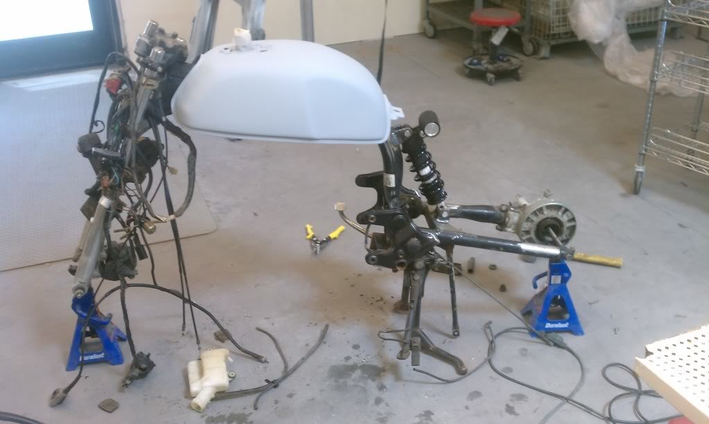

    OK. So i spent about 4 hours at the shop this morning working on the bike. I got the tank straight, finally. I started to prep some other parts for primer and paint. Some metal parts need to be blasted still.
    Tank before much sanding happened.
    Some of the parts getting prepped for primer:
    Extra stuff that will not be used:

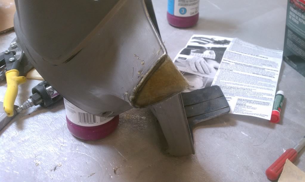

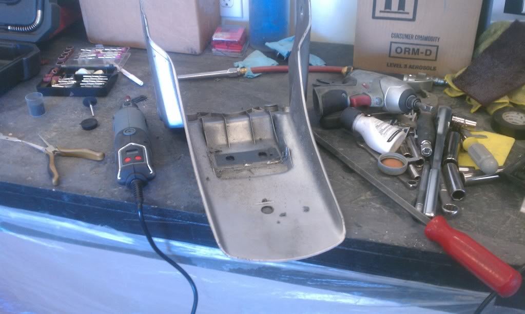

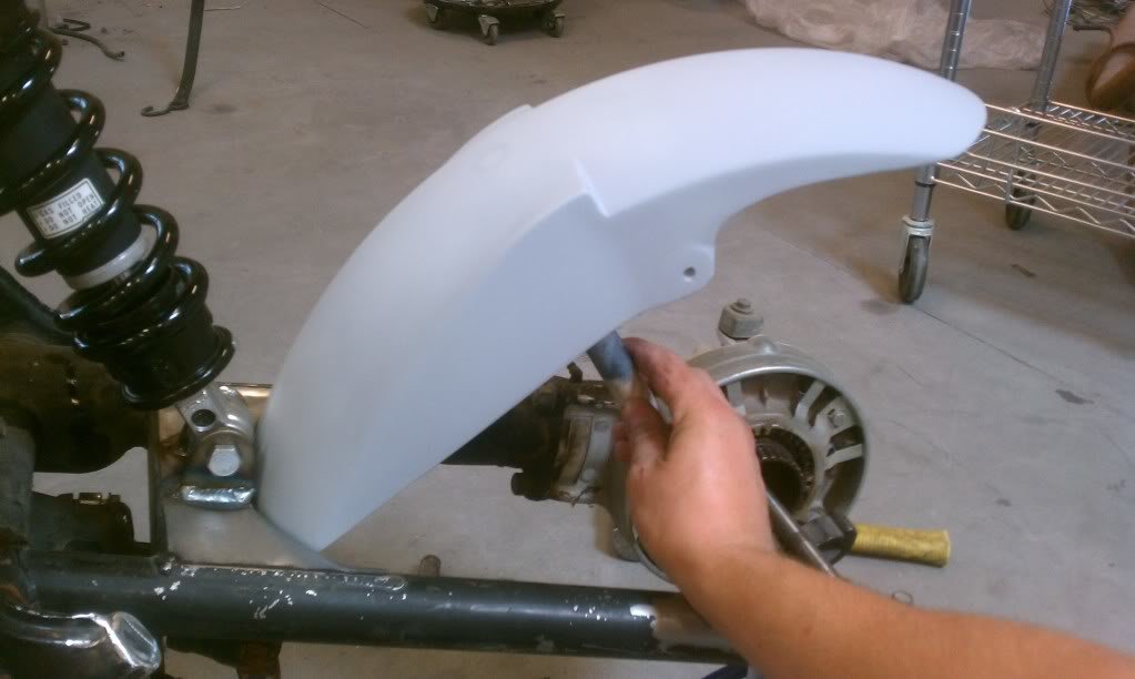

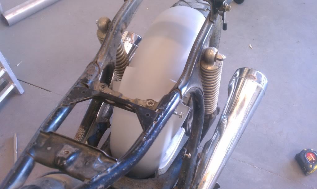

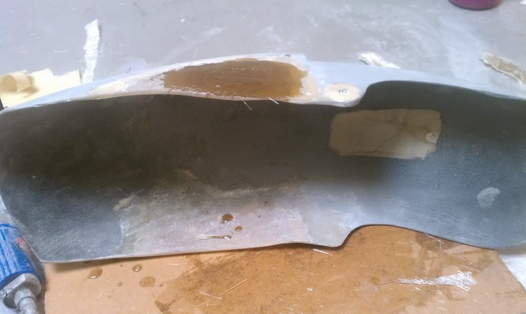

    Started to think about a way to make a rear hugger:
    Then I remembered that I had an old R6 front fender that will make a great rear hugger after some massaging and fiberglass:

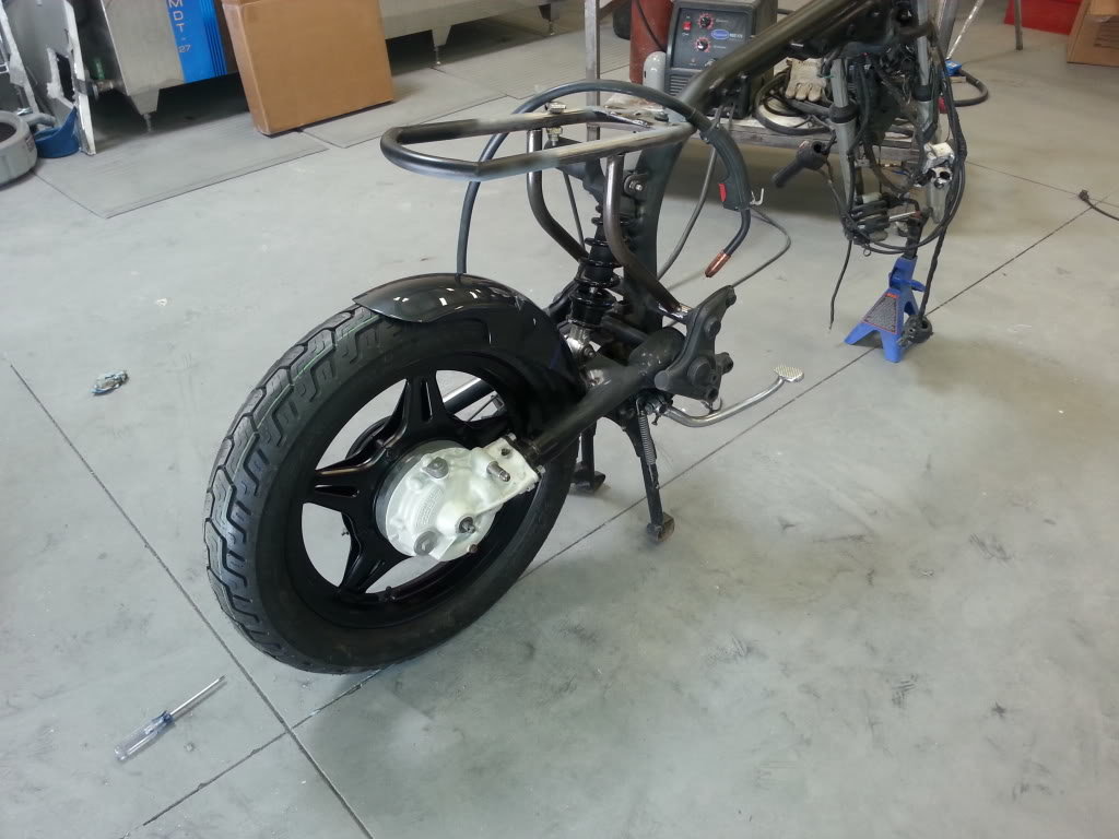

    I have gotten about another 15-20 hours into the bike since my last post. School and vacation(house hunting) have really taken my time away from what I wanted to do. I'm pretty sure the 30 day mark is done. I'm about half way done maybe. There has been a lot of wasted time waiting on parts. People need to get their shipping departments together.

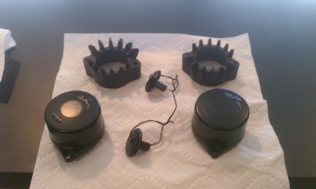

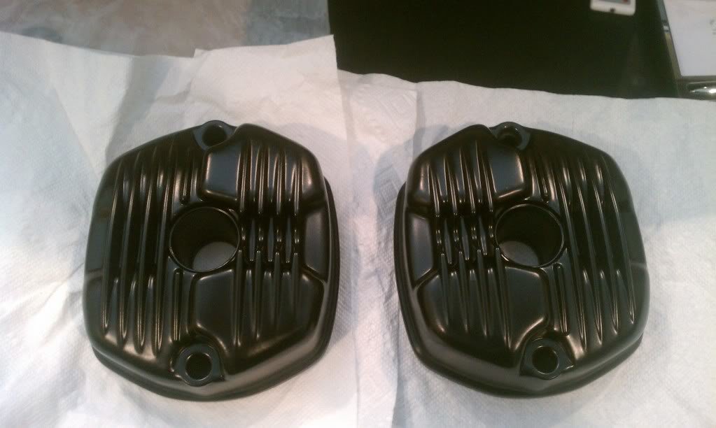

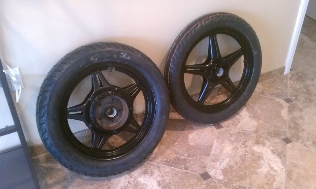

    Powder Coated parts:
    New tires on the wheels too:
    Rough Fiberglass work:

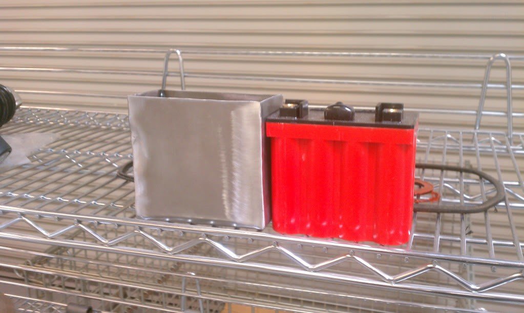

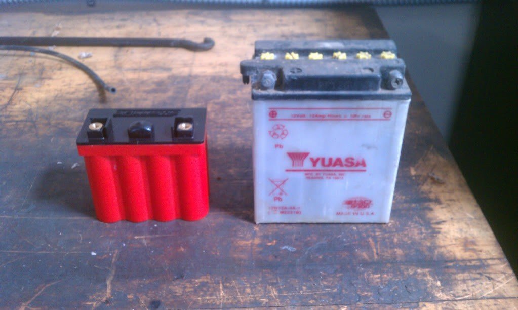

    New Ballistic 8 Cell Battery. It is much smaller and lighter than the original:
    Little battery box:

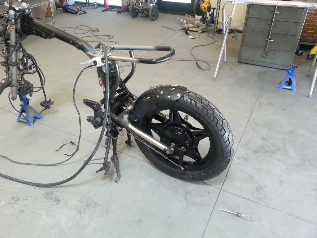

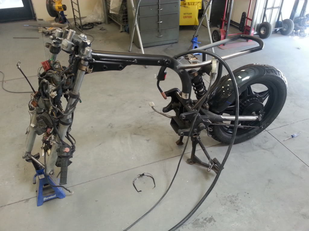

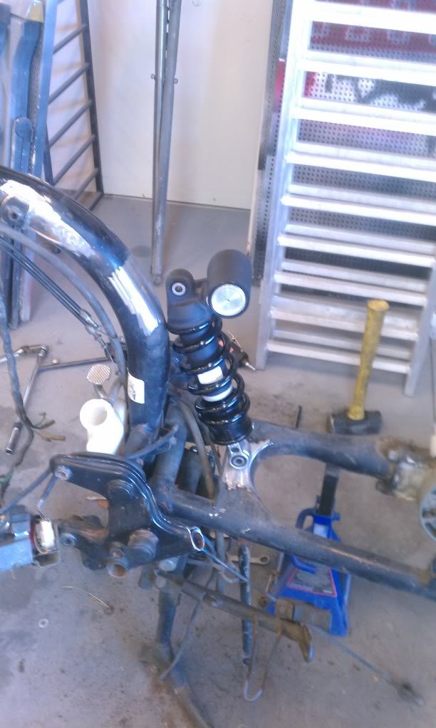

    Cut the back half off the frame:
    Stuff in primer. Still needs some sanding and filler in small places:
    The R6 front fender that I made into a rear hugger:

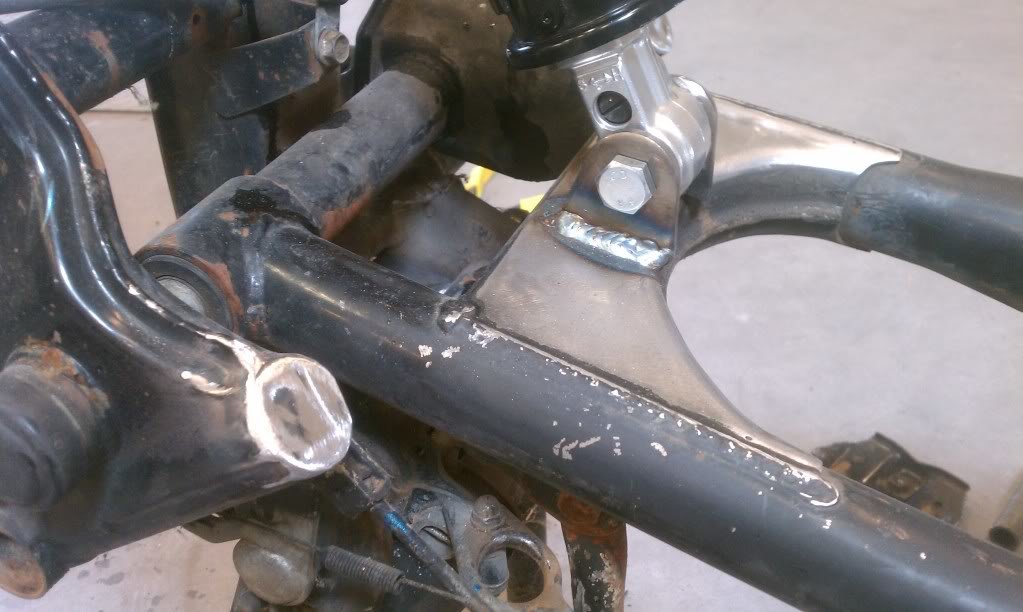

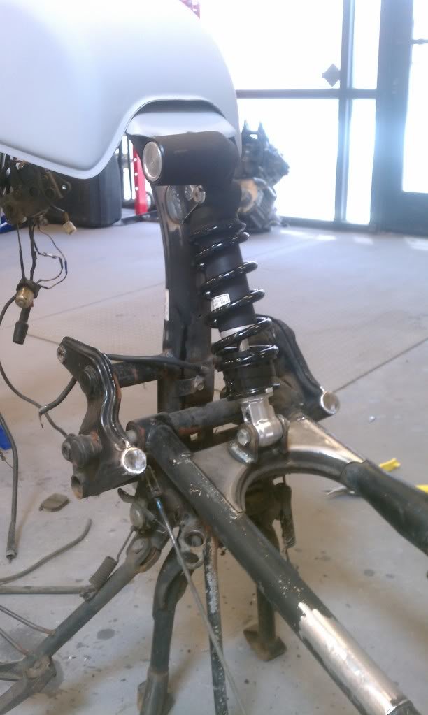

    Monoshock mounted up and welded tabs:
    Capped the frame where it was cut off:
    Still have some filler in places, finish weld some small stuff, paint is on the way, waiting on some other parts, frame needs cleaned up and painted quick also.

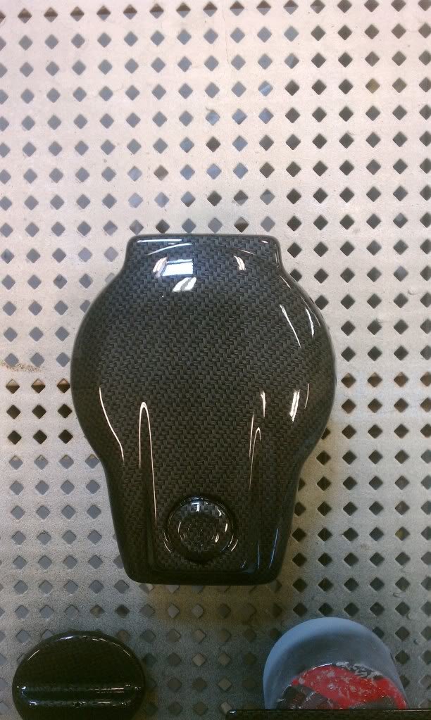

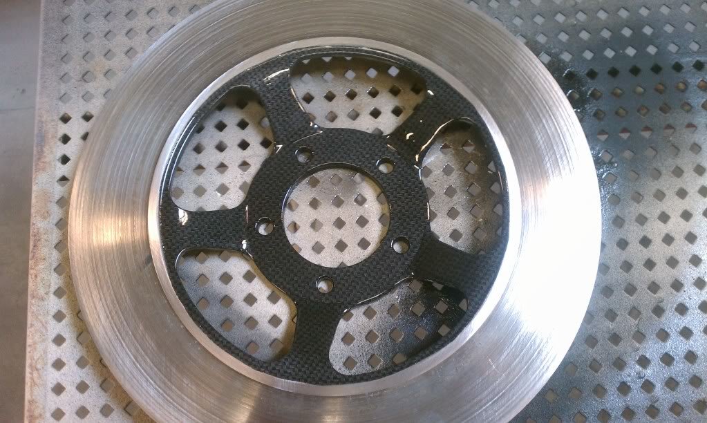

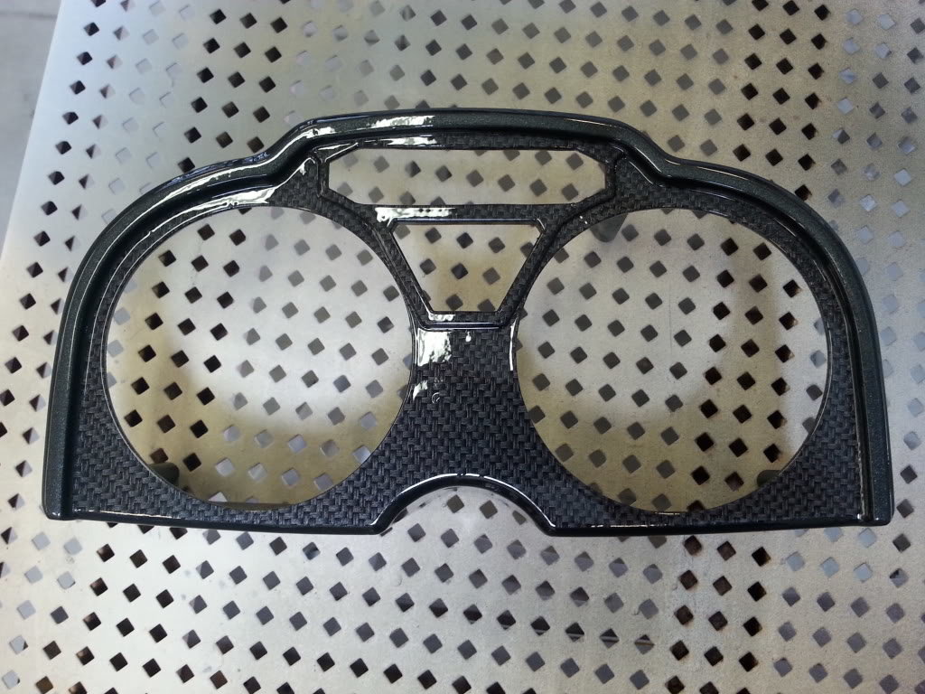

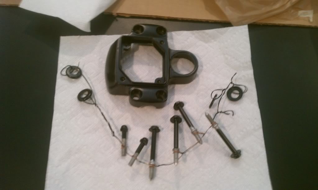

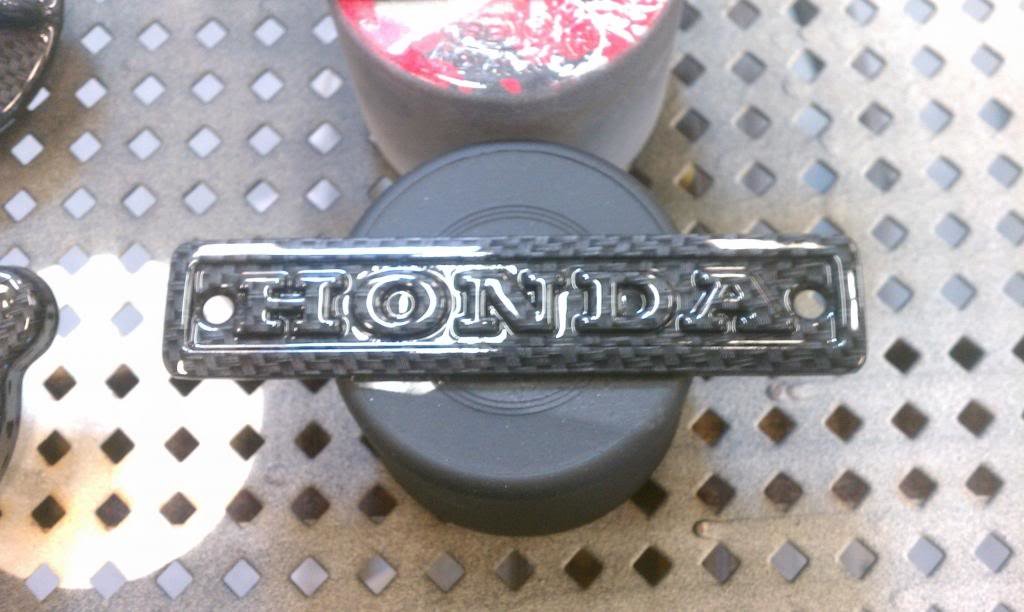

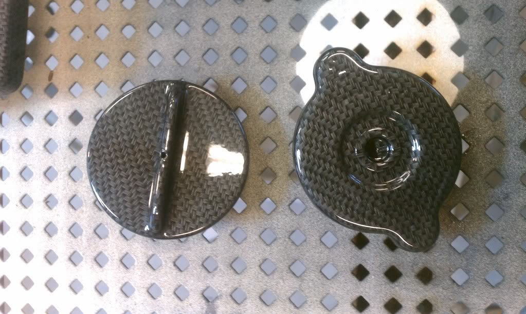

    I dipped a few things for the bike. I did it in some CF. I did not want to go overboard with it though.
    I am still waiting for some steel to come in so I can bend up the rear seat structure.

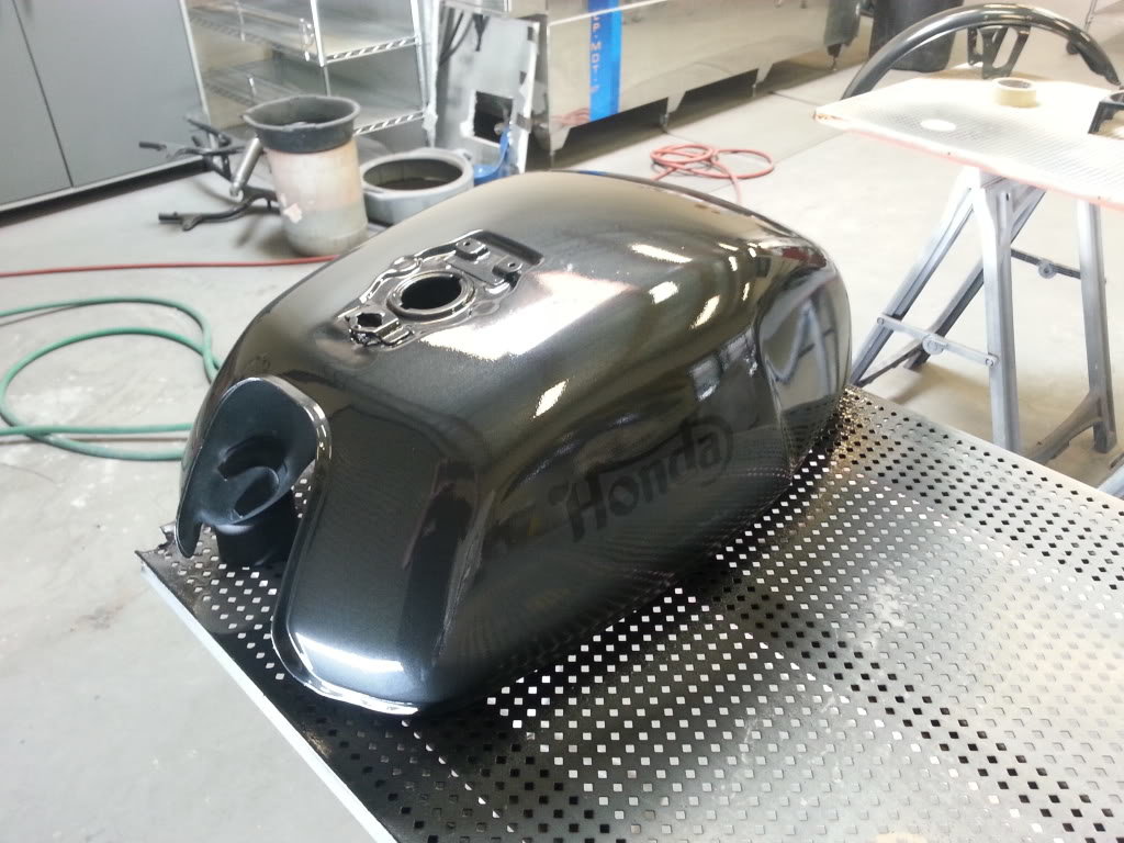

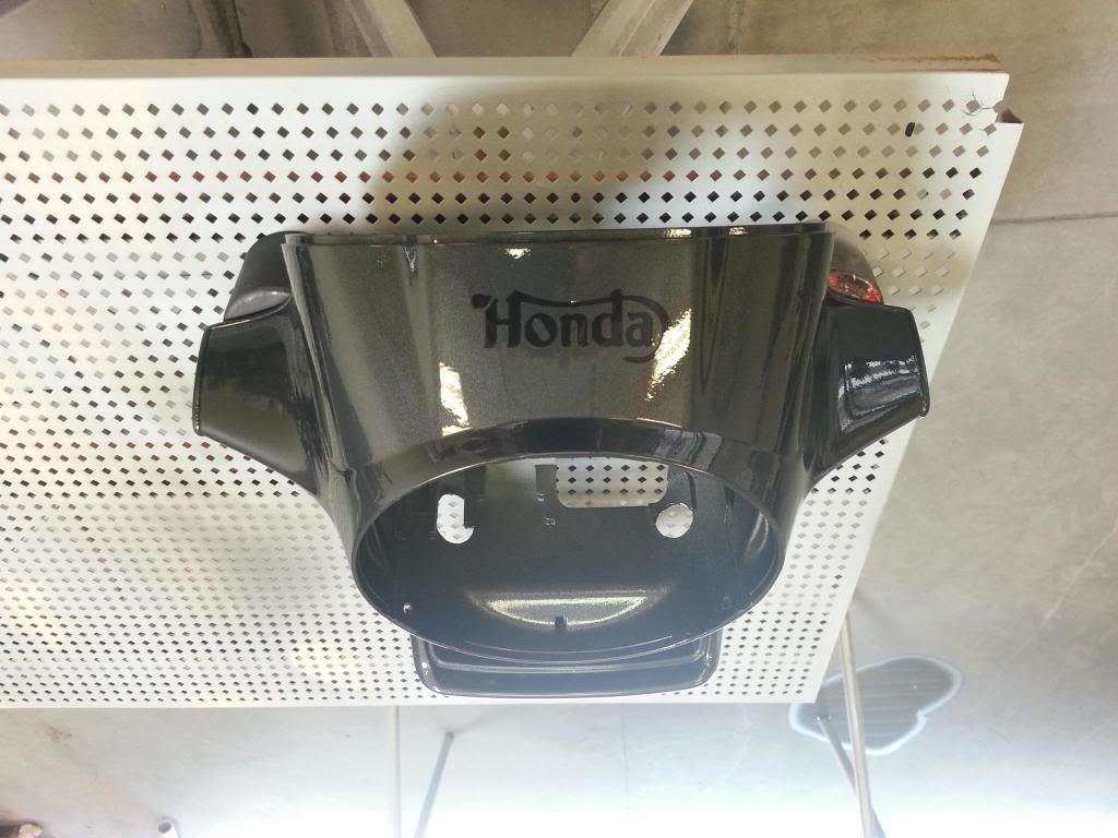

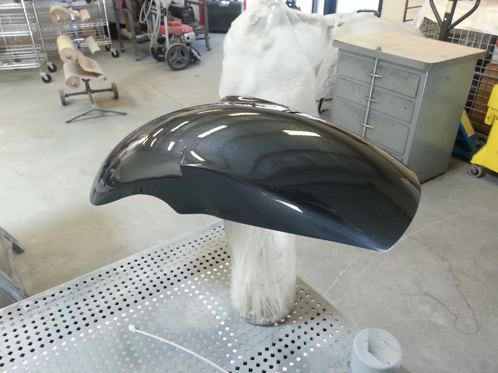

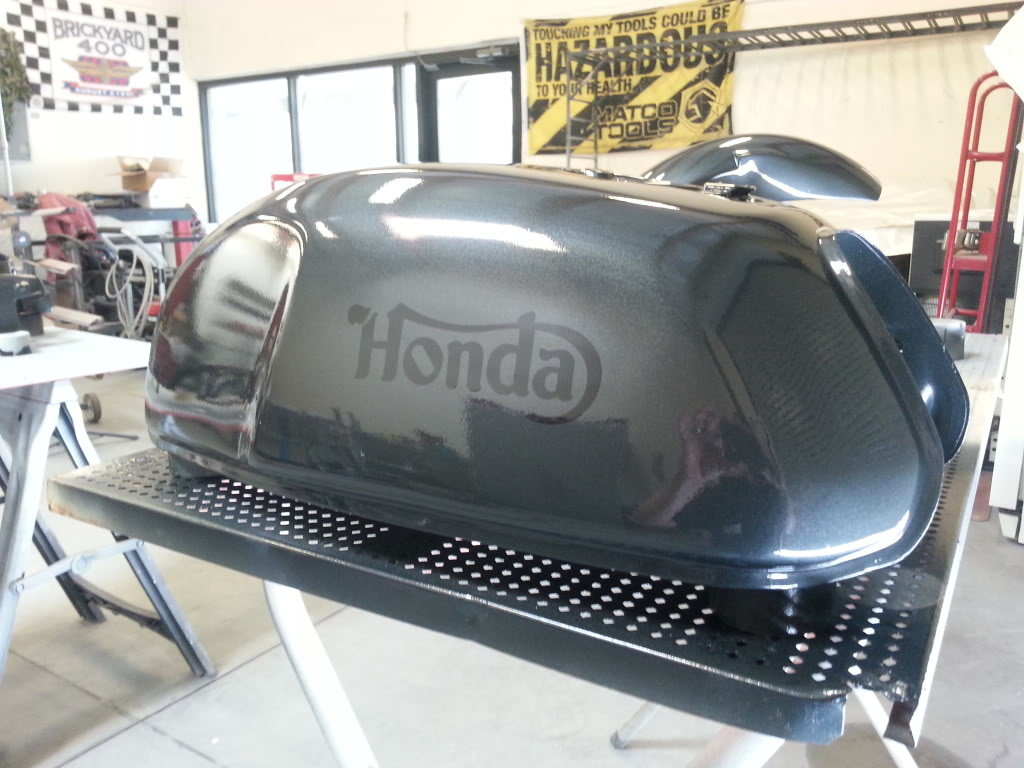

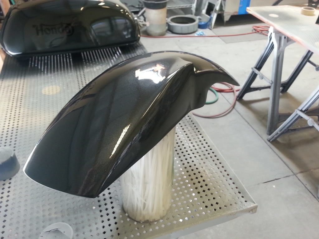

    I got some painting on the bike done today. There is still some small paint work that needs done but it will be with some Transtar Satin Black out of a spray can.
    I got the font from another thread on here. Thanks for that. It came out great. I had my vinyl guy cut out some stencil vinyl so that I could paint on the "Honda" before it was cleared.
    I left the face of the gauge panel in CF. The bottom area and the trim is painted the Cyber Grey Metallic.
    Rear Hugger (made from an R6 front fender):
    The tank came out pretty awesome. The Honda logo looks excellent.

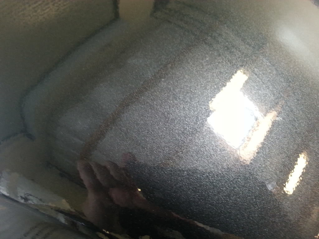

    I love how the color turned out. I think the satin black accents will do nicely against this primary paint color. All of these pictures were taken just a few minutes after spraying the clear. There wasn't any flow time really. I'm sure they will be a little smoother when I go back to the shop tomorrow. Plus, they are going to be sanded and buffed anyway.
    Close up of the color:

    How/what did you do to get that carbon fiber?? Looks wicked!

    That is what I do for a living. It is called water transfer printing. It can be applied to anything that can be painted and submerged into water for a short time. Click the logo in my sig to see our website.
