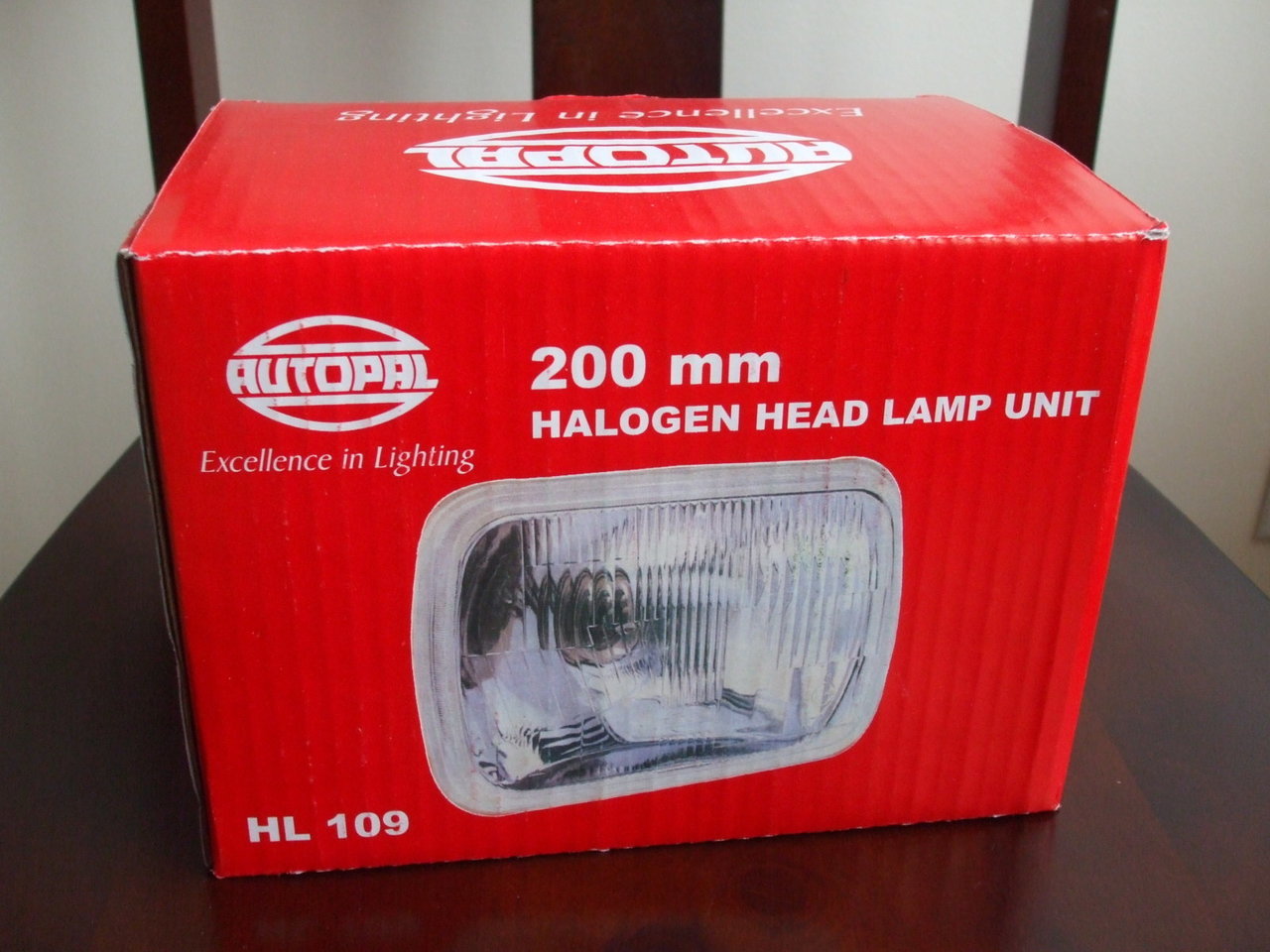

    I would without a doubt go with a set of Autopal Euro 200mm glass units. They are a universal fitment and are listed to work on 95-97 Tacoma's. They fit very good on my '92 & '93 Cherokee's. I had them for a Minnesota and two Montana winters and they survived without pitting or cracking.
    I would not use plastic in harsh climates, unless sanding the haze and pits out is enjoyable to you.
    http://www.ebay.com/itm/200mm-H6054...Parts_Accessories&hash=item4d0b060897&vxp=mtr

    Thanks Mike.
    How are the beams on those?
    $45 for the pair sounds enticing.

    The beam is very similar to the round Hella E-codes that I had in a Wrangler of mine. I prefer the euro pattern.
    As far as I can tell these are a direct knock off of the Hella H4 rectangular E-code housings... which is fine by me, especially when they are a fraction of the cost.
