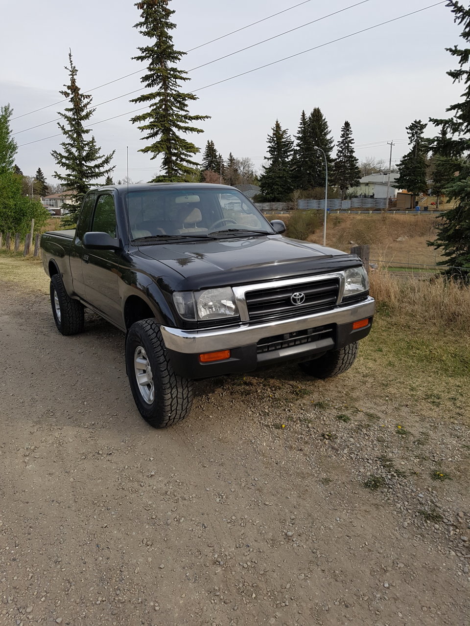

    So I was wondering if you guys might know if a grill conversion from a 98-00 to 96-97 is possible? If so, simple "plug n play" per say or is major/minor body mods required? It seems as if only headlights would be of concern, but I assume even those would just power up in same fashion from behind without modifying wire harnesses.

    And yes, headlights are plug-and-play.

    I do know the bumper bolts right up. You have to take the crush cans off the front of the frame. I have the 96-97 bumper on my 2000.20160422_175536.jpg
