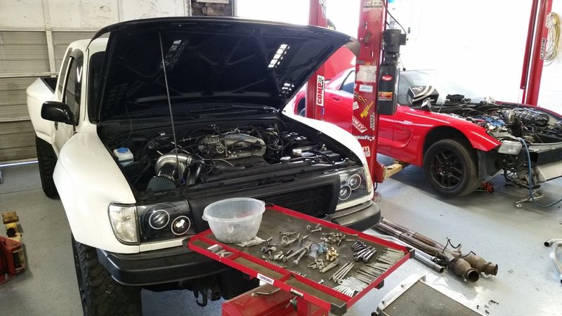

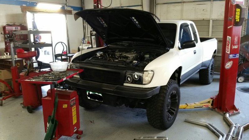

    Checked on my truck yesterday. Everything is going well and installed minus the broken vband I was supposed to order and the broken turbo mount being welded. Hit up Amazon, 2.5 inch clamp x 2 (just in case) sent next day delivery.

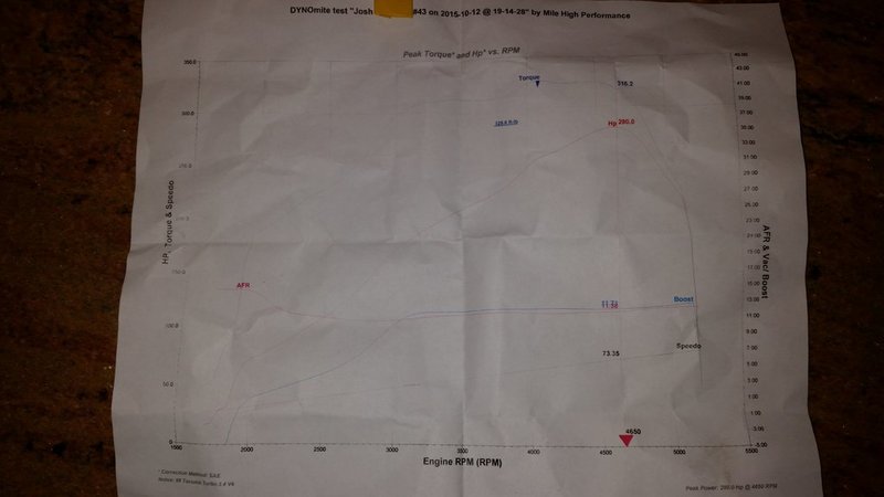

    Ok, here are the numbers......not quite what I was expecting.....the tuner said you get lower numbers here in CO because we are 1 mile above sea level. Also he said it's a "mustang" dyno, not a dyno jet as dyno's can read differently. Said a dynojet would have read higher. On 32" mud terrains and stock 4.10 gearing it made 280hp and 316ft lbs.
    Need to zoom in.....
    More to follow.

    Wow your turbo spools late. 3k.
    Id want it at around 2200
    Yea if your going up in tire size. Get different gears. So worth it.

    Yeah, thought it starts just at about 2500, but full is 3000. Would like sooner spool too. Eh, I'm still learning, and failing at things too. Such is life. Going to drive it more tomorrow to get a new feel for things. May end up going full stand alone and 700 something injectors.

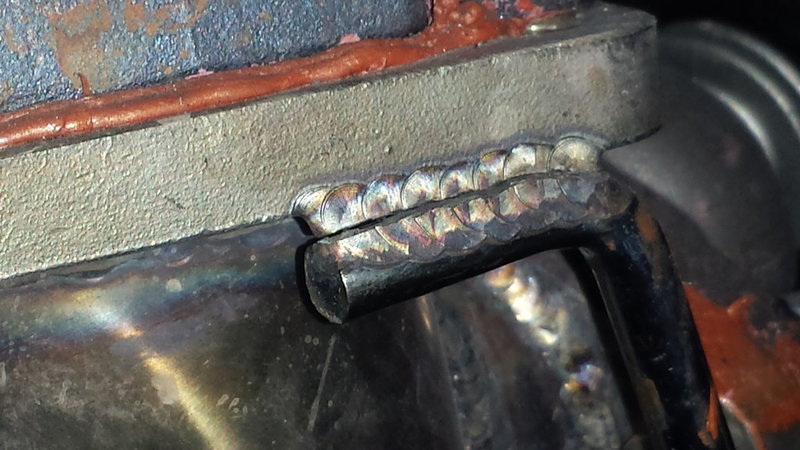

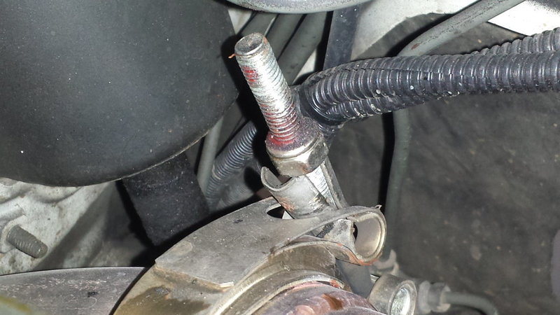

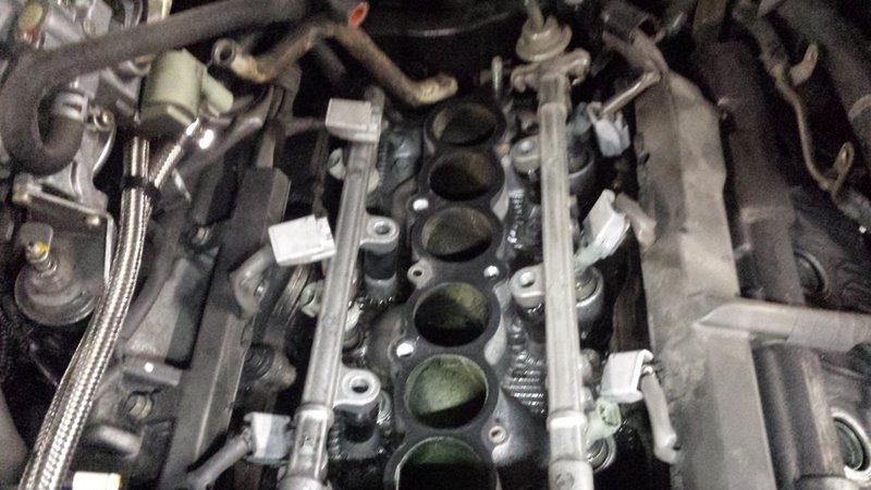

    Broken turbo mount......broken vband, both fixed.
    Valve cover seals being changed.....
    Injectors.....
    Computer.....
    Ready to go....

    What size injectors are you running?

    440's right now. May eventually go to 550-750 if I upgrade to a standalone ecu......

    Do you really need to go that big? I saw the stock are like 240cc and people say they will handle like 4-5 psi, so wouldn't like 380cc be enough for 8 psi?
    And where did you get them from?

    From ebay.....about $200. Remanufactured, cleaned, new seals, etc. Not sure ^^^^, my tuner said I could go up to 720s with a standalone and 15psi. I didn't want too go to big and have a rough idle. These 440 idle fine but do take a little more cranking to start up.
