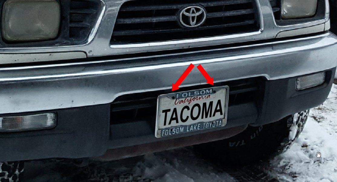

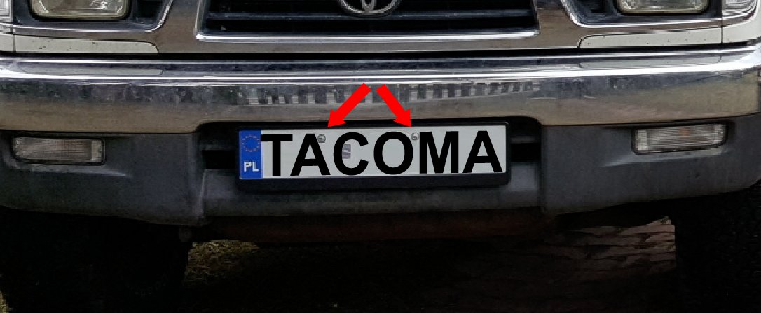

    Probably later years model is better. My 1995 has just two "reinforced" holes to screw the plate (grabbing by the top of the frame). It take metal screws (not even bolts). This is how the license plate was mounted in my Tacoma (arrows point to only screws hoding the plate).
    Because license plates are often stolen here (gas station scam) I have installed my new Polish plate through the same holes but I used stainless steel round bolts. They are still mounted through the plastic holes so they are kind of floppy, but secured from non-brutal force theft.
    But as you can see I would not put anything heavier than few ounces on that screws.
    Taco Addiction likes this.

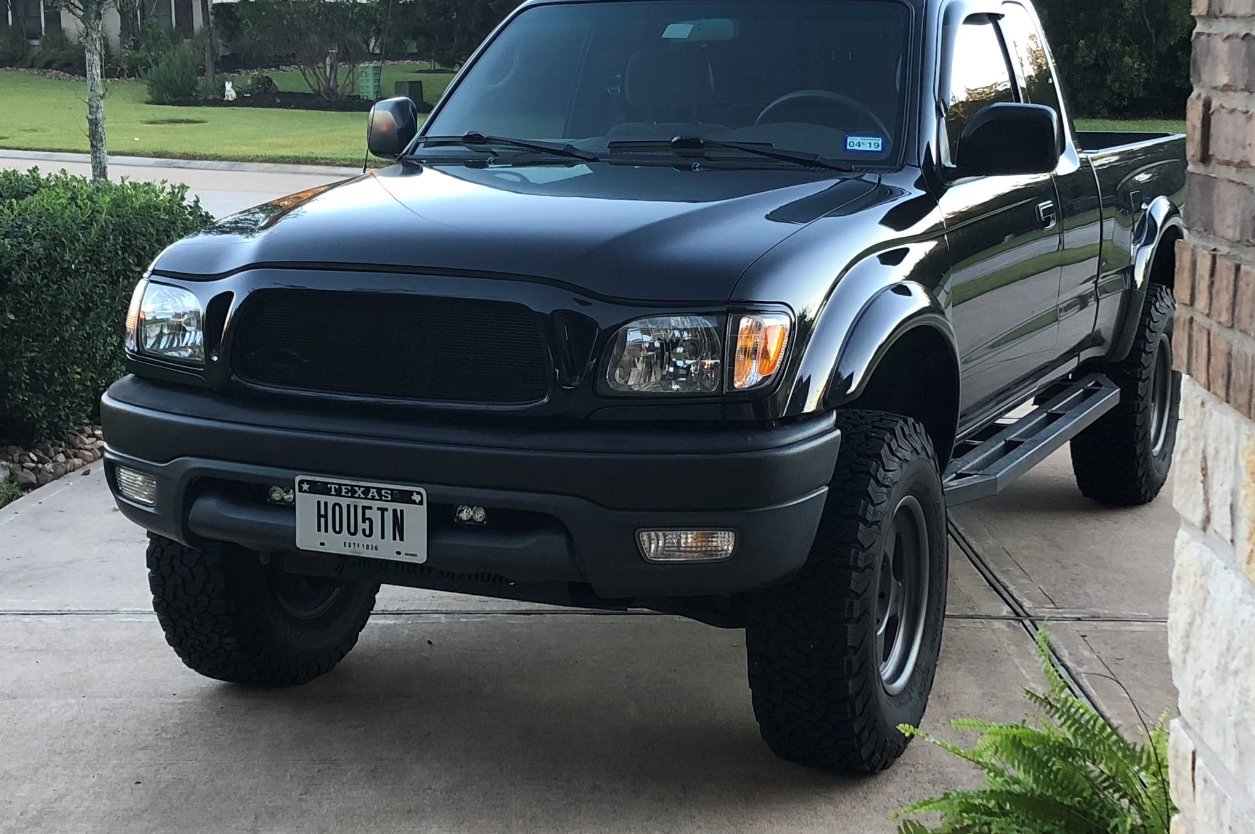

    I installed 2 Baja S2 Pros beside my front plate. Removed bumper, drilled into crash bar, mounted and reinstalled the bumper. With these as small as they are, probably could have mounted these in the bumper plastic itself with no issues. Keeps the sleek Gen 1 front end clean and provides enough light for my applications.
