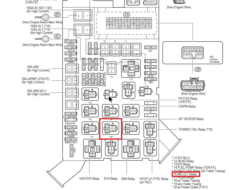

    Had the blinking light, and my compressor is bad. Need to order one for my mechanic. He said to remove the fuse for the ac just in case. Is this the one that is in the engine bay?
  17. Dec 1, 2018 at 7:17 PM
    #77
    Jimmyh
    Jimmyh Well-Known Member
    May 16, 2012
    #78991
    14,363
    SC
    2012 Prerunner SR5
    Just pull the MG Clutch Relay under the hood in the fuse box or unplug the connector at the magnetic clutch.
    The fuse in the engine bay that is labeled as AC SKT is for the 120 volt outlet in the bed, It is also bolted in place.
    The 10 amp AC fuse is for power to the AC Amplifier which controls the servo motors etc...
  18. Dec 1, 2018 at 9:06 PM
    #78
    manhster
    manhster Well-Known Member
    Feb 1, 2017
    #209388
    61
    Richmond, VA
    2011 Grey Tacoma DCSB 4x4
    Confused, so the 10 amp AC fuse won't do what I need? Does the manual show the relay location?
    Thx
  19. Dec 2, 2018 at 7:36 PM
    #79
    Jimmyh
    May 16, 2012
    #78991
    14,363
    SC
    2012 Prerunner SR5
    No that fuse is for the AC Amplifier circuit.
    Here is the relay location under the hood fuse box circled in red:
