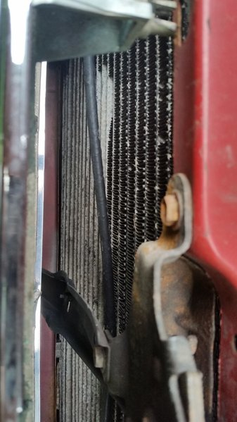

    So this is my condenser. Notice fins missing. Doesnt appear like I have a leak. Blows sort of cold but not ice cold. Compressor working fine. Should replacing make huge improvement?20160505_112653.jpg

    It might, it sure isnt gettin much air through that thing. Pressure washer do that?? Nightprowler is right too, that deal he is talking about has been known to go titts up..
