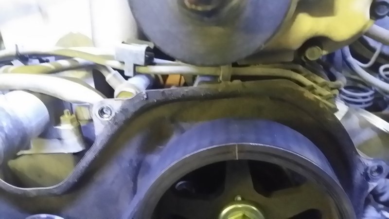

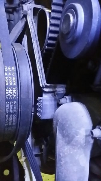

    So back on the random check engine light. I was paying very close attention to the way the truck drives and feels. The mid rpm range felt laggy when rolling on the throttle. I could say if it was a problem, or the nature of this truck. Idle felt like it would stumble on occasion, never enough to show any misfire data. I spent some good time chasing electrical circuits looking for possible issues finding none. I was using a lab scope watching rpm signals form the crank and cam, IGT and IGF signals, odd spots in the TPS, not finding anything. Thinking I must of missed something stupid (remember K.I.S.S) I went back to basics. I remembered I did a bore scope but like a dummy, I didn't compression test, why? I think I was thinking cracked head as I had seen may of those on the 3.4l so I jumped the gun on my tests (also the inside of the engine was stupid clean so i assumed it couldn't be compression loss due to wear). Well a compression test revealed low compression readings on the whole passenger bank.
    Anyone see the issue?
    I didn't think I would need to be in the timing belt this soon. The belt was done by a Toyota Tech about a year before I purchased the truck (he even works at my dealer). It looks like he didn't do cleanup after he repaired a very leaky water pump. The residue worked its way into the tensioner pivot causing it to stick. A sticking timing belt tensioner pivot could cause the belt to jump time, or they f-ed it up to begin with as far as timing goes. Either way, this truck has been very educational for him as the amount of shit I give him for all the fuck ups I find (this truck belonged to one of his "loyal customers"). I could go on a bigger rant about some techs but will stop here with one last thing to say. This isn't a career path for your typical high school failure like it used to be. Administrators, stop sending the dummies to automotive class as a career option, if they can't computer, they can't car.
    So I cleaned it up and installed the belt in time. Couple drives now and it feels a lot better. The stumble is gone (other then now I can feel the a/c compressor is causing a vibration) and the engine power band is a lot smoother. No more mid rpm roll-on bog. It feels like most other Tacoma trucks now.
