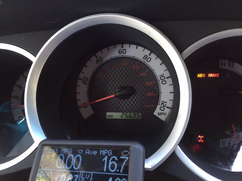

    I found a nice switch that fits the center switch area on the 2012-2015 Tacos. The switch has two illuminated areas: Green when ABS is disabled and 'ABS OFF' message when your lights are turned on. The switch can be found at http://www.aironboard.com/online/catalogsearch/result/?q=AOBSW9B83GR
    I spent part of the last few days installing the switch in my 2014 TRD OR Access Cab. Unfortunately, in addition to the two wires needed for the mod (Ground and Pin 4 of 1B1 Tap), two additional wires are needed: ILL+ (green) for the illumination and ACC+ for the power for the ABS Circuit. In addition to the 4 wires, either a relay or an electronic switch needs to be added to the circuit in order to 1) allow the switch to be lighted and 2) deactivate the ABS.
    I did a couple of things differently. First, I got the ground from the center console after removing it and the center storage box. This allowed me to route ACC+ to my inverter mod so that I could replace the battery with normal power (http://www.tacomaworld.com/forum/2nd-gen-tacomas/226311-inverter-questions-3.html#post9574127).
    If there is any interest, I can provide schematics for the lighted ABS OFF switch.
    The mod works very well, but differently than it did when installed on my 2005 TRD OR Access Cab: The mod on my 2005 only worked while in 4WD, but the mod works anytime on my 2014. The following lights go on when the button is pressed: TRAC, VSC, ABS and 4WDLo.
    The installation was a little tricky because I could not figure out how to remove the lower panel where the switches were located. I was unable to pry the blank plates out, so I had to drill a small hole in each and then screw a self-tapping screw part way into the hole. With this arrangement, I was able to pop the blanks out. Does anyone know a better way to do this?
    A few pictures follow. Unfortunately, some are a little blurry. You can see that I have not put the ABS OFF switch completely in yet because I don't know how I will get it out if I need to make changes. Also, you will see a USB Power Jack, partially installed in the right-most switch location.

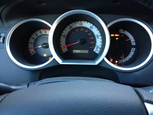

    This switch would be great if we needed to switch a positive load but unfortunately that's not the case here. This switch has the positive of the on/off LED tied to the normally open portion of the switch and has to be powered to use that LED. Otherwise it is still just a set of contacts, and rather then go through the bother of switching an external relay to switch a ground, I elected to forgo the lighted on/off button and simply use it to switch the ground for the mod. I performed this today on my 2013. Interesting to note that the dash lights cycle on and off with the new switch, thought I read here the truck key needed to be cycled to turn the ABS, TRAC, etc. lights back off.
    Thanks OP for such an important Mod!
    Crom[OP] likes this.
  19. Apr 25, 2015 at 5:03 PM
    #379
    Space Junk
    Space Junk Flight Ready
    Jul 29, 2012
    #83705
    87
    Silicon Valley
    2013 Tacoma access Cab TRD Off Road
    So I tried to edit my last post to include another picture that I took of my project but was unable to past it there. Note the drivetrain graphic with an X over the rear diff....
