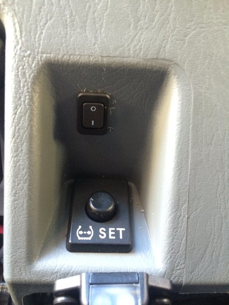

    Kind like the location and discreet look to this switch. Can be used for this mod too, correct?

    thats where mine is! :)

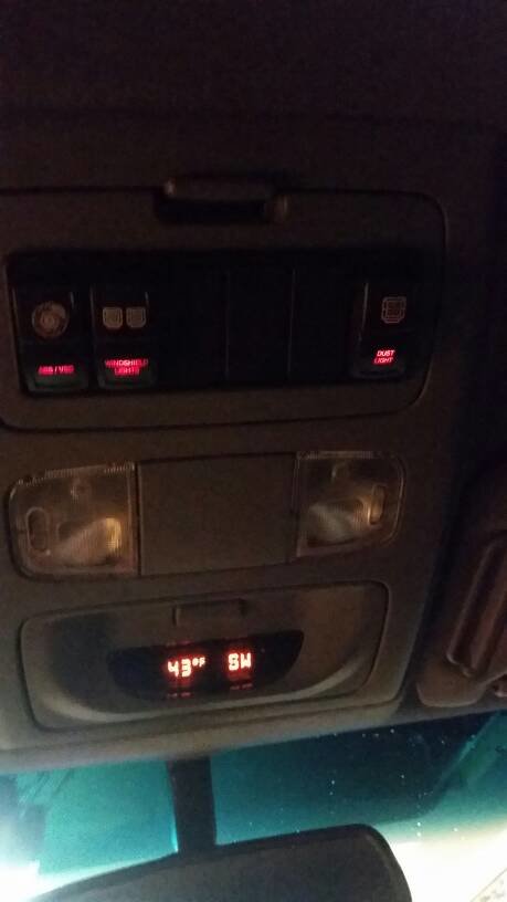

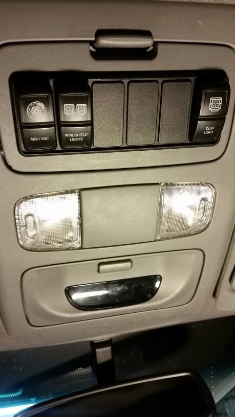

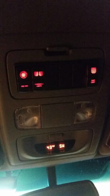

    That diagram was the missing link, and you sir are my hero. Got it all wired up and all three switches work like a charm!
    Without keys in the ignition:
    With keys in:
    And with all three switches on (ABS killed):

    Yes. I have that switch in my truck for another mod and it works great! It will work for this too!
