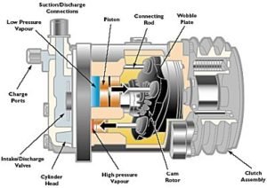

    The compressor can still pump fine but something in the wobble plate that moves the pistons is going bad.
